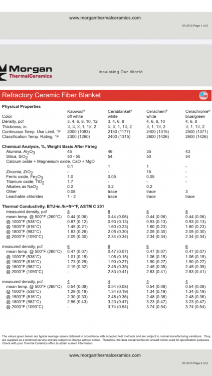

A 50lb. sack of Vesuvious is enough to make half a dozen forges like yours. You should be able to sell small quantities to other smiths wanting to build a gasser after seeing how well yours works. One 1 sack! You only want about 3/8" on most of the liner and up to 1/2" on the floor, figure Maybe 10 lbs max.
It isn't as good an insulator as KOL but it's what you have available, if you don't lay it in too thick it won't be too much of a heat sink. It'll work just fine.
Thanks Frosty. So maybe 1 bag of vesuvius and the kaowool then. That would also give me lots of patches and maybe even build another forge!
One other thing, I read about pizza oven guys using stainless needles for structure in the refractory. Much like rebar in concrete. But I havent seen anything about it in forge builds..?? Is it not a concern in forges? The roof wont collapse?
Ok I have made many phone calls today... my only option for non bulk 8# 2600° wool is in 2” thickness. I will have to just go with that instead of 2 layers of 1” I suppose. I was just about to pull the trigger on the moldit X cement when they said, oh we also have vesuvius super 3000! Its a pre mixed mortar rated to 3000. 5 gallons is $106, 1 gal is $57. I did some looking and it seems to be the go to for many Canadian bladesmiths. I have until tomorrow morning to decide. Have you guys heard of the super 3000? Could coat a lot of forges with 5 gallons!
One thing to note is the super 3000 is a refractory mortar, whereas the moldit X is a refractory cement. My understanding is that the mortar is more of a crack sealer/brick repair and the cement is meant to be thicker like a forge lining. But a lot of the Canadian bladesmiths seem to use the super 3000. Some say it bubbles, some dont. But I can find almost nothing on the moldit X... not sure which way to go here.
