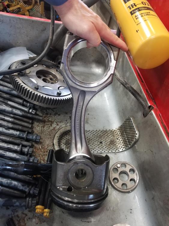

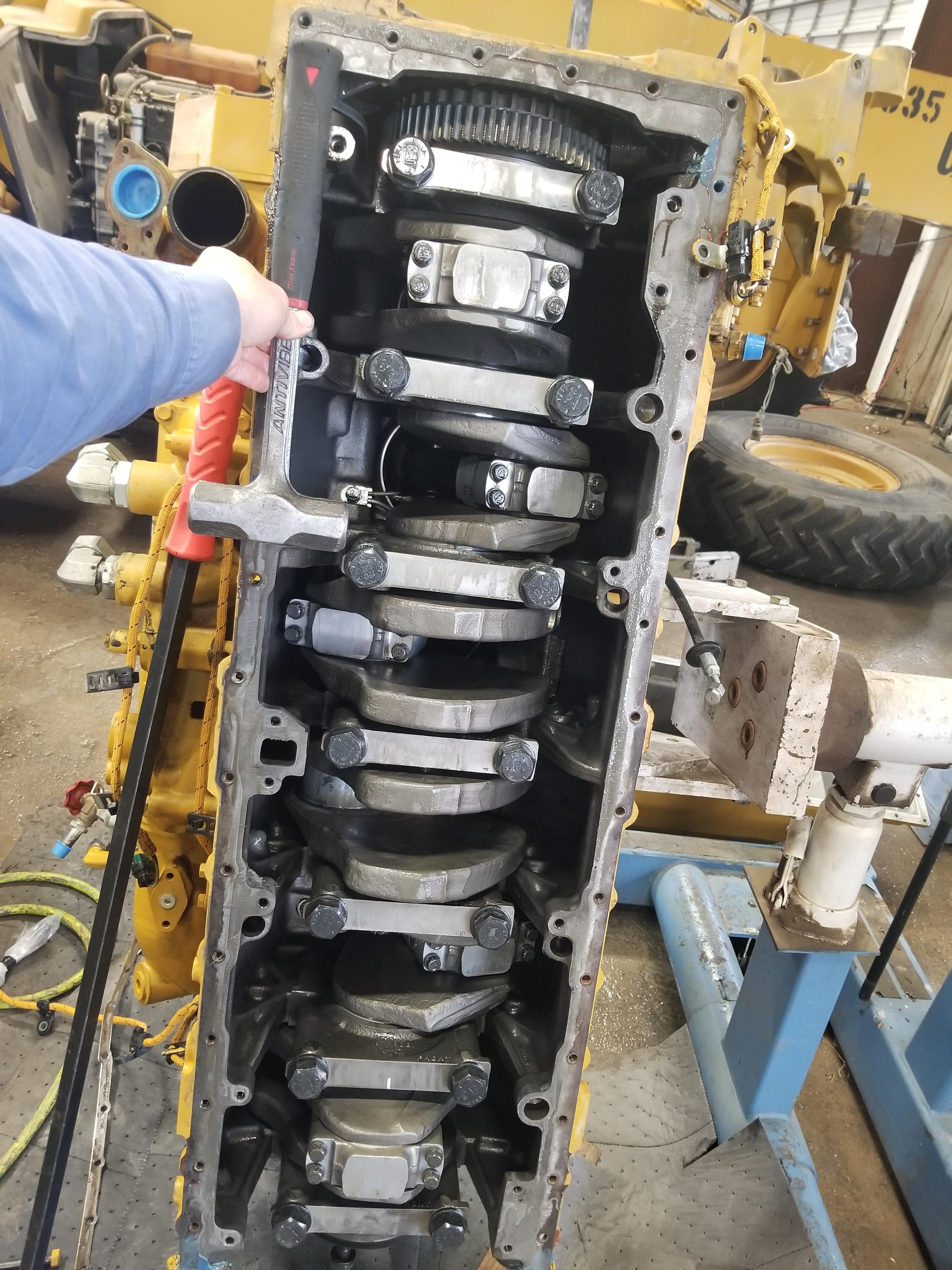

Just thought folks might appreciate this.
~5000lb 18L diesel, hydrolocked and bent a rod, as well as the crank.
The rods and crank are forged. The crank is 47" long, and the main journals are just over 4.75" diameter. High quality steel, forged well, heat treated and shot-peened.
Talk about some force to distort those pieces cold. Well, ~200°F operating oil temp anyway.

Certainly. The engine is mated to a 3 speed planetary gearset, as well as 5 hydraulic pumps. While I couldn't nail down an accurate rotating inertia energy, I can tell you it is SUBSTANTIAL. Even at low idle, you are looking at 700RPM, and we are talking over a quarter ton of rotating components.

Looked it up, the crank is 495lbs. So between it and all the rotating assembly in the powertrain, it is probably closer to 1/2-3/4 ton of rotating mass, in neutral and parked.

Back to running shape. Big ugly stinky beasty.
