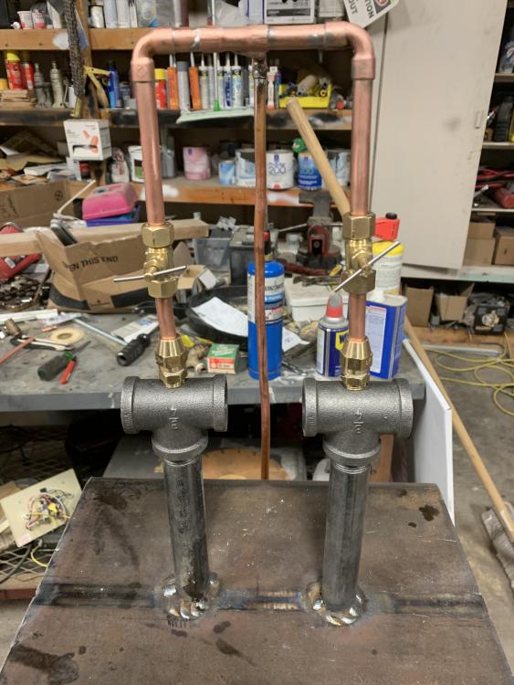

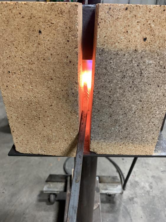

Blocksmith Posted January 12, 2020 Share Posted January 12, 2020 Having trouble getting welding heat and also difficult to light until it warms up. Let me know I’m doing wrong. 30-60 psi of propane. Thanks guys. Quote Link to comment Share on other sites More sharing options...
Chris C Posted January 12, 2020 Share Posted January 12, 2020 Well, I'm certainly no expert...............they'll all jump in after I post! But the first thing I notice is you've used hard refractory bricks. About all they'll do is soak up all your heat. I'd change all those out for the soft insulating bricks. Quote Link to comment Share on other sites More sharing options...
Irondragon Forge ClayWorks Posted January 12, 2020 Share Posted January 12, 2020 Welcome aboard, have you read this yet? READ THIS FIRST it will help you get the best out of the forum with tips like editing your profile to show your location, how to do an effective search and keep off the moderators radar. 30-60 psi seems very high to me, I don't see a regulator or gauge in the system so how do you determine the pressure? The bricks are a heat sink and take a long time to come up to temperature without insulation. Have you read any of forges 101? Quote Link to comment Share on other sites More sharing options...
MCalvert Posted January 12, 2020 Share Posted January 12, 2020 Everything they said! Seriously though soft bricks and a coat of Matrikote 90 or Plistix and you will be so much better off Quote Link to comment Share on other sites More sharing options...

G-son Posted January 12, 2020 Share Posted January 12, 2020 Those T:s on the burners seem to have the same size openings all around, if I remember correctly the recommendation is to have the two inlets one size larger than the mixing tube. Also, with the burners close together and two T openings turned towards each other they may affect air flow into the other burner. I'd turn them something like 90 degrees - don't know if it'll make a difference, but it's generally a good idea to keep it clear around most kinds of air inlets if you want good flow. Quote Link to comment Share on other sites More sharing options...

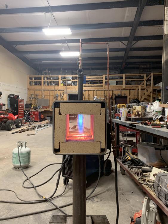

Blocksmith Posted January 16, 2020 Author Share Posted January 16, 2020 Okay k26 brick installed and in the process of refractory order. Next question. How deep does the tip of the flare need to penetrate the forge? Right now I have it set flush with the inside face of the liner...as mentioned before lots of trouble getting it to light. After it warms up for 5-10 minutes it’s easier to light. Thoughts? Quote Link to comment Share on other sites More sharing options...
Mikey98118 Posted January 16, 2020 Share Posted January 16, 2020 The flame retention nozzle (were the flame comes out) should be recessed back up within the brick about 1"; to help beep it from overheating. K26 brick has many strengths and one glaring weakness; it is spongy. That is to say K26 brick has surfaces wide open to flame; not good. You would be well served to coat the surfaces that are exposed to the forge's internal atmosphere to either Plistix or some other refractory coating. Quote Link to comment Share on other sites More sharing options...

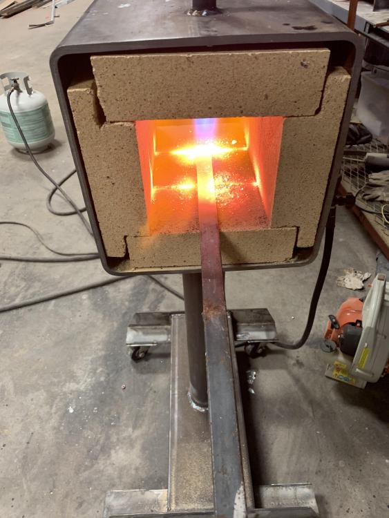

Blocksmith Posted January 17, 2020 Author Share Posted January 17, 2020 Getting a lot better. Swapped mig tips to .035 and was able to have a nice working temp at 8 psi. Lights up easy now. Work in progress. thanks for the help Quote Link to comment Share on other sites More sharing options...
