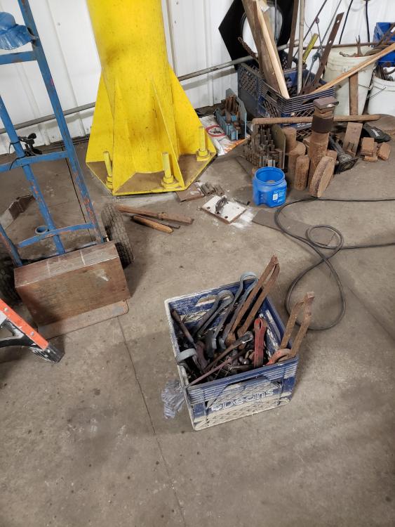

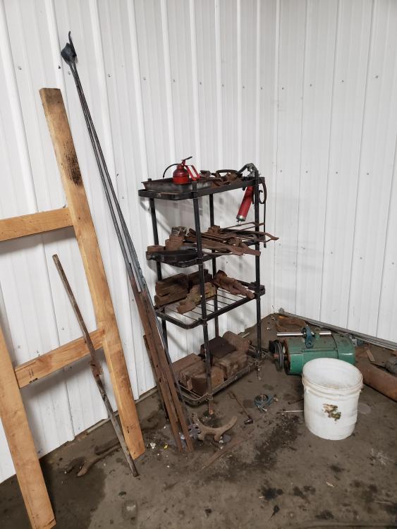

I have been fighting to get some order in the new shop and the power hammer tools have been hard to keep track of. In the old shop I had about 200 nails driven into the wall that they hung from. Here that isn't an option. I have two shelves, two tables, an as yet unused coal forge, and various buckets and milk crates. It can be difficult to find what I am looking for when I need it. Picking up today I found about 30 hacks!  I do have a habit of just making more, which doesnt help much with the clutter

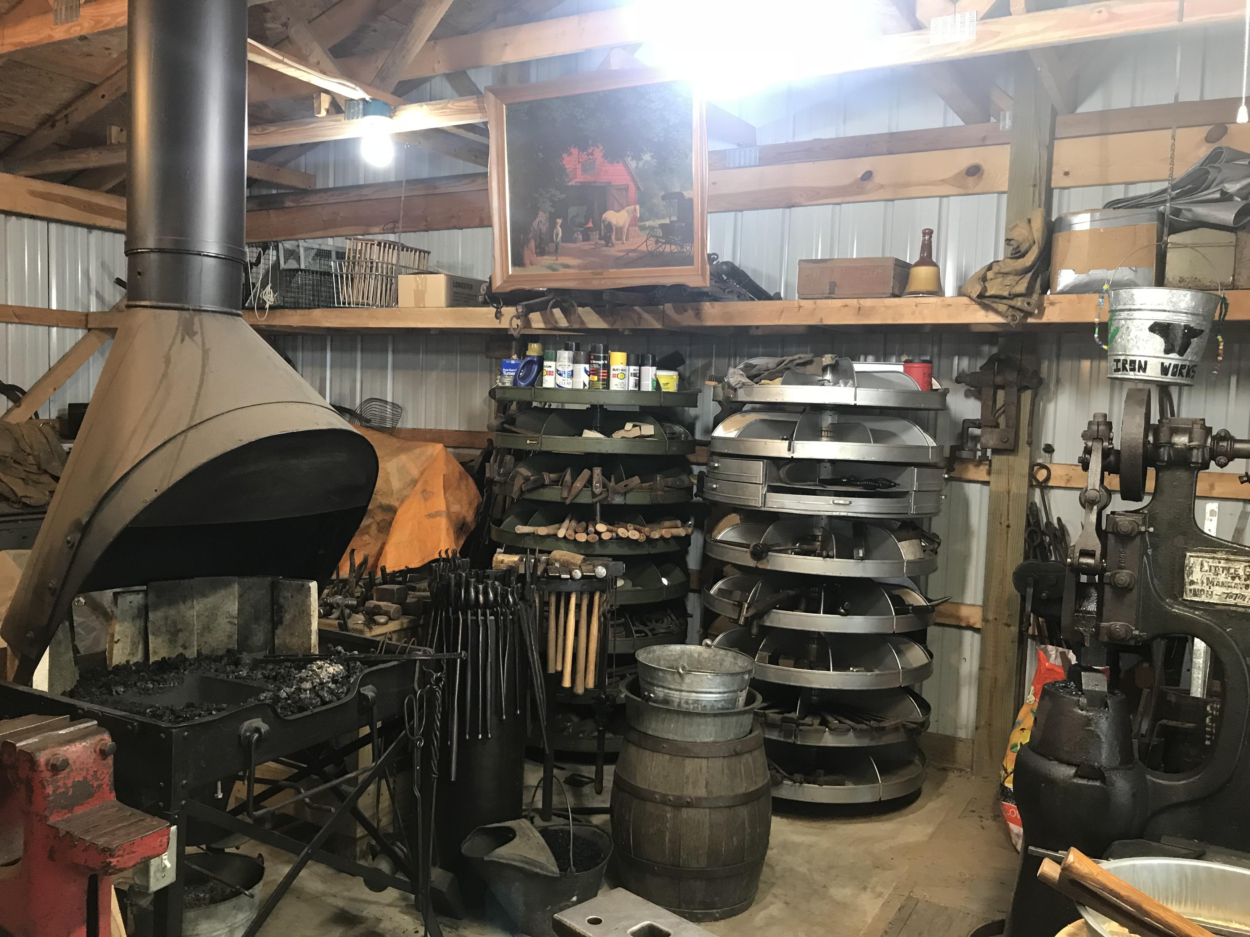

Photos are of the tong and tool "organization" I use.  The tong rack is 20" X 20" X 24" high, mounted on wheels from a defunct 2-ton shop jack.  The top ring is 2" channel, with 1/4" hooks every 1.5" - the 5 tong racks are 1/4" X 1.5" flat bar, welded into the channel, 3.5" apart.  The bench shelves hold punches and chisels on 1" and 1.25" screen deck from a local crushed stone operation (when screen decks get a hole worn thru, usually in the center of the screen section, they are scrapped and can usually be acquired at minimum or no cost by asking at the plant office).  Screen deck shelves are great because they let the dirt and scale sift thru.
The P/H punches are made from shock absorber shaft, the ball punches are various-size bearings, welded to some 1/4 X 1 flat bar.
Jason, you may recognize some of your bolt-jaw tongs and tools.  Any questions, just ask.
