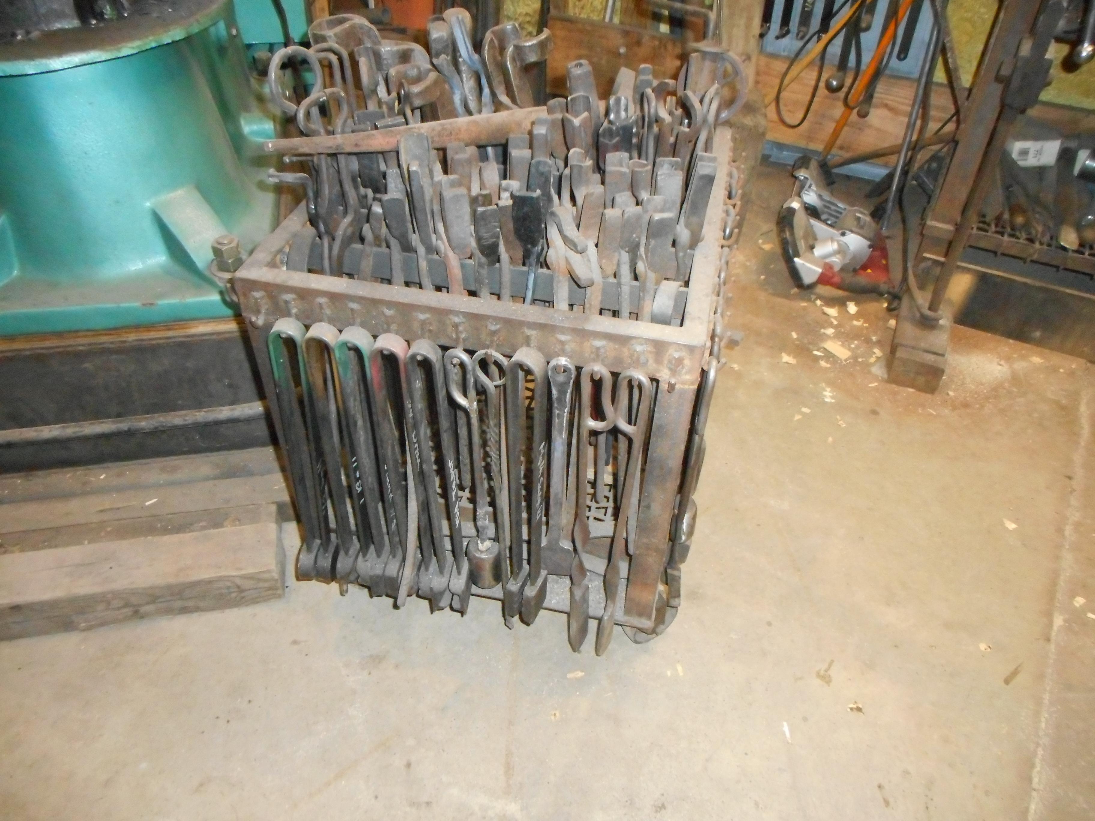

  18. Photos are of the tong and tool "organization" I use. The tong rack is 20" X 20" X 24" high, mounted on wheels from a defunct 2-ton shop jack. The top ring is 2" channel, with 1/4" hooks every 1.5" - the 5 tong racks are 1/4" X 1.5" flat bar, welded into the channel, 3.5" apart. The bench shelves hold punches and chisels on 1" and 1.25" screen deck from a local crushed stone operation (when screen decks get a hole worn thru, usually in the center of the screen section, they are scrapped and can usually be acquired at minimum or no cost by asking at the plant office). Screen deck shelves are great because they let the dirt and scale sift thru. The P/H punches are made from shock absorber shaft, the ball punches are various-size bearings, welded to some 1/4 X 1 flat bar. Jason, you may recognize some of your bolt-jaw tongs and tools. Any questions, just ask.
