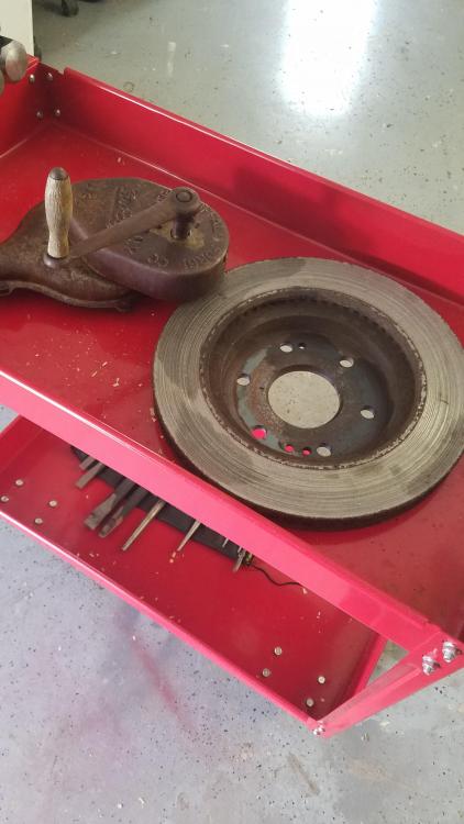

Hello IFI, I've been passing through this forum for quite some time and as I just fired my first home built forge I though it time to join.
Here's the build out list: Brake Disc, 16x30 metal cart, Buffalo blower, 2 inch piping for tuyere, clay, fire brick, and regular brick. sheet metal.
I clayed the entire cart around the disc under the bricks, this leveled things out for the brick mostly, but also added a nice added layer of thermal protection to the cheap cart metal.  Fire brick is cut around the disc face, giving me a pot 3.5 inches deep and 7 inches wide.  Picked up the blower for a steal on auction, ugly on the outside but beautiful on the inside, once I cleaned it out and re-lubed it turns like brand new.  Currently I've got a 2x4 and metal straps holding it rigid with the piping but plan to swap that for some metal brackets in the future, it was just all I had laying around at the time. Lastly I added the simple metal surround for wind protection plus the added benefit of being able to pile extra fuel up that back wall in the corners.
Fired for the first time Sunday with some nice lump charcoal, wally world was having a sale so why not...  As it was over 100 degrees out I mostly just beat up some rebar I had laying around before shutting things down, test firing was a huge success.  I noticed a few odd hot spots underneath the cart and decided to clay in the interior of the pot as well which I should have done it to begin with anyways, but that should take care of my errant heat.  We'll see in a few days when I have time to light it up again.
Outside of heating things up with a torch and beating them until they submit to my will around the homestead I've only ever worked steel on a lathe and that was a few (read 20) years ago.  I've done some forging of specialty tools made out of soft metals like copper and bronze in the distant past as well but never what I would call blacksmithing of anything.  I've been wanting to get into this side of things for quite awhile so I'm excited about this forge build and can't wait to see how ugly my first projects turn out.  Ha ha.  Attaching some pics for your pleasure or verbal destruction, whichever your bent.

Welcome aboard, glad to have you. Pretty nice job on the forge but I think the way you've arranged the fire brick around the rotor over deepens your fire pot. You'll also want a way clear path to pass long stock across the fire so you can heat the center of long pieces. Imagine wanting to bend a 6' hairpin.
All in all I think it's well thought out and made, good job.
Thanks Frosty.  I remeasured and after claying the pot I’m sitting right at 3 inches deep now.  It was a hard decision on how deep to aim for.  I looked at the dimensions of the Vulcan pots to get an idea for the depth, theirs are 4” deep for the square coal forge and 3” deep for the round coke forge.  After that I hit up the ol’ internet for searches and found pot depth recommendations from 0” all the way to 6”.  I’m a beekeeper and if you ask 10 beekeepers the same question you’ll get at least 15 answers.  Blacksmithing seems to be on par with that adage.
As for the wind break I agree 100% that it’s going to need trimmed back 4-6 inches on each side.  Luckily it’s just held in place with the clay and bricks.  I wanted to make sure I was happy with it before I bolted it in so I should be able to just slide it out.

You could make a flap, of sorts.  Keep it closed when you work on short stuff, and open to pass longer items through.  something only 2 or 3 inches across would be ideal.
Also, I had a similar idea for that cart.  HF purchase?
Thanks pnut.  Good advice on the hammers, it's now on my to do list for the weekend.  I was just over to the hammer section and there are a couple of good posts on dressing hammers.  To relate it back to the forge topic, the handle on the cart seems to be a great place to hang the hammers.  But I did notice some decent heat making it's way to that end, 200-300 degrees at the hammer faces towards the fire according to my laser thermo.  Do you think there is any risk to the hardness by leaving the hammers here, especially over a full day of exposure?
I don't think that 300 will affect them.  But it wouldn't hurt to check up on temps if you get it running several hours, especially if you're pushing a lot of air into the fire.  It wouldn't hurt to stach a wall of bricks in front of the hammers, if you want.
MrT, It was indeed HF.  I had a few goals in mind when I started this build and economics was certainly one of them.  With the explicit intention of cutting a big hole in the middle of a brand new cart HF proved to be the best option.  If the whole thing falls apart I'm out a whole $30, everything else can be salvaged and put into a different platform.  Ultimately, if this proof of concept works and I decide to continue blacksmithing I'll be building a full brick forge off my barn, or maybe in my barn, it'll just depend on a couple of other shop item placements first.

Remember when you put your stock in the fire you want it to be Horizontal and not at a steep angle. So the hot spot in the forge should support that.
300 degF won't mess the temper up but will mess up the handles. However in my various coal forges I can grab stuff with my bare hand that is sitting at that distance from the fire pot. Is this a function of your reflector oven?
That's an interesting theory Thomas.  I'm planning to trim the wind break anyways to accommodate longer stock so I may as well fire the forge up with it out and see if there there is less heat at the handle end.  If it is in fact reflected heat I was getting I'll probably try a high temp paint on the inside of the wind break to see if that cuts the reflective nature of the bare metal.  I also like MrT's suggestion of a simple line of bricks standing up blocking the heat.
A shade to block the IR from the hammer heads is as easy as piling your ready coal in front of them. You don't really want a lot of exposed fire, I like to keep it buried under coal that's coking up. It keeps more heat IN the fire where I want it to heat my steel.
Update on the forge.  Claying the pot helped eliminate the hot spot issues underneath.  I trimmed back the wind break to just past the center line of the pot on each side so I can lay material straight across the cart, which I ended up doing today while drawing out the first half of a set of tongs.  The wind block is still large enough I can stand slightly off to the side while cranking the blower and get no radiated heat towards me which is nice.  I also hit the wind break with a dusting of flat black paint to cut down the reflectivity.  It’s not high temp stuff and probably won’t last more than a few days of forging but it was on hand.  I doubled down and took Mr.T’s suggestion and stood a brick on edge in front of the hammers.  Between the paint and the extra brick, the handle end of the cart is remaining cool, as cool as South Georgia is in the summer at least.  Lastly I dressed up the faces of my hammers.

Forge update: Smaller fire seems to be working better.  With the charcoal pile only slightly above the the rim the material can lay flat.  My first pair of tongs are complete, ugly, but complete.  They’re asymmetrical, covered in cold shuts, and I can see at least 2 crack, but by god I made them myself with fire and a hammer.  My significant other immediately gave me a nice compliment on them......then asked if it would have been better to just buy a pair.  I took the compliment and then told her it was more of an an educational experience making it much more valuable then bought pair.  She then returned to the house.  Ah well.
Anyways, back to the forge.  By keeping the fire fairly small I have to feed it a handful of charcoal every 3 or 4 heats.  I have zero idea if my fuel consumption is good, bad, or normal for lump charcoal.  Any opinions out there?
When I had to heat the middle area of the rod the heat shield prevented proper placement.  I had to go across the cart which is why I trimmed the shield back in the first place.  But I found the raised edges of the cart holds the material just a little higher and with a smaller fire I had to throw a couple more handful of fuel on to move the heat up.  I’ve considered either trimming or hammering the sides of the cart down to level with the brick but I worry about weakening the rolled edge’s purpose.
Very happy with the forge’s performance as well as my own.  Fire+hammer+steel=tongs, that’s so cool, sorry, no matter how ugly they are, they’re still the first thing I’ve blacksmithed in steal.  The largest material has been 1/2 inch which it heats with no problem.  Next test for the forge will be a 1 inch round bar to see how it handles slightly larger stock.
Use an angle grinder or big tin snips to cut a V shaped notch on the front and back edge and cut a little hole In the bottom of the wind break for a pass through

Forge update:
Cart is holding up well, handle works amazing for a hammer and tong holder.
Blower is amazing, I feed it a few drops of oil after a day of use.
Clay lining is shot xx xxxx.  I haven't been at it every single weekend but I'd guess 10-12 of the past 14 I've been out there.  If a handful of clay once a quarter is the only upkeep it needs I think it's doing pretty good but what do I know.
It does pretty good, performance wise, at least for what I've been heating.  So far just beating some hooks to shape and made an anvil hold down out of 3/4 rod. No issues with 3/4 getting to temp.  I haven't forge welded anything yet, but that may be on the agenda for next weekend.
