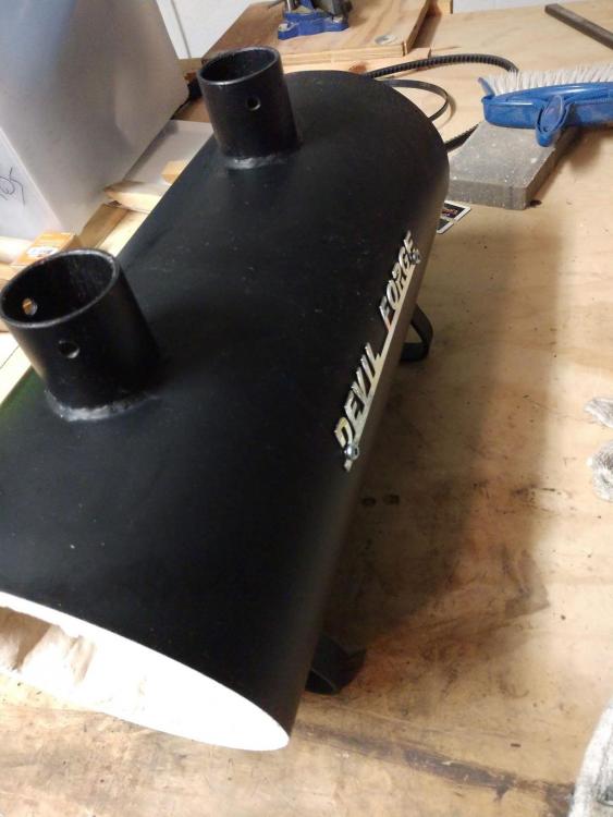

Got my Devil Forge 2 burner in 20 days early
louspinuso
So as I mentioned in my introduction, I purchased a Devil Forge DFSW2 forge.  I've seen mixed reviews about them online, however, I've also had the opportunity to use one that I borrowed and it seems to work really well (to a newb like me).  This, along with the fear of building a burner poorly, led me to find one on Ebay for $179 shipped.
A lot of what people were complaining about in the older versions of this forge was that the regulator is for European propane tanks and that the wool needs to be encapsulated.  Well, the forge now comes with the EU -> US propane adapter and 250 grams of rigidizer that you have to mix (10:7) with water and paint on to the ceramic wool.  The only thing I'm not clear on is if it's still required to have yet another coating over the rigidizer (I've heard mixed answers).
Anyway, I figured I'd do an unboxing video of the forge to show what comes in the box and how it's packaged.  I'll probably do a video when I have some time (probably this weekend) to paint on the rigidizer.  Sorry for the quality, my camcorder was set to the wrong setting.
Let me know what you think.

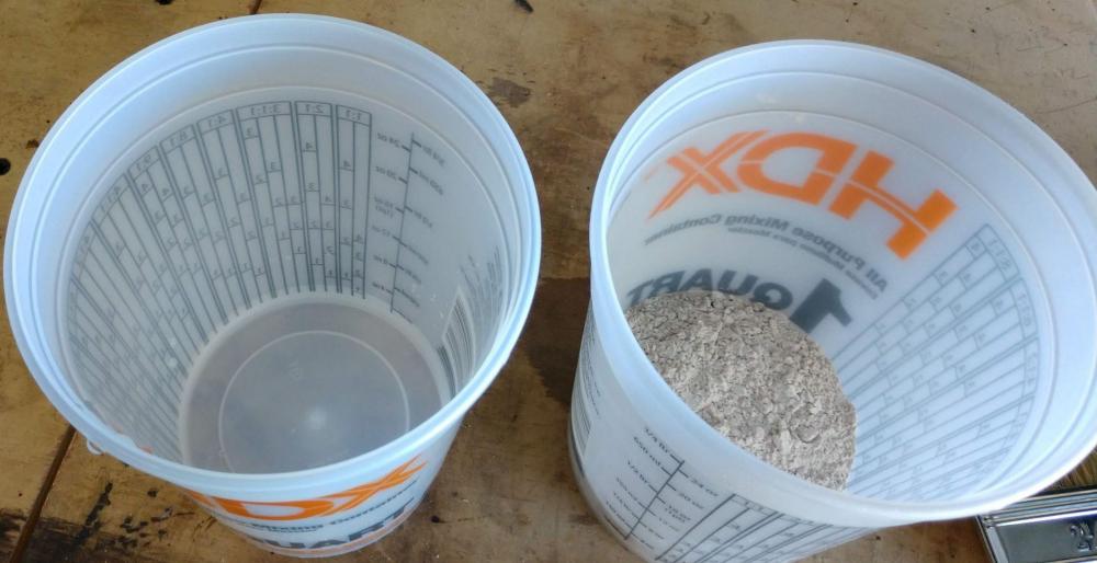

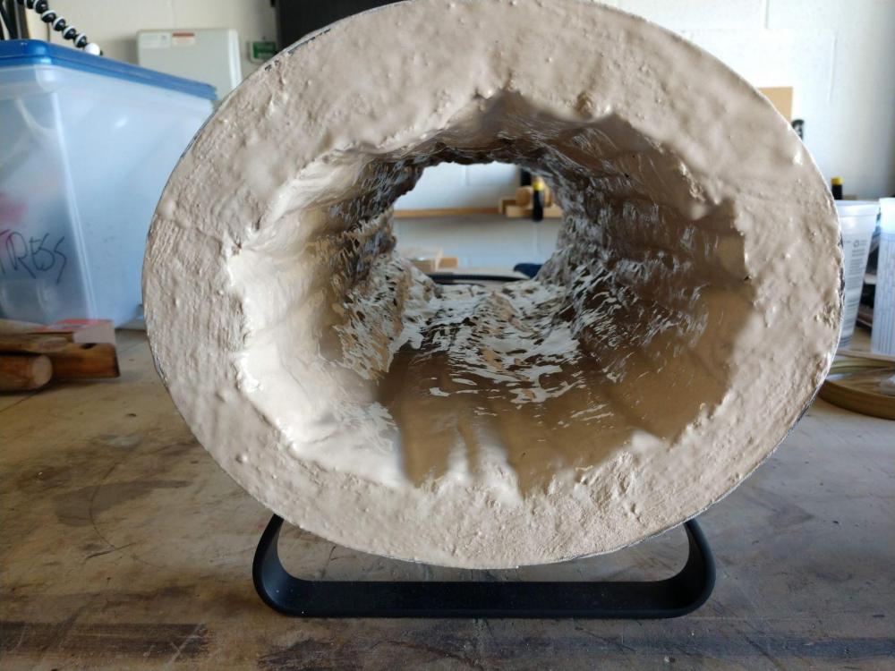

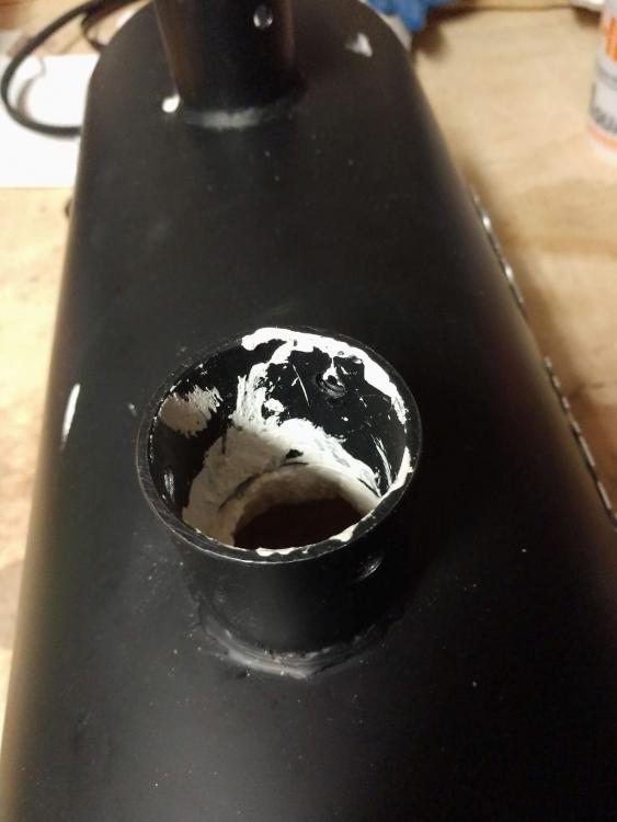

Ok, so after a long day out at a kids birthday party and visiting with a relative that is down from NY, I was finally able to get home and... wait for the baby to fall asleep (my office is right next to his and if he hears me in here before he passes out, he doesn't).  Anyway, now that he's sleeping (and I've replied with what I've found about the Greenpatch 421), I figured I'd post the photos I took today.  I still haven't finished processing the video so that's not ready.  I need to re-narrate it as talking with a respirator on is not recommended.
Anyway, let's get started.  I've resized the images here to prevent it from being bandwidth heavy.  Please let me know if they are still too large.  I started by measuring the rigidizer that was sent to me to confirm it is, indeed, 250 gr.  once I did that I decided that I'd mix it at the recommended ratio in small batches of 100gr rigidizer to 70gr w ater.  I placed 100gr rigidizer in one container (measured on a scale) and 70gr water in a second container.  Once I had the right amounts I poured the water into the powder and mixed.  I didn't capture an image of this, however, I stirred for about 7 minutes and the consistency was about that of medium thick gravy.

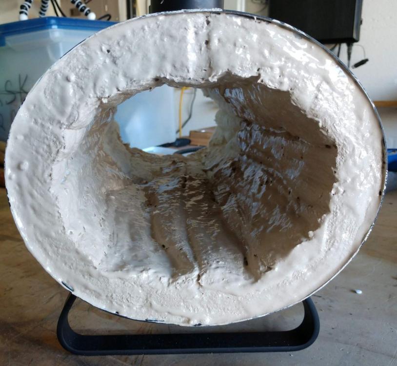

I then painted the inside of the forge, top and bottom, in one half (front? is there a front?)in a nice thick layer.  I then applied rigidizer on the edges of the wool in the burner port.  This pretty much used up the mixture so I measured out another 100gr/70gr mixture and mixed same as before.  This time I turned the forge around and did the other half and the other burner port the same exact way.  Any remaining mixture I went through and found places where air pockets had formed and were showing dry wool  I applied to those and made sure everything was looking good.  This was about 12:45pm this afternoon.
At 8:41pm, this evening, you could already see the edges drying up.
You could also see the mess I left on the outside of the forge body and the burner ports.

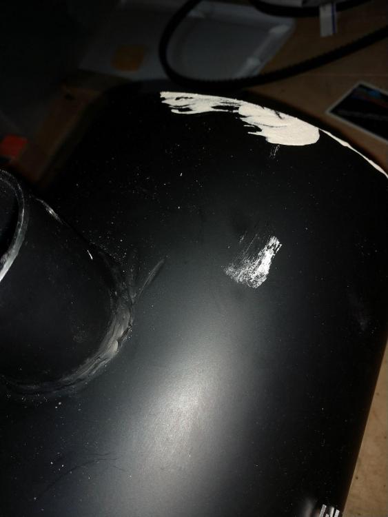

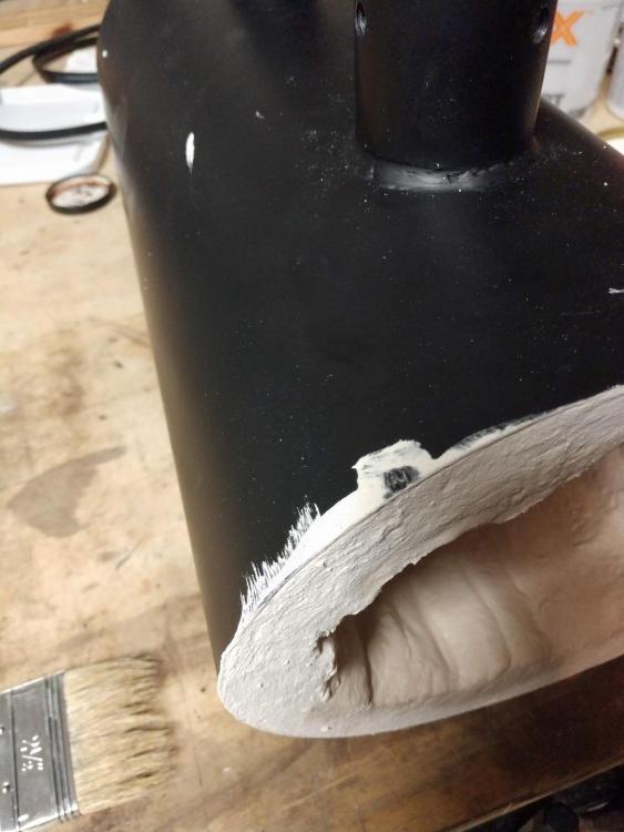

Luckily, this stuff cleans up with water so I took a wet rag and wiped everything on the outside gently and washed away the rigidizer, leaving a clean looking body.

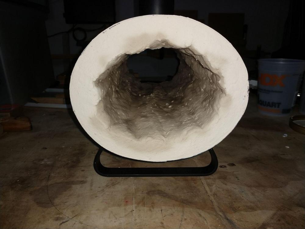

That's it for now, about as far as I'm able to get tonight.  I'll take progress pictures of the drying/curing process tomorrow morning and again tomorrow afternoon in the hopes that you can see how it's holding up.
2 hours ago, louspinuso said:
Wait for rigidizer to dry completely
NO!!!
(1) Use your burner to force dry the ceramic fiber insulation, or let it dry naturally; your choice.
(2) Fire the ceramic fiber insulation in the forge to insure that its fibers lock in place.
(3) Then continue with your list...

Are you sure Mike? This isn't fumed silica, it looks like a thin water set refractory. I've never seen the stuff.
I'm speaking about silica based rigidizer; there are one or two alumina  based rigidizers; is that what you have?
Okay, I want back and read the caption on the two photos; I had assumed it was the Green patch you were showing. If it is what they sent as rgidizer, it is completely unfamiliar. It looks like some kind of refractory. Did it seem to soak into the fiber much?
