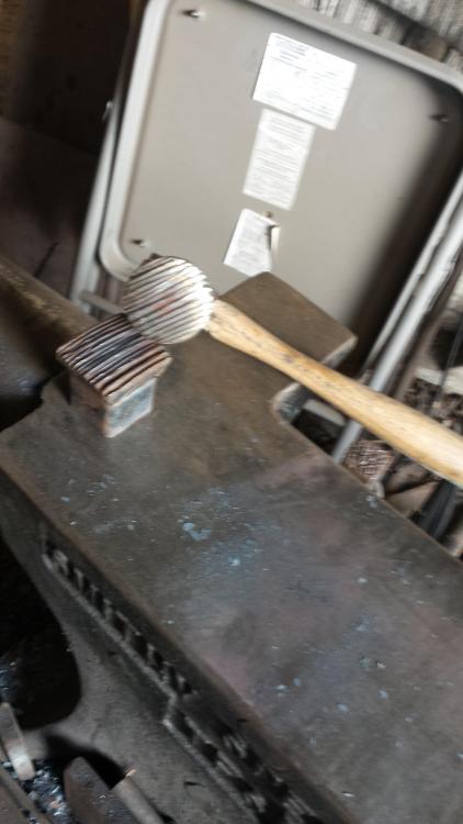

beammeupscotty Posted November 19, 2018 Share Posted November 19, 2018 I don't know about a petrified wood texture, but to get a "viney"-"barky" texture, the two methods shown here already will certainly do the latter job. I opted to not use the spring fuller approach and instead modified a hammer as has been suggested. You also need to make a matching bottom swage. This is what I use: Note that the lines cut into the face of the hammer are at a 45 degree angle compared to the axis of the hammer. This is to allow you to make parallel texture grooves while holding the hammer out of line with the stock. I like hammer application because you can more easily introduce some randomness to the texture, making it more natural looking than if you use a spring swage. Video of discussion of and use of the pictured hammer/bottom tool. Texture application starts at about 18:54. Hope this helps. Link to comment Share on other sites More sharing options...

Cade-o Posted November 29, 2018 Author Share Posted November 29, 2018 So I modified a hammer and made a Hardy tool to give a back like texture like the posts above and it worked great for a "tree bark" look but I want a more wood grain look. More long consistent lines rather than the almost random short line. Any ideas for getting a more consistent wood grain pattern. I'm trying to include a picture but I'm not sure if it will show, but something more like the this. Link to comment Share on other sites More sharing options...

NelsonR Posted November 29, 2018 Share Posted November 29, 2018 Sounds to me like a fun Damascus project haha. In all seriousness though a setup like beammeupscotty's should work great, its very similar to what I have used and should give you a nice directional wood look Link to comment Share on other sites More sharing options...
