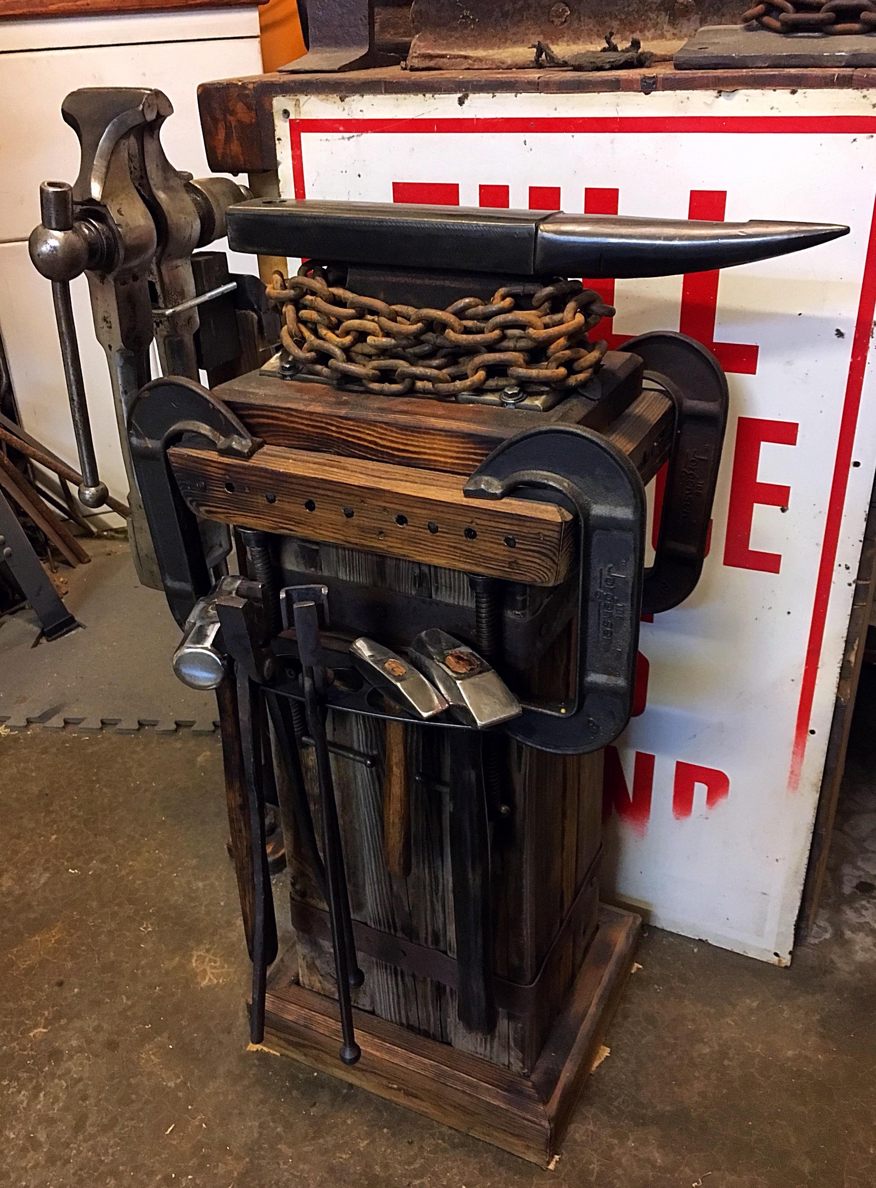

Guess I’m on the other side then because I steer people interested in Blacksmithing towards RR track anvils as a starter.
As they’re inexpensive and will do until a person decides whether they have caught the bug or if it’s a passing fad for them.
If it turns out that they realize it’s not as easy as it looks on TV and give up, at least they’ve not sunk a ton of cash into it.
The one I shaped for myself worked for me until I found exactly what I wanted / needed.
That said, the price asked in the ad is absurd.
I wouldn’t expect more than $125 - 150 for mine with the stand (minus tools & holder).

You’re quite right that most Chinese anvils aren’t going to have great quality control. However I did post one up in “show me your anvil”, Jeremy did as well, and two other smiths have henceforth purchased them. They are a two horn Italian/French type pattern. I might not be the smartest gent, but what I have is steel, it is not cast iron. It has a nice horn, a 3/4” hardy hole, and a pritchel hole. A one inch 52100 bearing dropped from 16” rebound OVER 90%. It is only 66lbs, but I’ll take it EVERY day over a piece of horizontal mounted rail. I posted pics and would gladly share the EBay link if our site allowed such things. If you wish I will PM you a link. Again asking me where I’ve seen one as if I’m either ignorant or down right deceitful sets a a particular tone to our conversation and perhaps what your opinions of me are.
