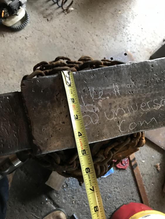

TeH_Chach Posted October 29, 2018 Share Posted October 29, 2018 Good Afternoon, This is my first post so forgive me if I’ve broken any rules. I have ave a pre solid wrought stamped PW anvil that needs some work done to the face. At some point someone repaired almost the entire surface with weld. With that being said there is still a lovely ring and the rebound is about ~70%. There is a lot of perocity in the welds and the face is no longer flat. I ground the blemishes out with a 4” grinder from a grinding disk to 120g flap disk. I was able to grind it smooth but it’s not flat. I called a local machine shop and asked them if they would deck it for me. The difference between the lowest point and the highest is about an 1/8th of an inch. I’m thinking it will probably be ok if they mill that much material off the face. Can someone please advise? Thanks in advance! Quote Link to comment Share on other sites More sharing options...
HojPoj Posted October 29, 2018 Share Posted October 29, 2018 Unless you know how deep the hardfacing was put on, you run a high risk of machining through the hardened section straight into the soft stuff. Personally I'd leave as is, unless I had the resources to resurface it (either the materials/equipment/knowledge, or access to a anvil repair workshop). The same could be said with trying to clean up the face, you might've removed a fair amount whatever hardened material was left. Unless the pits are causing a serious detriment to the surface finish of your work or the variance in the face is seriously affecting your ability to work the steel, just use it as-is. Quote Link to comment Share on other sites More sharing options...
arkie Posted October 29, 2018 Share Posted October 29, 2018 DON'T MILL OR GRIND IT!!!!! The polishing you did is sufficient. Just hammer and forge your work on it. That will eventually work the surface more smooth. The departure from perfectly flat can work to your advantage in straightening some pieces. Quote Link to comment Share on other sites More sharing options...
JHCC Posted October 29, 2018 Share Posted October 29, 2018 What HojPoj and arkie said. A slight hollow as you describe is actually good for straightening out bent pieces. That said, Welcome to IFI! If you haven't yet, please READ THIS FIRST!!! Quote Link to comment Share on other sites More sharing options...
TeH_Chach Posted October 29, 2018 Author Share Posted October 29, 2018 11 minutes ago, arkie said: DON'T MILL OR GRIND IT!!!!! The polishing you did is sufficient. Just hammer and forge your work on it. That will eventually work the surface more smooth. The departure from perfectly flat can work to your advantage in straightening some pieces. So the lack of a level surface is ok? Would it be acceptable to clean the rest of the face as I did the front 4 or so inches? Quote Link to comment Share on other sites More sharing options...
JHCC Posted October 29, 2018 Share Posted October 29, 2018 It's perfectly acceptable as it is. You can do heavy forging anywhere on the face without issues (and frankly, I've worked on much worse anvils) and move to the polished area for planishing (lighter hammer blows to clean up the surface). Further grinding is unnecessary and possibly detrimental. By the way, where are you in Cleveland? Quote Link to comment Share on other sites More sharing options...
Daswulf Posted October 29, 2018 Share Posted October 29, 2018 I'm surprised someone welded over the face and you have around 70%rebound. Might have been done somewhat correctly. No, 1/8" unevenness is nothing to worry about. It's not a machining deck, it's an anvil. Use it as is. If somehow you are good enough to need a perfectly flat face to forge on then you should be able to forge enough work on that one to be able to afford a new anvil. That anvil looks like it'll work fine as is. The little bit of porosity shouldn't affect your work. Quote Link to comment Share on other sites More sharing options...

ThomasPowers Posted October 29, 2018 Share Posted October 29, 2018 The question is: what are you doing that requires a perfectly level face? Most of use have no issue with working with a bit of sway as the sway of the section directly under the hammer face is generally minute. Now if you have a need for a quite flat and level face perhaps a forklift tine could be used for that particular process. Quote Link to comment Share on other sites More sharing options...
TeH_Chach Posted October 29, 2018 Author Share Posted October 29, 2018 Thank you everyone for the information! I was just under the assumption that the face of an anvil was supposed to be flat. All of the input has changed my mind about machining the top. I'm glad I looked for counsel before I went forward with the machine shop. Quote Link to comment Share on other sites More sharing options...
