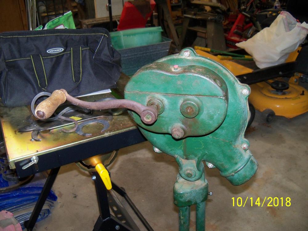

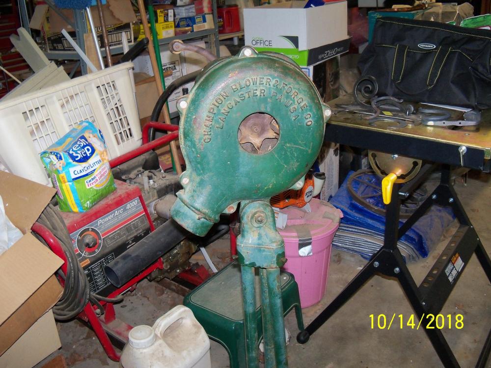

RidgelineForge Posted September 29, 2018 Share Posted September 29, 2018 Hello! I'm a 5-year blacksmith from East Tennessee, and to replace an old beat up blower that was given to me ages ago, I bought a new (to me) Champion forge blower on the morning of the 27th of October, along with a beautiful anvil and grinder and other tools. I have easily identified everything else to models, makers, and years, but this blower is still a mystery. I can't seem to find the information I need to identify the age and model of this blower, and I would like to know that information if at all possible. I have not been able to clean any of it up as of my posting this question, so please excuse the mess of it, though it is still in very good condition. But in short, my questions are these: might anyone be able to help identify the age and model of this blower? Quote Link to comment Share on other sites More sharing options...
Reeltree Posted September 29, 2018 Share Posted September 29, 2018 400 ? maybe nothing is on the other side ? could be a 200 ? Quote Link to comment Share on other sites More sharing options...
RidgelineForge Posted September 29, 2018 Author Share Posted September 29, 2018 It's definitely not a 400, their gearbox is perpendicular to the fan. Hmm...I don't know anything of a 200, so I couldn't say. Do you have any references to one? There are absolutely no stamps or raised lettering on the other side. That is all there is in lettering. The nearest thing I can find is a rivet forge blower, but this was obviously built to be on a stand, so it doesn't line up. It's quite a mystery to me! Quote Link to comment Share on other sites More sharing options...
jlpservicesinc Posted September 29, 2018 Share Posted September 29, 2018 show pictures of the other side.. The gear housings were different for the different models, 400, 200, 100.. Quote Link to comment Share on other sites More sharing options...
RidgelineForge Posted September 29, 2018 Author Share Posted September 29, 2018 This is the only picture I have at the moment, I'm afraid. (I'm travelling for the weekend and will have more pictures when I return home.) I removed the access hatch to inspecting the housing in this image. The crank is not their typical weighted handle style, which is why it led me more towards the rivet forge style. You can see from the first image that it sets entirely behind the air chamber, and as a whole, the blower is the size of a No. 40 model. Sorry for the inconvenience. This is the only picture I have at the moment, I'm afraid. (I'm travelling for the weekend and will have more pictures when I return home.) I removed the access hatch to inspecting the housing in this image. The crank is not their typical weighted handle style, which is why it led me more towards the rivet forge style. You can see from the first image that it sets entirely behind the air chamber, and as a whole, the blower is the size of a No. 40 model. Sorry for the inconvenience. Quote Link to comment Share on other sites More sharing options...
ThomasPowers Posted September 29, 2018 Share Posted September 29, 2018 And you know that's the original handle how? looks like a cream separator handle to me. (If your car was around 100 years old what replacement parts might you find on/in it?) Quote Link to comment Share on other sites More sharing options...
RidgelineForge Posted September 29, 2018 Author Share Posted September 29, 2018 You raise a good point. While I cannot know for certain, if you search for other champion rivet forges, and even in their original catalogues, they are seen with these handles as well. I could be wrong, and would appreciate anyone to show me this, but as far as I can tell, this is the original handle. Quote Link to comment Share on other sites More sharing options...
ThomasPowers Posted September 29, 2018 Share Posted September 29, 2018 Rivet forges have a way different sized blower. All the larger champion blowers I have seen use the counterweight handle. (Of course that is just a statistical sample with n of several hundred...) I've noticed that the Champion Lancaster and Champion #40 blowers have the parallel gear box. I was looking for the 3 legged stand though. I note that Centaur Forge sells a copy of the 1909 Champion catalog for a reasonable amount. Quote Link to comment Share on other sites More sharing options...
RidgelineForge Posted September 29, 2018 Author Share Posted September 29, 2018 Okay, thank you for the clarification. I have not seen a rivet forge in person myself, so I do not have a reliable comparison, but this blower itself is also not very big. Considerably smaller than a No. 400, which in my opinion gave it no reason for the weighted end. It is certainly sized for a smaller forge. Indeed, they do. It does have a three-legged stand, but again, I apologize for not having pictures ready and cannot refer to it at the moment. Quote Link to comment Share on other sites More sharing options...

RidgelineForge Posted September 30, 2018 Author Share Posted September 30, 2018 Update: Here are the images of the stand and the back, so you can see for yourself what those look like. I appreciate any insight anyone may provide! Quote Link to comment Share on other sites More sharing options...
Farmall Posted September 30, 2018 Share Posted September 30, 2018 I’d say it was a champion Midway blower. There was also a Lancaster,but they were generally marked Lancaster. Quote Link to comment Share on other sites More sharing options...
RidgelineForge Posted September 30, 2018 Author Share Posted September 30, 2018 Doesn't quite have the markings or housing of one, does it? Does it look that old of a model? Quote Link to comment Share on other sites More sharing options...
Wolf Prairie Arts Posted October 1, 2018 Share Posted October 1, 2018 Is it a Champion #140? It has that style of handle and a 3-legged stand. See Page 10 of the #80 catalog posted at https://ozarktoolmanuals.com/wp-content/uploads/pdfcatalogs/Champion_Blower_Forge.pdf It might also be a #40 or a Lancaster Geared Blower as they appear to use the same gearbox, but a different handle. The midway has a vertical gearbox so it's out As many have stated it appears to be too big to have the eureka geared blower on the smaller agricultural/rivet forges. Henry Quote Link to comment Share on other sites More sharing options...

RidgelineForge Posted October 2, 2018 Author Share Posted October 2, 2018 Thank you, Wolf Prarie Arts, it does look exactly like a 140, just without the markings, but the handle and the gearing are all the same, and the rest appears accurate as well. Is it possible the gear box was replaced at some point? Or did not have lettering in earlier models? I'm well versed in quite a lot of things, but blowers was one I skimmed a little bit in my research, so I know what to look for in a good blower, as well as the best makers, but little else. I apologize for my ignorance, but it has led me to quite an educational experience here. Quote Link to comment Share on other sites More sharing options...
stevomiller Posted October 3, 2018 Share Posted October 3, 2018 Sure looks like the 140, that’s a nice blower you’ve got, whatever model it is. And that was great catalog WPA shared, thank you. It appears Champion liked using cream separator handles on a couple models. Quote Link to comment Share on other sites More sharing options...
