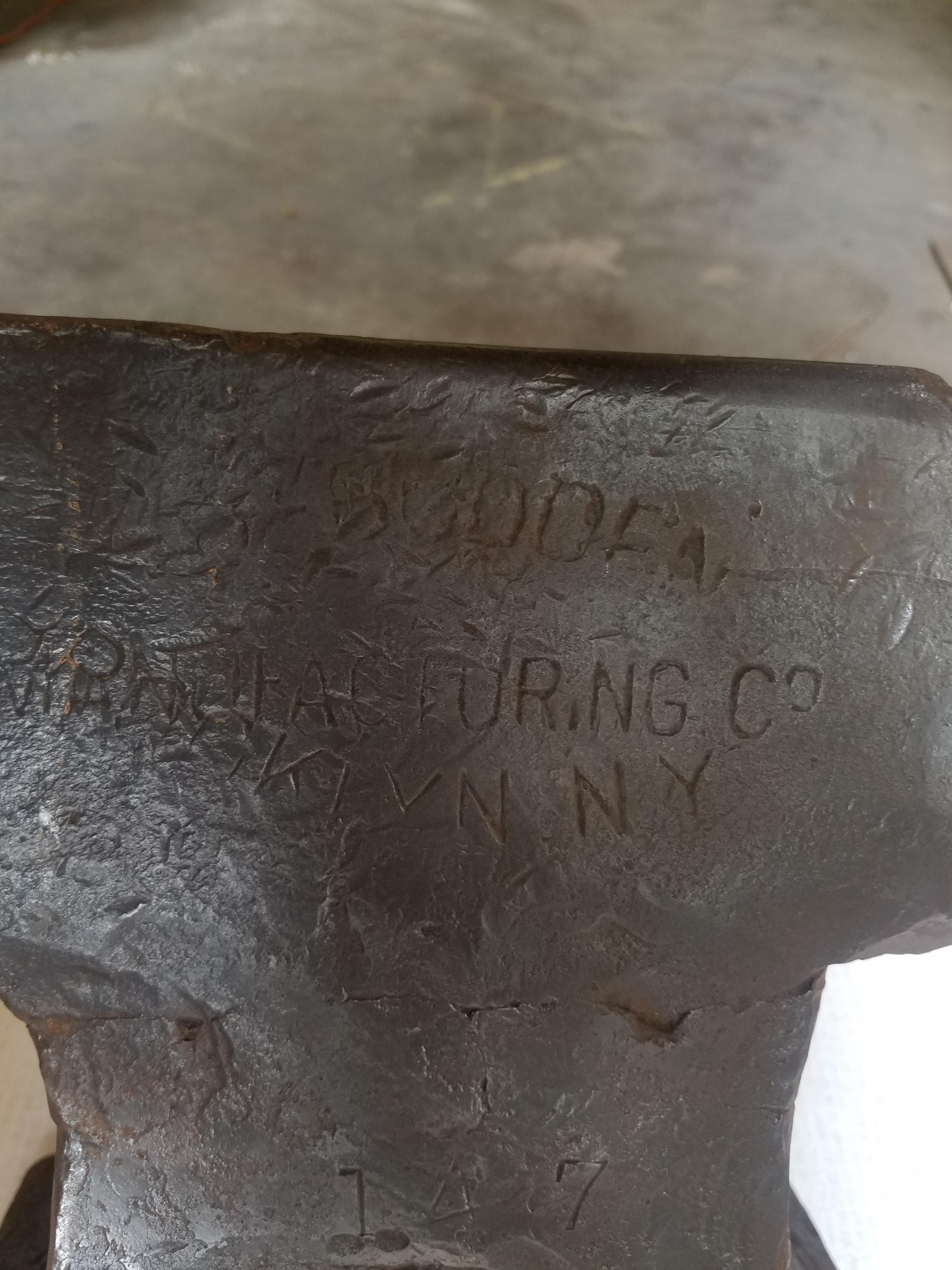

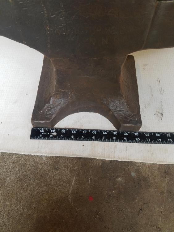

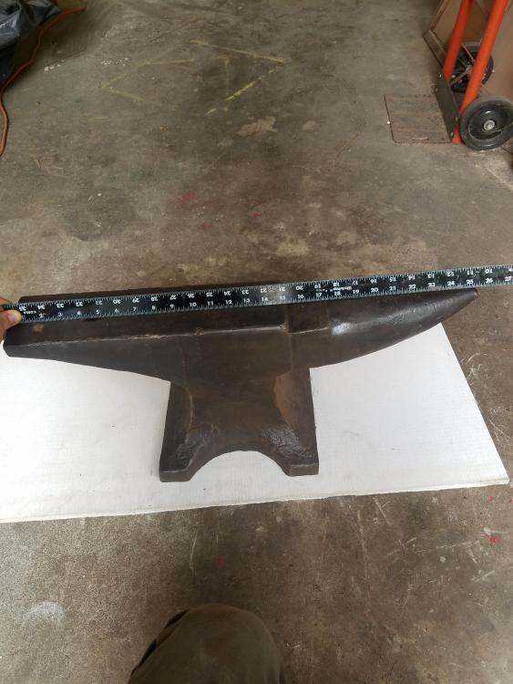

I am trying to suss out the origin of my anvil.

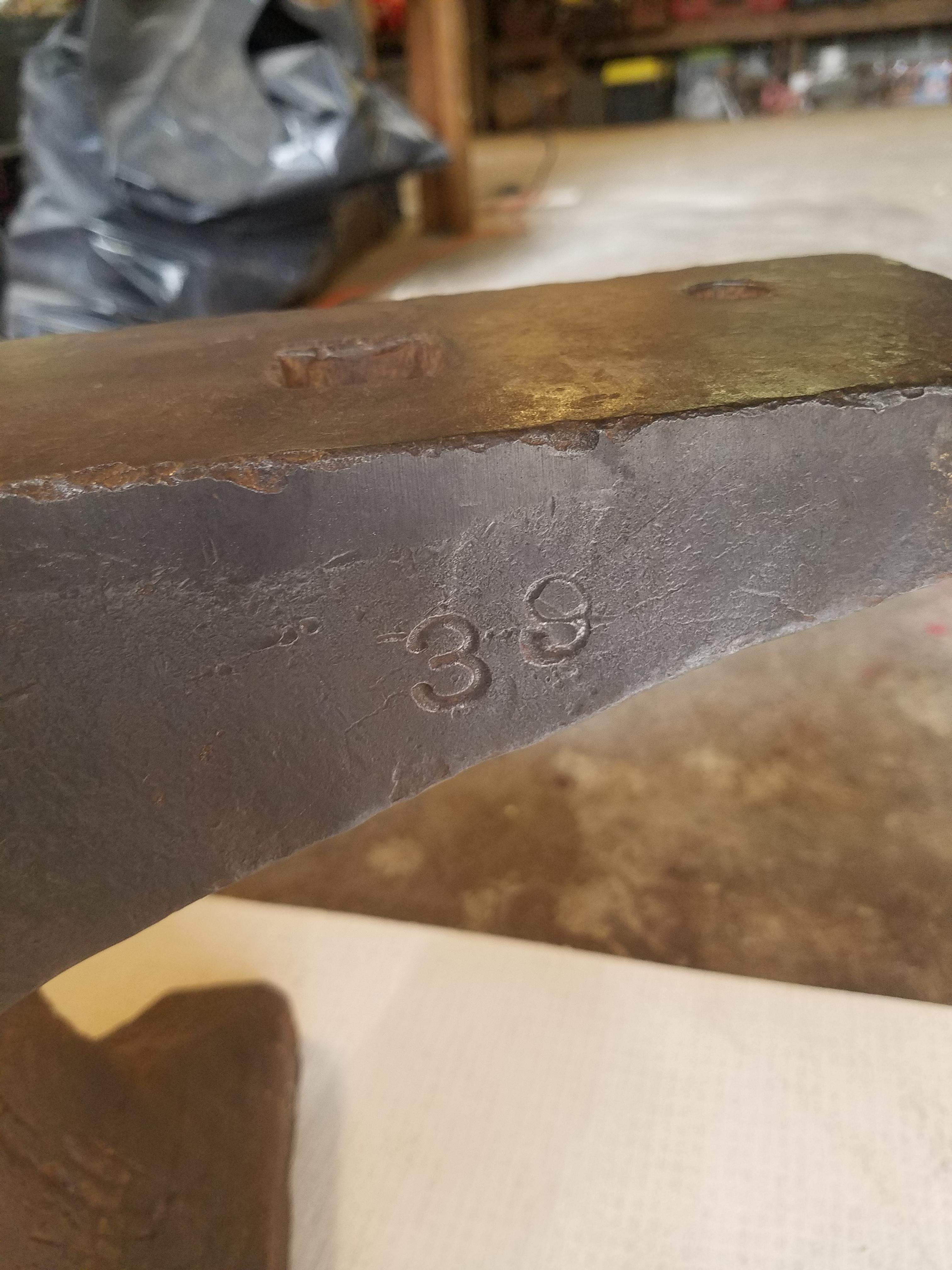

It weighs 147.5 lbs. and it bears the marking "147".
It has the markings "163165" on the base.
It also has a marking that I believe says "Brooklyn, NY", and "______ manufacturing CO".

Hay Budden.
Where in the world is it? Could you add your city state or country to the profile?
Also one with the solid tool steel from the waist up. Good find and nice usable condition too. It should serve you well.

Is there any way to figure out when this anvil was made from the stamps on it?
Talking about the Forged in fire show. it inspired a lot of people to want to try the craft and anvil prices seem to have gone way up.
Someone with the anvils in america book might be able to help with a date from that serial number. I unfortunately do not have the book.
Im more into the using and usability of anvils and you have a fine anvil there. With the solid steel upper it will hold up well.
