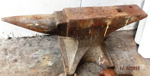

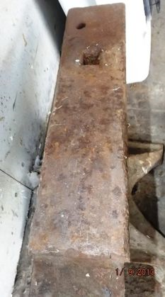

Am going to look at this 200# Trenton Friday, looking at the pictures can you give me any opinions, I am totally new to this game.

Well, it looks like a good usable anvil. Take a ball bearing and a wire brush with you to clean up the face a bit to do a rebound rest. Ring test it as well to be sure the face plate isn't delaminating anywhere.
Trentons are usually great anvils.
Thanks
Second what Das said.  Cleaning the face of rust will give you a more accurate drop.  Take a yard stick or tap measure with you and drop the ball bearing from 10 inches.  You are looking for a 7 inch return at least.  Do it in multiple places.  The drops toward the heal (back of anvil where hardy and pritchel holes are) will have a lower drop return so don't let that worry you too much.  Ask the seller first, and if they say it's ok give that face a good cleaning with the wire brush and then take a cloth and wipe off all the rust dust.
It looks like a very nice anvil, but make sure to do the above testing especially with anvil prices being so high these days.  The only thing worse that paying too much for an anvil is paying too much for an anvil that has little rebound and obvious problems.
Good luck and make sure to let us know what happens.  It looks like it could be an early German Trenton.  If so, the weight will be in pounds between the feet on the side where the diamond Trenton logo is stamped.  It also won't have a serial number stamped on it anywhere.
Thanks for the help, I only know what I have learned here and reading on other sites. Nephew bought one, a Vulcan, and ended up with an anvil without the hardened plate. $140 bucks of tuition.
Ouch!  Like you, I read everything I could on this forum before looking for anvils.  It helped me avoid a costly mistake.  The Trenton I got is an old German one and it has 90% - 95% rebound.  It's got some minor edge chipping and a little sway up toward the end of the face plate near the horn but I only paid $1.67 per pound for her in the end.  Next one I picked up for 31 cents a pound due to the possibility it may have been through a fire and it had a few other edge issues / a tiny torch mark.  At $50 for a 160 pound Fisher, I wasn't going to pass that up.  Glad I didn't because after a clean-up she was giving me 70% - 75% rebound which tells me she's still pretty hard and plenty usable.

Well, at least it was a good drive. First off the anvil looked awesome. Rebound was only around 50%, and I got absolutely no ring out of the anvil at all. Was still gonna hang around and see what it went for, but ended up getting a call and having to leave. Still on the prowl.
The rust will dull the ring ( a little) and the rust will also lower the rebound test. But it sounds like it should have had a little more ring and rebound than that if you cleaned the surface a little.
We mention these tests because an anvil could go through a fire ruining the hardness of it even if it "Looks" fine.
Good luck on the hunt. Dont forget to use the TPAAAT.
Dumb question , but what is TPAAAT
I cleaned it a little, rebound in some parts was good, but middle of anvil was like 30%. I was shocked I couldn't get any ring out of it.

It should have rang.  Here's a picture of my rusty Trenton when I bought it and it rang all over no matter where I tapped it. You were wise though.  Those tests saved you from a costly mistake.  This is how good I had to clean mine to get a good rebound test, but even rusty it still was lively.
