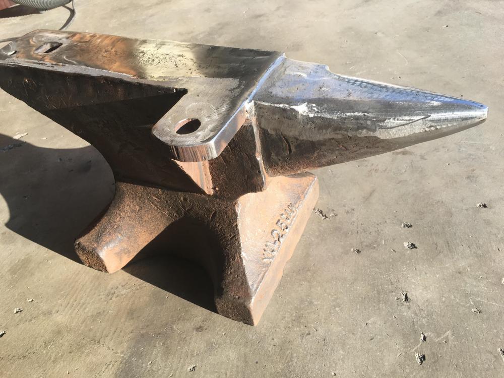

yotie Posted August 26, 2018 Share Posted August 26, 2018 Hello, I recently purchased this VULCAN 25 anvil. Weight is 250 lbs . My question is , I don’t see the arm and hammer logo , on the side I see in faint detail , National supply tool company . Is this anvil any good ? Link to comment Share on other sites More sharing options...
Steve Sells Posted August 26, 2018 Share Posted August 26, 2018 you tell us, how is the rebound? It looks like someone attacked it with a grinder. I Hope its just a light sanding and not removing any of the working area. Link to comment Share on other sites More sharing options...
the iron dwarf Posted August 26, 2018 Share Posted August 26, 2018 looks like lots of damage on that anvil, all of the heel and edges seems to have had welding and grinding done on it, hope you did not pay more than $50 for it Link to comment Share on other sites More sharing options...
yotie Posted August 26, 2018 Author Share Posted August 26, 2018 1 hour ago, Steve Sells said: removing any of the working area. A little grinding , not much . Rebound is good all over . 1 hour ago, the iron dwarf said: looks like lots of damage on that anvil, all of the heel and edges seems to have had welding and grinding done on it, hope you did not pay more than $50 for it Geez! $50! Anvils are like gold out here in Southern California , $50 gets you a harbor freight 55lb anvil or 1 foot peice of railroad track . The top is pretty flat and hard, no denting when hitting on it . Link to comment Share on other sites More sharing options...
the iron dwarf Posted August 26, 2018 Share Posted August 26, 2018 anywhere it has been welded on should be avoided by at least an inch all round and taking off 1/1000" of the surface can take decades off its life. if it is as bad as it looks it could be no better than a chinese lump of cast iron. the heat of welding can ruin the hardness of the top plate over a large area Link to comment Share on other sites More sharing options...
yotie Posted August 26, 2018 Author Share Posted August 26, 2018 41 minutes ago, the iron dwarf said: quote removed Wow no better then a Chinese lump of cast iron ! Broke two of those and they dented with every blow from the hammer , this one doesn’t . But back to my original question . Should this bear the arm and hammer sign ? Or not all Vulcans do? Link to comment Share on other sites More sharing options...

the iron dwarf Posted August 26, 2018 Share Posted August 26, 2018 our main shop anvil is only about 150 lbs but it gets very heavy use 5 days a week, often with a 14 lb hammer, it is 300 years old and should be good for another 300. it is often used for working large bits of chrome vanadium and other tough materials and it will probably have less wear in my lifetime than yours will have with light use in a year but you are an expert and know everything Link to comment Share on other sites More sharing options...

jlpservicesinc Posted August 26, 2018 Share Posted August 26, 2018 Ideally we are all looking for what an anvil is worth and whether we did good or bad in terms of buying or selling for that matter.. Ideally, never buy a damaged anvil it just inflates the price.. With that said, if someone does buy a damaged anvil fixing it correctly is the best way which requires a very large forge and a huge heat treat tub and no one currently does it in the USA.. Refflinghaus of Germany still repairs anvils with steel faces from what I have read.. There are other ways of fixing and anvil properly with modern arc welding though it is still frowned upon as it's not an original way of doing it.. Does it work, yes and getting involved with an anvil repair day that the people are experienced can lead not only to a nearly perfect anvil but also make a mediocre anvil like new.. Problem with getting a straight reply is after most being involved for 20 years + they have seen more damage done to anvils than fixed.. and frankly get tired of the question.. This holds true today as smithing has taken off again.. So the question of good or bad is the toughest one to ask.. So, these brand of anvils were and are perfectly serviceable.. Many were produced and were considered a lesser than anvil compared to forged or a Eagle anvil.. With the welding on of the side piece and corner damage most in the "Know" would have passed on it unless it was really cheap/inexpensive.. Link to comment Share on other sites More sharing options...
