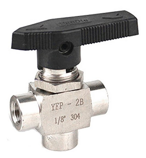

Zeroclick Posted June 15, 2018 Author Share Posted June 15, 2018 9 hours ago, Charles R. Stevens said: To reduce the noise ad a “T” and expell the exes air. A lot quieter. I never have liked the wine of vacuum cleaners. Do you mean something like this so that as I reduce the air it can redirect it out to prevent that whine. Quote Link to comment Share on other sites More sharing options...
Charles R. Stevens Posted June 15, 2018 Share Posted June 15, 2018 Nothing so fancy, just a plain 3/4” T with a valve on one branch, the pump on another and the tuyere on the third. This way you open the valve to let air out of the T, thus reducing the volume of air coming out the tuyere. Set up the tuyer on the center of the T and the valve and pump on opposite sides. Quote Link to comment Share on other sites More sharing options...
JHCC Posted June 15, 2018 Share Posted June 15, 2018 This is what IFI member Jasent uses: Quote Link to comment Share on other sites More sharing options...
Zeroclick Posted June 15, 2018 Author Share Posted June 15, 2018 That seems nice and simple I will go with that. Hopefully I can get a test one put together in the next couple of weeks. I have some wood ready for the Jabod, just need the bricks and cat litter. Quote Link to comment Share on other sites More sharing options...
