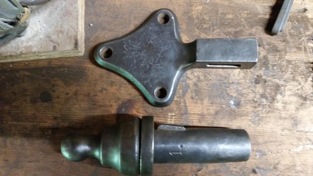

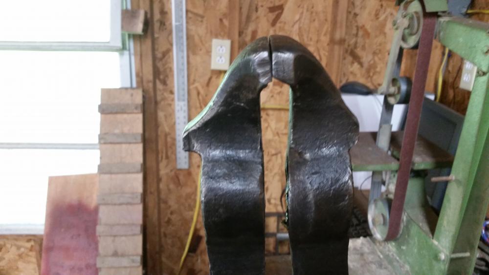

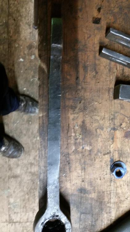

Sorry i forgot to take pictures yesterday when i was working on it. So i took it back apart and with a little persuasion i was able to remove the screw box. So i cleaned that up and put it back together, with the same issue with the jaws not closing. Now that i can get the screw box off maybe i can make some shims? I hope that the pictures help.

Hi JSavon, I think Marc1 is right, it looks from the pictures like the movable jaw has been overworked and the result is that it has bent back. Normally the jaws should close tight and the top of the jaws should match in height, it looks like the movable jaw is bent back and the top of the jaw is higher than the stationary jaw. I repaired one with identical damage 7 or 8 years ago for a fellow. I used my OA torch and a rosebud to heat the damaged jaw and hammered it back to proper shape/alignment, it also had cracks in the eye area which I v'd out then welded up with 7018 result good for another 100 years or so. One other problem I have seen with post vices is a lot of crud in the box preventing full closure, yours looks to be bent from the pics. Good luck hope this helps
You are right, it seems the moving jaw is slightly bent, but not as much as the gap. One thing that is obvious is that the jaws don't match.
The stationary jaw is way thinner and has a thinner pad. (?) may be it is a Frankenstein vice?
I got nothing. personally I wouldn't try to heat it and bend it back for fear of making it softer, but maybe my fears are founded in ignorance ... don't know. :)
If I was stuck on a island and this was my only vice and I had zero chance of buying another one ... I would start with building up the stationary jaw to match the other one to start with. May be that is all it needs.
I'd say both are bent - easy fix with a little heat. I have repaired a few of mine by doing this (heating the eyes and bending back to where they should be), they all are still working fine.
heating and bending the leg is no problem as it's low carbon.  However I am of Marc's opinion that this is a frankenvise due to the different jaw shapes. Can we see a picture of how well the pivot area matches?
Now what causes the won't close issue?  Screw bottoms out in the screwbox?   Moving jaw hits the mounting band? Moving jaw hits the screw cover?  Other? Please describe...
All of these can be fixed but the fixes are all different; Shoot I even once changed the vertical distance by heat shrinking and riveting a plug in the moving jaw pivot hole and redrilling it to get the top of the jaws to match.  I've done a couple of vises where the bearing hole was wallered out and I redrilled to the next size up and put in a new bolt.

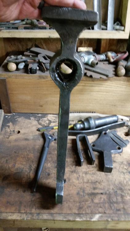

I took it back apart to give some more pictures.

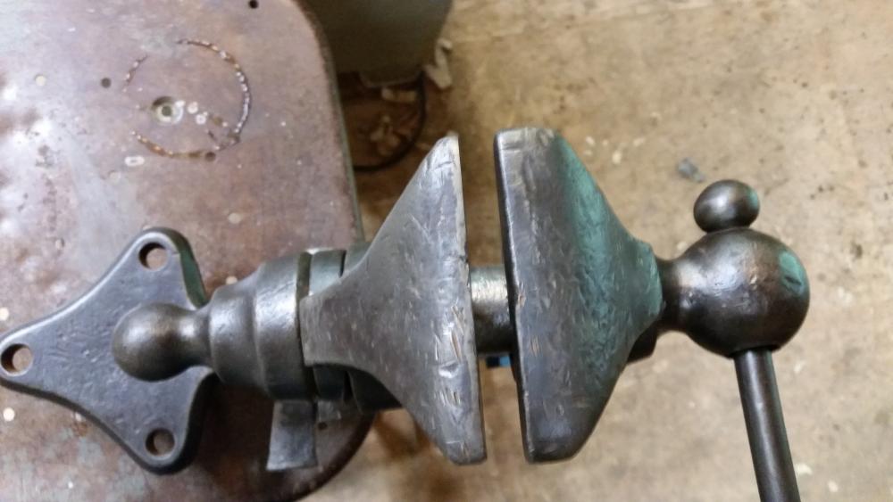

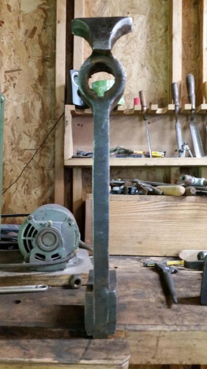

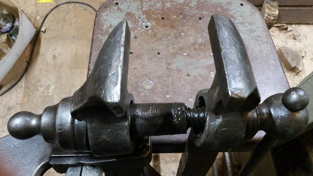

What seems to be the problem is that the screw box is too long, i guess it could be caused by it being bent and twisted every which way to Sunday. When i removed the screw box it seems to match up pretty well, but as soon as i put back into position it pushes it back out 1/2" or so. Any way here are the pics. Thanks again everyone!
John
So the front of the screwbox is running into the section of the moving jaw eye where it narrows down to about the diameter of the screw?
Definitely a marriage.  There are a couple of ways to deal with it: one is to truncate the excess length of the screwbox with perhaps a bit of filework to round the cut edges and make it easier to get the screw threaded in. (As the screw only comes out for cleaning/greasing/oiling not too much an issue with it taking a little finessing to get it started.)
Another would be to make a thicker washer for the backside of the stationary leg eye. However too thick and you would lose the keying in of the screwbox "keel". (Partial keying can result in keel failure...)
Straightening the top of the moving leg would reduce the amount of distance you have to close but be a much larger task. I would heat the top section and use my large screwpress and some careful blocking to get the section I wanted to bend to bent *CAREFULLY*!

looks like a couple things to me, first is it looks like the fixed jaw either had a steel jaw on it and the weld failed or it had a date with a grinder. second, it appears the moving jaw is bent outward, or more accurately, someone seriously over tightened the vise and sucked the part of the jaw the screw goes through in. i would straighten everything out as best you can and go from there but i may also be completely off base so take my rambling with a grain of salt. how are the threads on the screw? they look more pointed than square in the picture but it could also just be the lighting
J ... yes the moving jaw is a bit bent, and it seems others have done it and it is possible to heat and straighten it. You will need a large forge, a big anvil a big hammer and a big arm :) ... or may be it is easy ... don't really know.
Or you can live with the bent side for now ... you can always revisit this ... and make a new jaw/face/pad/whatever ...  for the fixed side. Bevel the edge all around, stick weld, grind flat and Bob is your uncle. :)

Simple temporary fix:  forge a thick washer for the screw to be placed in between the "crank" and the moving jaw.  Won't help with alignment, but will help it close.  Will also reduce jaw opening the thickness of the washer, but at least it will work for a while.
As I understand it the "nose" of the screw cover of the screwbox is contacting first so a washer in front of the moving leg  will not work.  I've alread mentioned the possibility of a washer to shift the screwbox back and that it might cause trouble with the key that keeps the screwbox from rotating.
best fix is to just electric arc weld on a new HC steel jaw..    Easy pease with a little pre heat..  or bring it to the next NEB meeting and we can weld on a new one the old fashioned way.. :)
Even simpler fix: get (or make) a couple of pieces of thick-walled angle iron to act as jaw liners. So long as their combined thickness is greater than the gap, you're golden.
