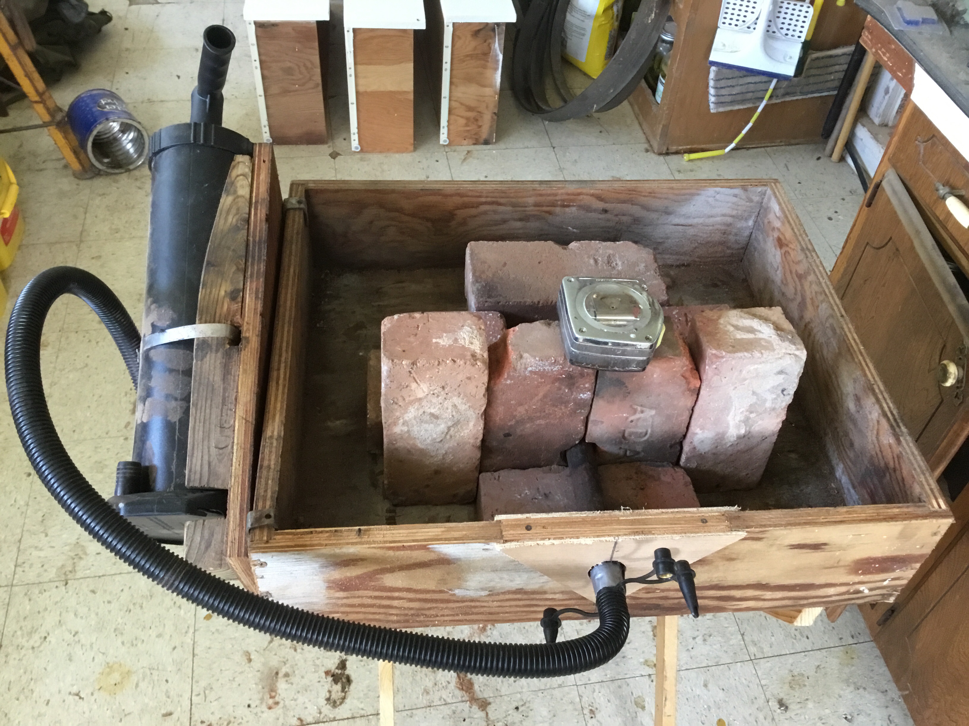

boattlebot Posted May 31, 2018 Share Posted May 31, 2018 well here it goes, new guy from upstate new york (if anyone is even remotely close to here that would be awesome) and I'm very new to this. bought a anvil from harbor frieght (yes I know) and I got some 1/4inch steel I'm putting ontop of it (to make it less harbor frieghty) I'm currently working on building my forge (going the charcoal hair dryer root) took the lid off one of my old tool boxes (I was going to put it big hole up and line it with fire brick but after more digging around I decided I'll use it as the stand and go see if a buddy of mine has any brake drums off a van or truck laying round). I also got some hammers from harbor frieght. little mini sledge thingy with a sloped back a ball peen and a tack hammer. why a tack hammer? becuase I figure I can use it for rivits or somethin for reasons that will soon become aparent. I'm getting my shop set up for the most part right now (it's also my storage locker, garage, and fabrication shop. it's tiny. you can't work on a full sized bagger in there to give you an idea) my eventual goal is to be able to make blades. (told you it would be aparent) knifes mostly. and swords. (I'm a sucker for a nice claymore....) but I also realize you can't just buy an anvil and make a sword and call it a day. so some advice would be nice here (even if it's just where on here to look for beginner stuff, I looked and looked and really couldent find a here's how not to be a dumb uhhhh donkey? (side note is cursing permissible here?) or just a general idea of where to begin. I'd also like to make practical things. like I really don't know to be honest. so again any advice is apreaciated. some things to know bout me, I consider myself a very smart idiot. so feel free to tell my I'm a idiot. I'm also bad at spelling. my autocorrect actually handed me a 2 week notice last week becuase of it. otherwise I joke and just try to have a good time. might as well right? who sets out to have a bad time? I'm also known to ramble on about nothing while sometimes talking in circles without ever reaching a conclusion. (no I'm not a politician) so thanks for reading this rambling mess of a sleep deprived biker who decided he wants to hit glowing metal with a hammer ps. where do you get cheap metal to just bang around? Quote Link to comment Share on other sites More sharing options...

boattlebot Posted May 31, 2018 Author Share Posted May 31, 2018 I'm a sucker for madness. thanks for the name of that hammer (is a cross peen a decent hammer to use?) I plan on using charcoal (coal is hard to find here so I'll save that for when I actually learn what I'm doing and plus a bag of charcoal is alot less suspicious) and thanks for the tip on the rotor instead of a drum. rotors are alot easier to find. with a rotor will I need to use fire brick or anything? or will the heat on the outside of the charcoal "volcano" (I read how the fire should be on here somewhere. forget what thread it is) be low enough to not worry about the rotor? I'll take a pic of the set up once construction is complete. and thanks for the heads up on the cursing. I curse alot so I figured it was worth asking before I said something I was not supposed to haha Quote Link to comment Share on other sites More sharing options...
ThomasPowers Posted May 31, 2018 Share Posted May 31, 2018 Actually a more landlord appealing forge and one better suited for outdoor use in your climate would be to build a JABOD inside the carcass of an old gas grill. That way you can close it up easily when it rains and grills don't usually cause landlords to have conniption fits... No boards needed for it too. As for learning; look through the books reviewed at some point you will want _Introduction to Knifemaking_, Sells and Hrisoulas' _The Complete Bladesmith_, _The Master Bladesmith_, _The Pattern Welded Blade_ HOWEVER these are not books to teach you the basics of blacksmithing! Just like you don't start Driver's Ed with "Strategy and Tactics in Formula One Racing" it will really help speed you up to get to bladesmithing by learning fire control, hammer control, tool use, workpiece temperature control, how steel moves, etc before getting into working high carbon/high alloy metals---unless you are very good with frustration and throwing away stuff you have spend solid days working on cause you made a "beginner's mistake" on an advanced project. Finally the fastest way to accelerate through the learning curve is to find local smiths and spend time with them. Look for a semi local ABANA Affiliate and get to a meeting or two and ask them who is local to your area! Quote Link to comment Share on other sites More sharing options...

Daswulf Posted May 31, 2018 Share Posted May 31, 2018 Cross pein is a fine hammer to use blacksmithing if the face is properly dressed. ( yup there's a thread or 5 on that too. ) You can go with the bottom blast rotor forge for charcoal but it will eat up more fuel than a properly built side blast forge. With the rotor you dont need anything else to insulate it as long as the table is made of metal right around it. Thomas's idea of a side blast in an old grill would work fine even if you dont need to be more inconspicuous. It's all in what you want to make. Do some reading, check out what others have made and see what works for you with what you have to work with, and the tools you have at hand. Remember to use real lump charcoal and not the briquettes. There are those of us who cuss like sailors in our daily lives, but it doesn't help to learn or teach blacksmithing and there are youngsters on here learning ( or even teaching) on here and Glenn likes to keep it clean so anyone can feel comfortable here. Quote Link to comment Share on other sites More sharing options...

boattlebot Posted May 31, 2018 Author Share Posted May 31, 2018 lotsa good stuff in those pinned threads. Haven't read em all yet tho. it's on the to do list. got the rotor. a nice drilled slotted one with a top hat nice and free Quote Link to comment Share on other sites More sharing options...
Charles R. Stevens Posted May 31, 2018 Share Posted May 31, 2018 Remember, a bottom blast forge burning charcoal will eat you out of house and home, wile the same forge will affordable burn coal. A brake drum/rotor forge is bottom blast. Some recommend using the back rotor with a parking brake drum intrigal to the hat as a fire pot. A fire pot is buy no means necessary, as one can mold a duck nest out of mud. One will quickly find that welding up a bottom tuyere from pipe or tubing (round or square) is cheaper than $50 in 2” pipe fittings. Beware of overthinking/overbuilding your first forge. A box of dirt (or a pile of clay bricks) either side blast or bottom blast will alow you to experiment so as to build a better forge after a few weeks and you have learned a bit about fire and steel. Honestly keeping to the biker motif a classic drain pan (lined with clay rich soil to keep the galvanized coating from burning off) will make one a good forge not dissimilar to a rivet forge This forge is not lined, and for effecency even with coal I will eventually tamp clay into it, forming a hearth about an inch lower than the rim with a bowl some 6-8” across. Quote Link to comment Share on other sites More sharing options...
boattlebot Posted May 31, 2018 Author Share Posted May 31, 2018 that is a very nice looking forge. I'll look into coal if it really is cheaper. but my first couple of fires will most likely be charcoal. reason I'm using a box with a rotor is becuase it's free and I don't have to dig a hole. oddly enough it's easier for me to build somethin like this then dig a hole... Quote Link to comment Share on other sites More sharing options...
Charles R. Stevens Posted May 31, 2018 Share Posted May 31, 2018 Can you source dirt from some where to put in a box? Even cheep cat litter/drysweep works. With charcoal you will have to put a coffe can in the rotor and cut notches in the sides to find the hot spot, as the rotor is simply to shallow for a bottom blast charcoal fire. These are all incarnations of the box of dirt forge. Quote Link to comment Share on other sites More sharing options...
boattlebot Posted May 31, 2018 Author Share Posted May 31, 2018 unless I buy the dirt and build a box I'm stuck with portable. and grills are to expensive even on craigslist. I haven't found any scrap ones (it was my first thought) the rotor is about 2 inches deep (if you haven't ride home with a rotor on your back you haven't had enough fun) this is where I'm at. so far as it looks I'll only be out for fuel and a hair dryer and I'll find somethin to make a foot switch eventually Quote Link to comment Share on other sites More sharing options...
Daswulf Posted May 31, 2018 Share Posted May 31, 2018 It's not that coal is cheaper, just that a bottom blast forge will burn more faster then a side blast forge. That's what Charles was getting at. Whatever you make, go with a proven build to start out with. Then you can experiment from there if you like. Many people try to mix up parts of different forge designs and get frustrated when they dont work right. And then there is the air supply to figure out. Quote Link to comment Share on other sites More sharing options...

Daswulf Posted May 31, 2018 Share Posted May 31, 2018 Missed the picture of your rotor up there. Looks like it'll work. Would be better with table space around it but with charcoal you can get away with adding more in there. With coal you'd want space to keep extra coal around the fire pot to come from the heat before adding it in. Fresh " green" coal benefits from cooking before adding it in to the fire once it's going. Now you need to figure out your T pipe. Quote Link to comment Share on other sites More sharing options...
