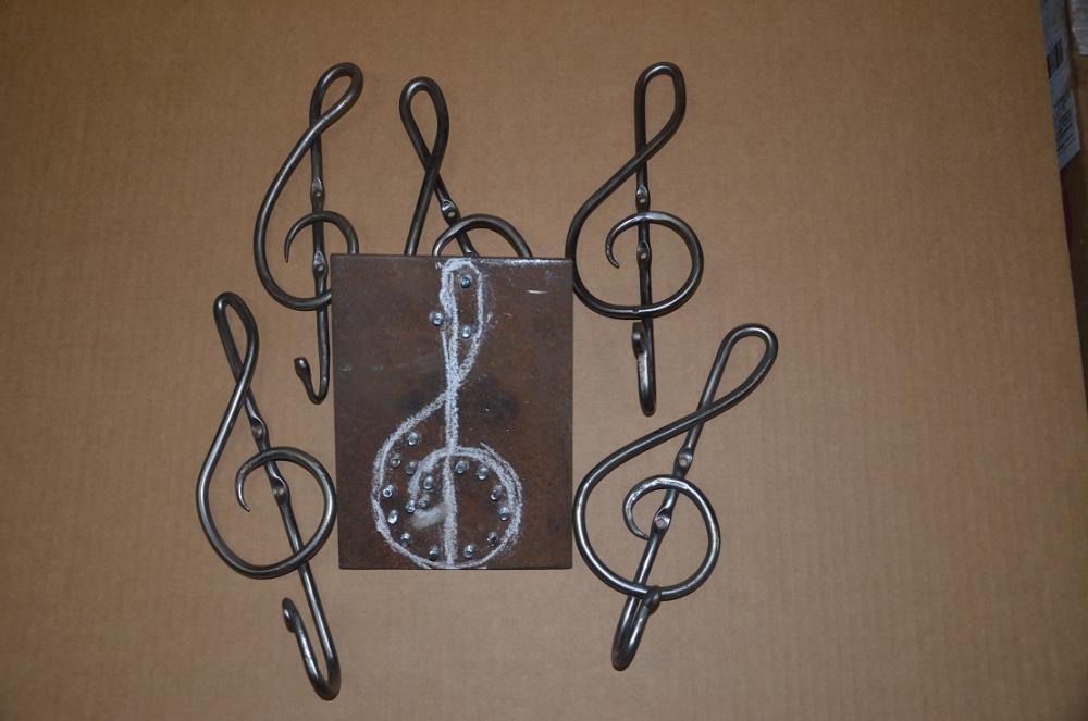

Davishomesteadandforge Posted May 9, 2018 Share Posted May 9, 2018 I didn't find much info for making a treble clef so I figured it tell yall what I learned while I made one for my wife for mothers day. The total stock length should be 3 times longer then what you want the finished product to be. The bigger scroll diameter should be 1/3rd The total length of the peice. The smaller scroll like wise should be 1/6th it's easiest to forge both scrolls first then do the final bend. So for making a 1 foot treble clef; Cut a three foot section of stock Forge a scroll 4 inches in diameter. Forge a second scroll 2 inches in diameter on the other end facing out the same direction Using the 4inch scroll as a guide or measuring 1 foot from the bottom bend the middle price in a half circle fashion where in intersects the large scroll directly half way through making the peice 1 foot tall. Quote Link to comment Share on other sites More sharing options...
ausfire Posted May 10, 2018 Share Posted May 10, 2018 A jig makes life easier: Quote Link to comment Share on other sites More sharing options...

Davishomesteadandforge Posted May 10, 2018 Author Share Posted May 10, 2018 14 hours ago, Glenn said: Weld a piece of pipe for the top loop of the cleft to go around and it will have a much smoother look. Kind of like a bending hardee tool? 15 hours ago, ausfire said: A jig makes life easier: Nice jig I'll have to check into that it would help with the positioning a ton lol is that just a 1/4 inch plate? Quote Link to comment Share on other sites More sharing options...

ausfire Posted May 11, 2018 Share Posted May 11, 2018 18 hours ago, Davishomesteadandforge said: Nice jig I'll have to check into that it would help with the positioning a ton lol is that just a 1/4 inch plate? Yep, with 1/4 inch tank bolts screwed through and welded on the back. Quote Link to comment Share on other sites More sharing options...
