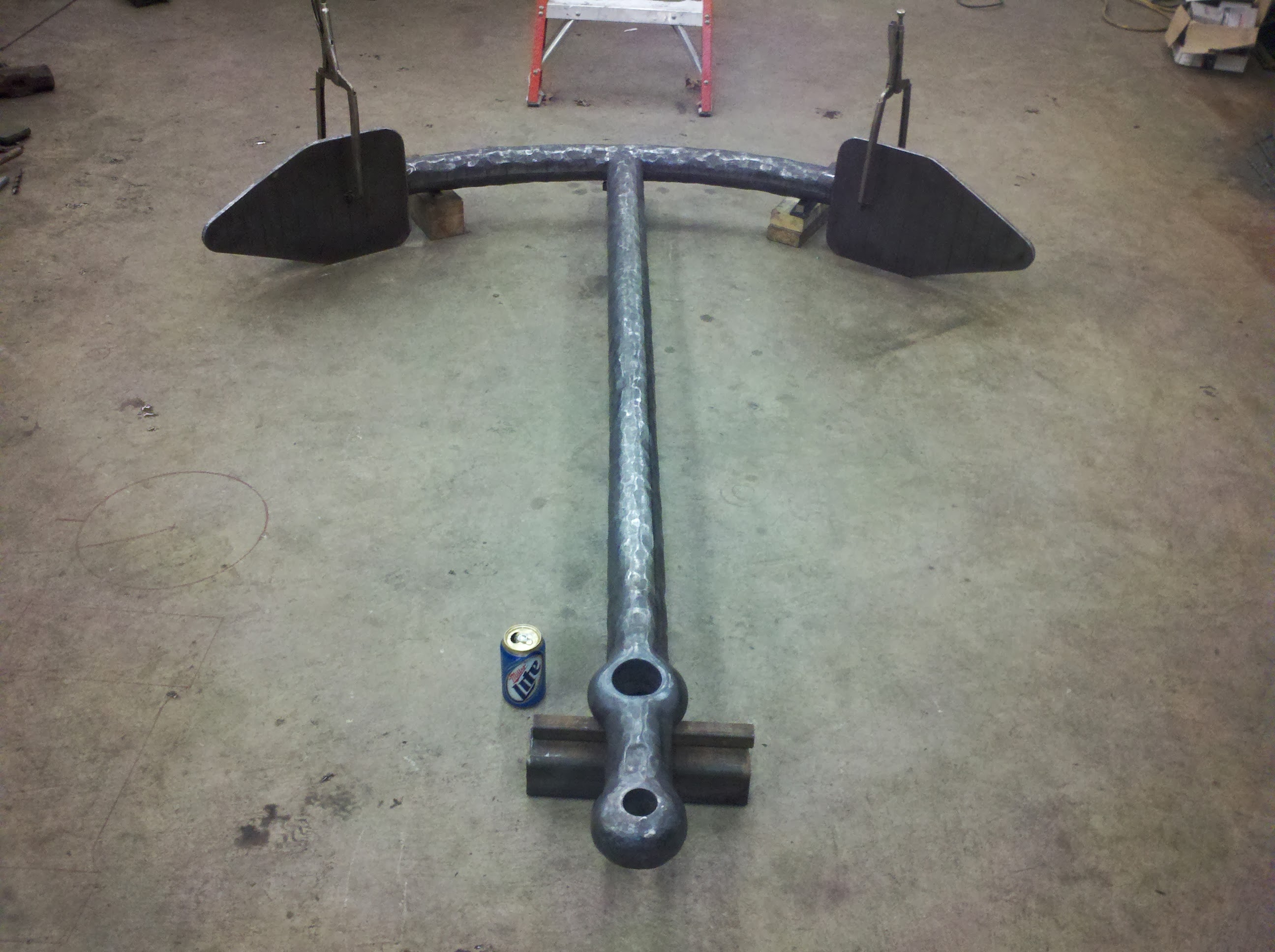

It's kind like using a hydraulic press to make this 7 ft tall anchor I made years ago, you can fool the machine to do things it didn't know it could do. As in the picture....making swelled hot punching openings in 3-1/2" pipe. And texturing pipe to look like texture on solid stock, and curving pipe.......all done on a 24 ton hydraulic press.

Joel - I agree with you as long as there is adjustments on the punch press - as you said no machine is a fix all - but like I said they can be used in ways that can accomplish things one wouldn't think of as their normal use. As in the above picture - the "punched/drifted holes" on 3-1/2" pipe - was done with my hydraulic press.....how - not punched/drifted - but Pulled. Opposite of normal thinking of a press.

By the way, that anchor's a really nice bit of drifting.
