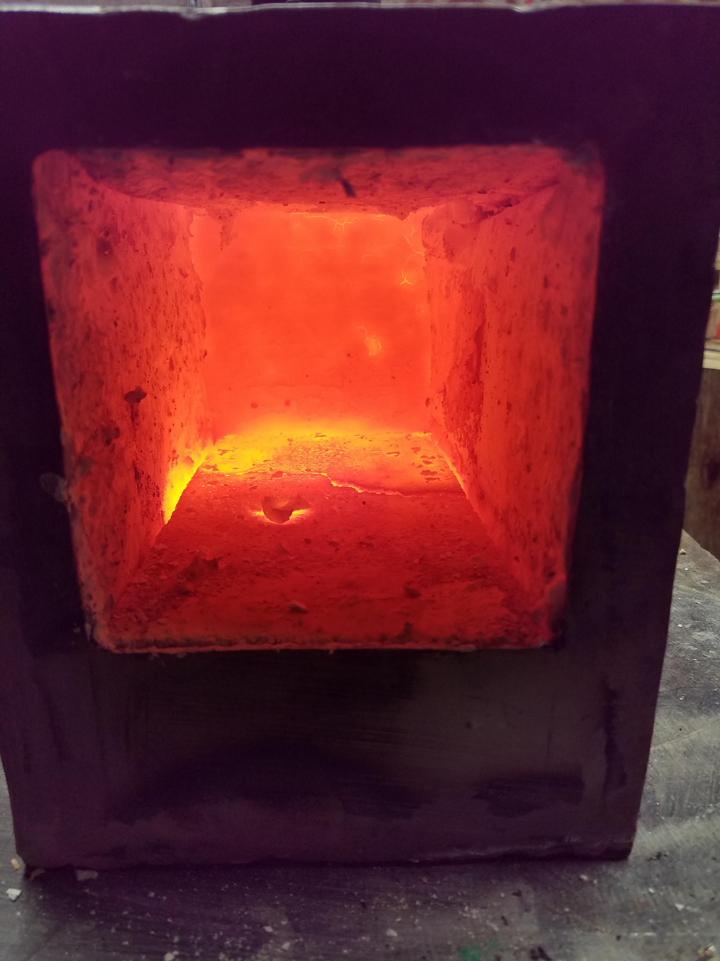

Made a 100g zircopax tile and a 100g cerium oxide tile today. I kind of botched the  cerium tile as I think I added too much water,  only drying will tell. With the extra mixtures I had leftover from making the bricks i coated parts of a foamy fire brick and fired the forge up.
20180329_225935.mp4
Kinda cool watching the patterns move on the cerium oxide patches. The cerium oxide turns yellow after it has been fired but reverts back to its Orange color after a couple of minutes.
The black flecks I can either assume is contamination from fire clay or the actual brick melting.

So my test tiles shriveled and cracked badly I used way too much water.
Can someone go into their process for mixing Veegum. Do you make an excess solution of water veegum that would say be 6% by weight them mix with the zirconium silicate. I tried doing this with 15 ml of water and it was a terrible failure.
However out of this failure I decided to fire the bits that I had left over in my forge.
The zircopax tile blew up but the fragments fired very very hard.
The cerium oxide again reached a yellow color outside the furnace for a short time but reverted back to Orange. the consistency chanced to A hard chalk compared to the fully glass zircopax. A note that the cerium tile started with almost triple the water but did not explode when heated. Areas around the cerium oxide stayed visibly red hot many minutes past shutting off the burner and removing from the forge.

So I fired a tile with a composition of 48.5% zircopax 48.5% cerium oxide 3% veegum t. It fired well however I dropped it and it broke into 4 pieces. The hardness is not quite that of pure zircopax however it still exhibited good thermal shock resistance I poured water on a chunk while still hot. If I could reach a higher temperature in my forge I may be able to get the full sintering hardness from the cerium oxide but the temperature is just out of reach currently.

As an update when I crushed two of the tiles they broke into splinters which would lead me to believe I have sintered them at least partially.
The back wall was coated in the 48.5/48.5/3 mix and makes a considerable show.
