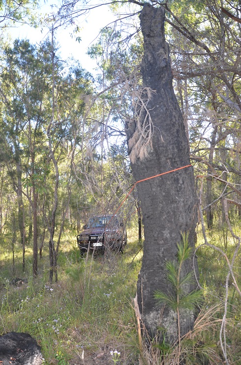

After today's demo the charcoal resources looked a bit grim, so it was time to venture out into the bush and find some. I usually have a ride around on the trail bike and spy out some likely sources and then go back in the 4WD and collect it. I look for hollowed out stringybarks or ironbarks which have been through the bushfires.

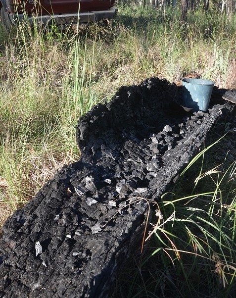

Sometimes you find a nicely dished out one lying on the ground and it's just a matter of shovelling up the charcoal pieces into bags. (Pics 1 and 2)

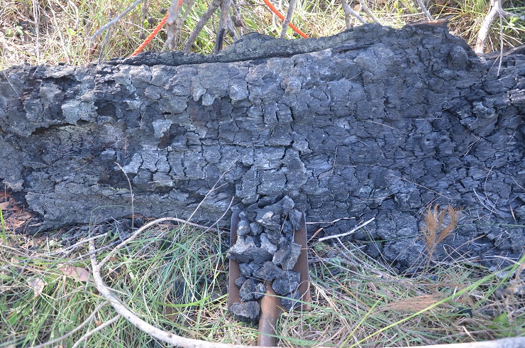

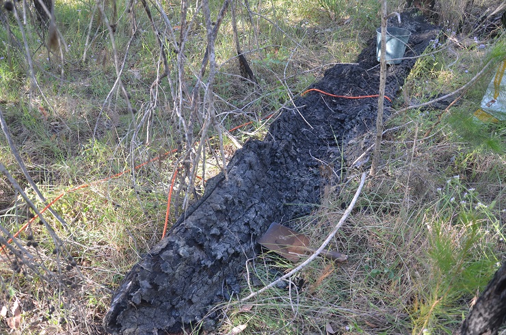

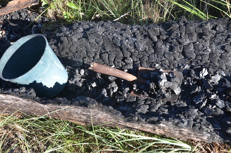

It is often easier to spot the tall hollow gums left standing after the fires and they are nicely coated with cubes of charcoal. It's always clean too, without sticks, leaves, sand or other contaminants. You just toss a rope around those standing ones and they don't usually take much of a tug to bring them down (Pic 3).  The crash often loosens the charcoal lining making it really easy to shovel into bags. (Pics 4 &5).
