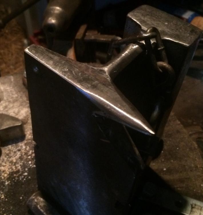

Charles R. Stevens Posted December 24, 2017 Share Posted December 24, 2017 Track if used in the vertical position is an anvil. ASO is a cast iron peace of extrament that is shaped lik a London pattern anvil. Quote Link to comment Share on other sites More sharing options...

Charles R. Stevens Posted December 24, 2017 Share Posted December 24, 2017 Other words, the web if a rail is about 7/8” even tho the head is 1-1/2”. So every time you hit metal on the head in the vertical direction you loose a significant amount of energy to flexing the web instead of deforming the metal. In the vertical position you have a 3x1-1/2” mass that is fare stiffer than the 7/8” web. Besides that it is fare easer to modify the web and flange for tooling than it is to carve out a horn from the head. Quote Link to comment Share on other sites More sharing options...

Charles R. Stevens Posted December 24, 2017 Share Posted December 24, 2017 Now to the next gueston that usually pops to mind... ”but the striking face is so small” google “Viking era anvils” and “Iron age anvils” I like image search. Disregard the junk and modern anvils and look at the historic ones. If you need to straiten your work, lay it down the face of the head and straiten, yes your puwnding sideways but it doesn’t take full blows for that anyway. not to toot my own horn, but here is an example of what can be done Quote Link to comment Share on other sites More sharing options...
