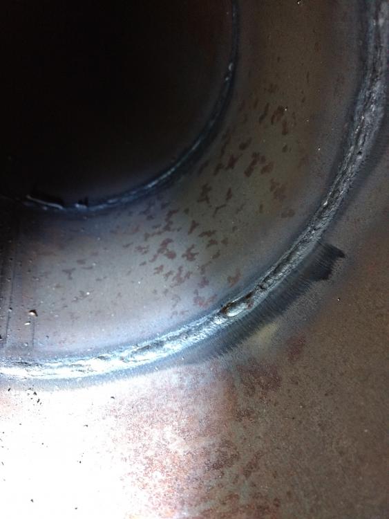

Donniev Posted October 30, 2017 Author Share Posted October 30, 2017 As you can see with the cold wire in the back, that weld was used to fine tune and adjust the welder, 2nd one is good Quote Link to comment Share on other sites More sharing options...
bubba682 Posted October 31, 2017 Share Posted October 31, 2017 Is the qc checking the roots before there shot cause i see a possible repair at 5.30 off the bottom it looks like the root is closing up on the side shot at about 3 o'clock these must be practice coupons are they.I think i'd wanna practice with that tip a little longer to get a bit more comfortable. Like anything else the more ya do it the better it gets its coming along. I wanna get one now to try, what schedule of pipe ya welding . Quote Link to comment Share on other sites More sharing options...
Donniev Posted November 1, 2017 Author Share Posted November 1, 2017 Schd 40 this was just a practice one. Were not going to put the root in with it, I'll root everything by hand other guy will hot pass and cap it all with tip tig Quote Link to comment Share on other sites More sharing options...
bubba682 Posted November 1, 2017 Share Posted November 1, 2017 I agree with ya on puttin the root in by hand that thing looks like a pain in the --- lol Quote Link to comment Share on other sites More sharing options...

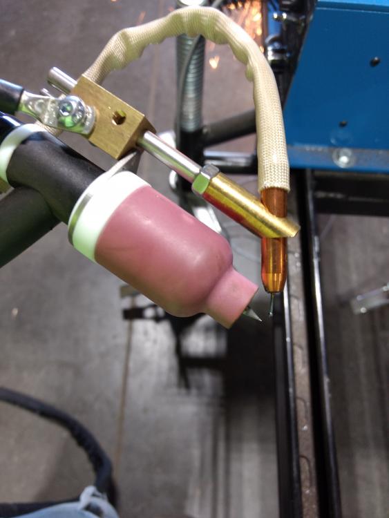

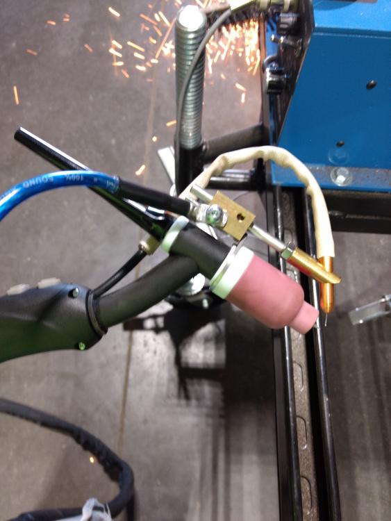

Kozzy Posted November 1, 2017 Share Posted November 1, 2017 Interesting and sorry I missed the post when it originally came around. I am looking into exactly the same thing for a semi-robotic TIG application I need to do. Unfortunately, I have to do it on the cheap so will end up using the crappy Chinese versions of the wire feeder. Hoping that it works out---will be using a brand new miller welder for the power supply (can't go cheap there) Instead of a running bead, I need to make a series of tiny spot fillet welds along a 3/16" dia T304 SS rod. The guy doing the welding by hand now is actually getting carpal tunnel problems from the repetitiveness of the job--5 or 6 thousand little spots a day. Although I'd rather pay a guy than pay for a robot (work is about people, not just profits), it just has to happen for health reasons. Anything I should know about those TIG cold wire feeders which isn't obvious until you start gaining experience with one? Quote Link to comment Share on other sites More sharing options...
Donniev Posted November 1, 2017 Author Share Posted November 1, 2017 Nothing comes to mind immediately...most of it is getting used to the weight of it, the other battle is fighting the tungsten/ wire distance, it has to be a perfect 1/8". Also we change tungsten frequently...since carbon is so dirty if any impurity gets pushed out near the tungsten it grabs on, and this isn't like doing it by hand, can't continue even with a slightly dirty tungsten. Has to be perfect...not sure if that'll help you too much or not, but that's all I can say on this so far Quote Link to comment Share on other sites More sharing options...
Kozzy Posted November 1, 2017 Share Posted November 1, 2017 Thanks. Anything helps. We're going to use a pencil torch with a gas lens and it won't be handheld. I had already considered the issue of keeping the tungsten clean and consistently sharpening for repeatable results---something I have to get the crew to keep up on if this is going to work. The welds are so small that slight inconsistencies in process will bite me. Biggest shop problem I tend to have is inertia: People resist changes quite strongly..and when finally onboard, complain "why did you force me to do it the old way for so long?" Quote Link to comment Share on other sites More sharing options...
