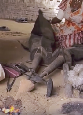

Glenn Posted January 12, 2018 Share Posted January 12, 2018 A simple side blast forge. Quote Link to comment Share on other sites More sharing options...
Charles R. Stevens Posted January 12, 2018 Author Share Posted January 12, 2018 All one needs is a thrall or two Quote Link to comment Share on other sites More sharing options...
Glenn Posted January 12, 2018 Share Posted January 12, 2018 Build a side blast forge and get to work https://www.youtube.com/watch?v=T5hHtuAUPU0 Another side blast forge with bellows Quote Link to comment Share on other sites More sharing options...
