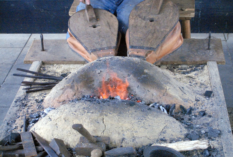

You will have to clay the forge to effecently use charcoal, as in a bottom blast configuration you need a couple inches more depth. Further, unlike coal you want to use the smallest practical pile of fuel. Unlike coal, easy excess fuel will light and burn wile not adding to heating the work.
With your forge I would consider cutting a pair or 4" angle pieces to nerrow your fire bowl and form a trench, then use a few or Adobe to deepen the pot and form a trench to contain the fuel piled over the work. Adobe is nice because you can carve it if you need to lower the stock after you fire it up. Another trick is to prop open the ash dump, sometimes you just can't crank slow enugh to satisfy charcoal.
One of the other members has a rivet forge they have adapted wihth Adobe to burn charcoal, I just can't find the image.
A person could configure their rivet forge in the same way with split fire bricks propped in a V shaped trench. I've used pieces of angle iron  down over the air grate to redirect the blast when burning charcoal. Charcoal likes side blast much better than bottom blast, a deflector isn't perfect solution but it helps. Making one from split fire brick and clay lasted a lot longer than the angle iron and made a decent charcoal fire.

Mr. Stevens that is a solid hat sir, top shelf, and I really like the forge setup in the picture.

On August 22, 2017 at 9:42 PM, Charles R. Stevens said:
I would recommend flexible exhaust pipe or even rigged pre made bends to mate the two. I recomend you learn to forge roses to appease the Missis
I second this recommendation.  The cost of stainless exhaust flex hose (the heavy-walled stuff) is a bit of a turn-off but it'll be a one-time buy you will never have to revisit or regret.  Just make sure you like the location of the blower relative to the forge before buying and cutting the good stuff--so maybe temporarily go with ultra cheap dryer hose until you get a feel for where you like the crank sitting relative to the forge.
Well, that is one of our other members setups, i did not have time to find the picture I Was looking for but it gave you the general idea. The first clue as to charcoal forged iron work is aproximent ply 6" twists. So that gives you an idea what we need to aim for with charcoal. The typical side blast tuyere was 3/4-1". 3/4" schedual 40'pipe is about 7/8", and will comfortable heat 1". Bigger fires required multiple tuyere and generally (but not always) multiple bellows. i have seen primitive clay mining operations. Lots work and water go into cleaning clay for pottery, then a suitable grog is required, crushed fired clay being one of The best choices. It's interesting,
