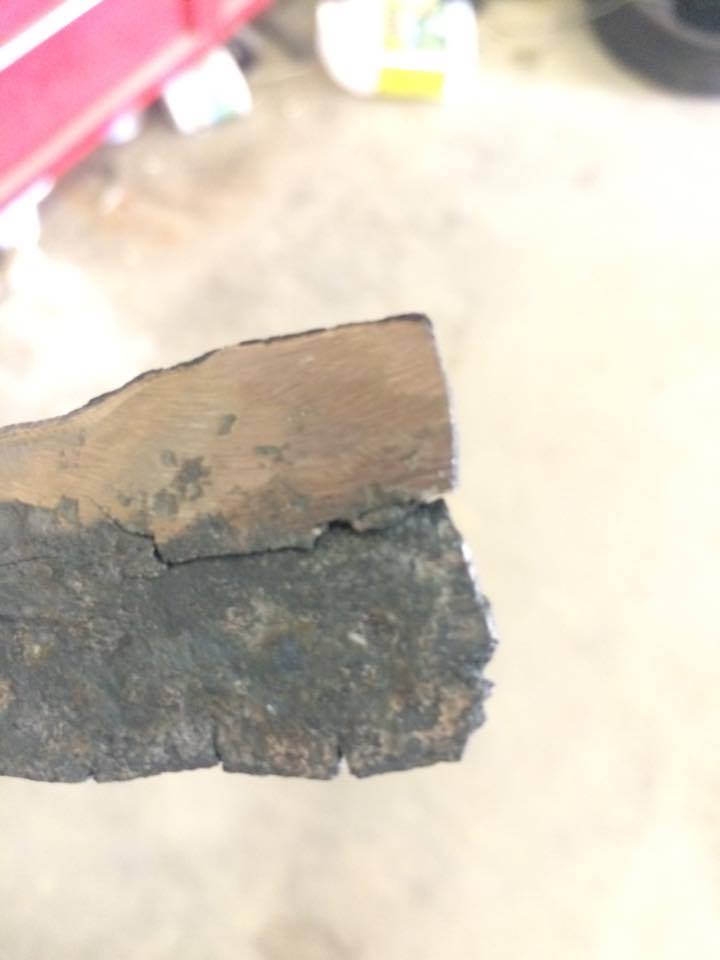

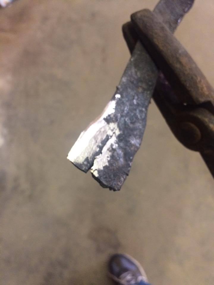

Well I got out and spent a 40 minutes on a small section, just to see what happens. It is fairly strong stuff, and I think it has an odd heat tolerance or I hit it too hard. It got no thinner than 1/4" and started to split down the middle. could just be a weak part from when it was cut off. I will have to try some of the bigger pieces to see if i have any luck. Pictures incoming.
Notes: It doesn't cut hair, but cuts boxes fine. Could be a box cutter maybe as it is lol. I will definitely try a bunch of heat treat options if I can scrounge up the different types of oil and such. I got all my life to do this so :)

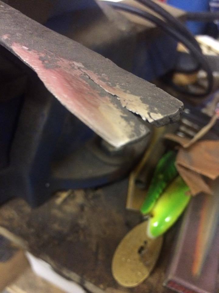

I took the more solid side of the split side, ground it down a little more after forging it to the point where I thought if I hit it anymore I would just make it worse. it's about 1/8" at the thickest part now. I just did water from an orange / bright red color at that tip part.
It's all I have for tools/sandpaper right now, so I am not expecting a master blade edge HAHAHA

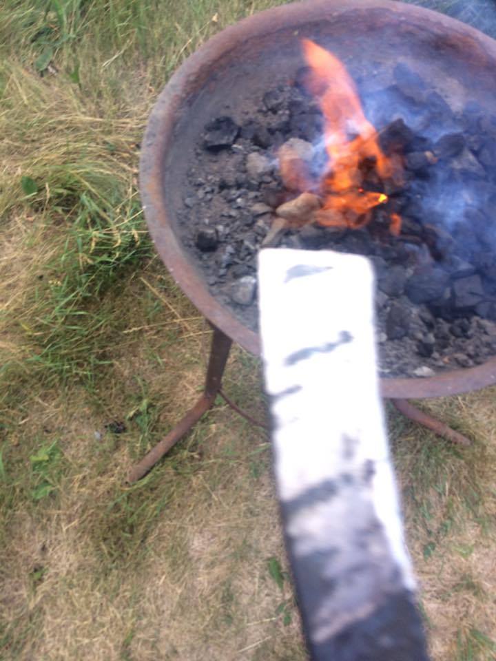

looks overheated; how deep is your fire?  So you have at least 4" of charcoal under the workpiece, (real charcoal not briquettes!)
Ya my forge is too shallow to be working with anything too big. I am running low on charcoal as it is, gotta get some more. But no, I have maybe 2" below it at the most. I had almost no air going into it just because I didn't want it to get too hot too fast. Probably still not enough, need more insulation between the fire and the metal I guess.
I really have to consider making a new forge with those pyramidy shaped pits. :/
My forge is basically a 40 yr. old lawnmower turned upside down.
too much O2 helps make thing steel "crunchy" as well.  Some alloys have very narrow forging temperature ranges.
Hmm okay. I will take mental note for the next piece I try. Maybe next week, gotta get some Coal from the guy I got some last year. Two 5 gallon pails lasted me about 10-12 forgings of small stuff in a year. So I should be able to get by with another two pails for maybe half a year or more :)
Yeah, that looks like a high manganese alloy alright. From the days of taking hard facing classes comes the warning that manganese alloy steels have a strict time and temperature limit. It's kind of funny stuff, more than a small % and the steel will fail if kept too hot too long and you can vary either to the same effect. Too hot for a short time and it breaks or not so hot for longer and it breaks. There's a threshold temp according to % but exceed it's limit and it breaks.
I was more interested in hard facing drill bits and drill steels so manganese wasn't an issue, it was however a big part of the class. Lots of rock crushing equipment is high manganese and requires hard facing regularly. Some of the methods to control heat sinking into the base steel were pretty impressive. Huge crusher drums in water baths with barely a couple inches exposed to weld. The beads were run over amped and fast Fast FAST. Long skinny beads in multiple passes, run, skip a space run another and go back. Never run next to or touching the previous one.
Anyway, Exceed manganese steel's time/temp limit and it breaks, seconds, sometimes hours even days later. Looks like your pics.
