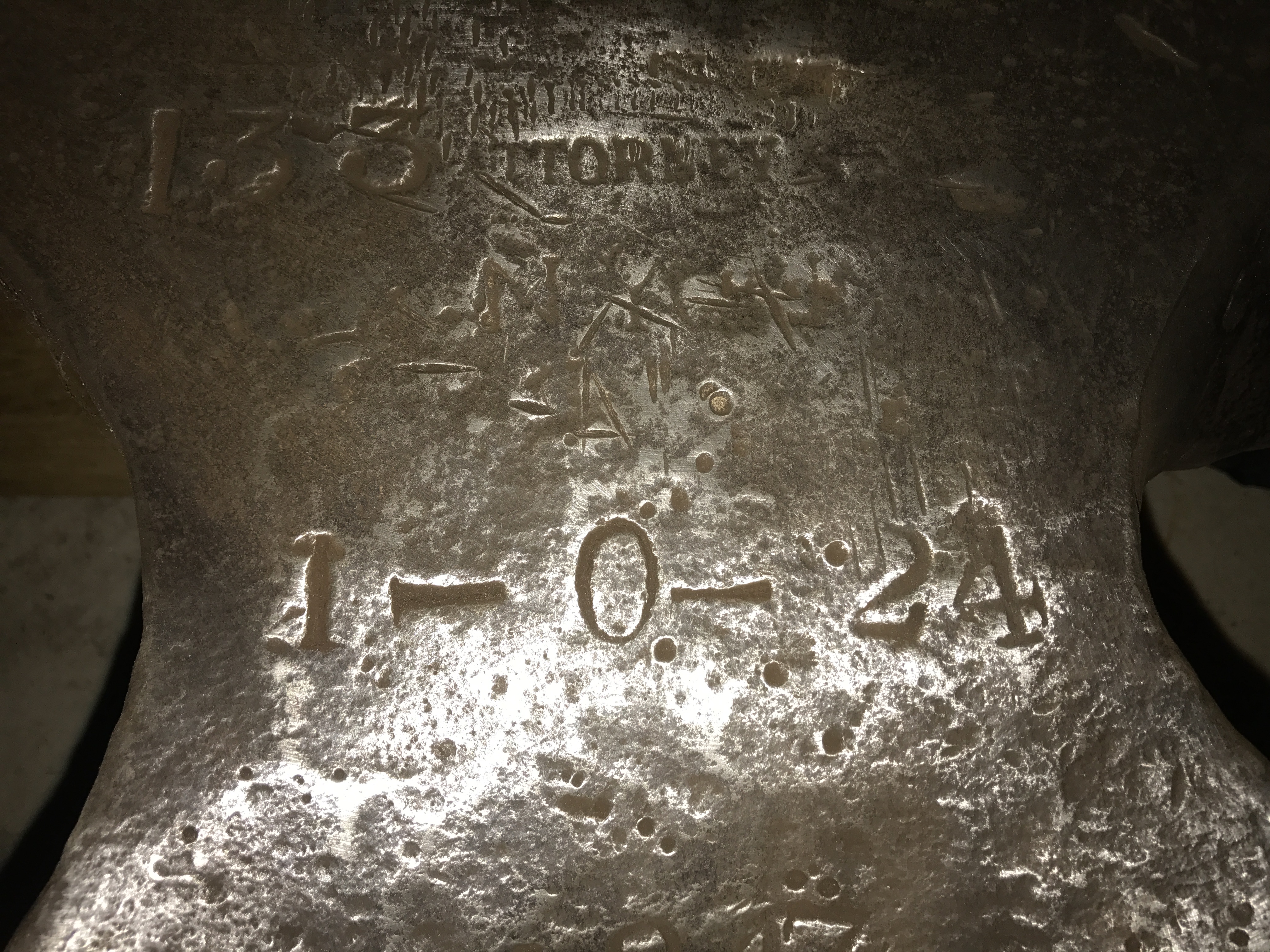

Ok, So I picked up this anvil that was advertised as a Peter Wright. I don't think it is but hoping somebody may have an idea of if that is correct or hat it truly is. I took a scour pad to the side to help the markings come out. I can read attorney, 1847, 135,1-0-24. I couldn't find any other numbers or marks anywhere else. Doe anybody have an idea of who the manufacturer is. It rings in the center and seems to have a good rebound. Let me know what you think. Thanks
William Foster is one of the few early anvil makers that used to date their anvils; anybody recall any others dating back that far?
Thanks. Any idea why the word attorney would be there. I would guess something to do with patent but that's just guessing
You might want to contact Richard Postman, author of "Anvils in America"; as he has learned of a lot more English Anvil Makers since the first edition came out.
Every time I have met him at Quad-State he was happy to help with anvil IDs.

You have an Old English style built up anvil made by the New York City leg vise maker Joseph Goldie. He made more leg vises than anvils, but a few are around.
he made anvils and vises in New York City around 1840-1850
Wow 101 H-B,Just when I think I have read on this forum about all the different makers of anvils and vises along you come with a new one to me! Thanks for your knowledge and input!!
It is very cool when a Goldie anvil comes up, great to see!!  Thanks for the pics!
What was the definitive mark or characteristic that ID's it?  Please
They stamped their address right on the side, 133 Attorney St.
