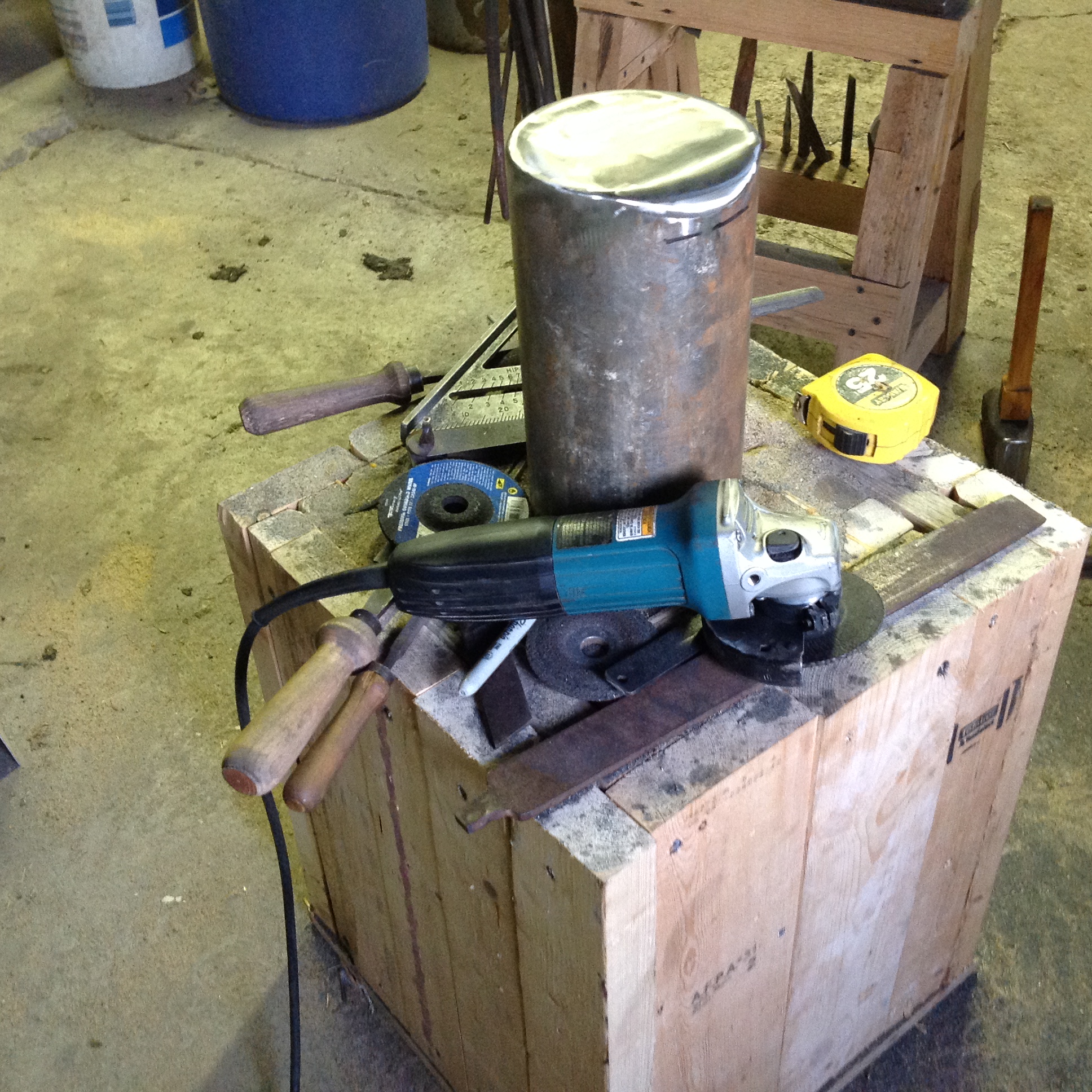

Friend of mine who is a local blacksmith found this 5x5 square stock for me at a junkyard and it's about 4ft. Long. I bought it off him for 10 bucks and has alot more rebound than my railroad track and I was wondering what would be the best way to mount this? Upright like a post anvil?or horizontal? and weld some legs to it? I asked him and he said it's really personal preference but he is not sure. He has never used a post anvil or anything like what is pictured as an anvil and he didn't want to really tell me anything wrong. So I'm asking

I have a post anvil like yours.  I set mine on 2pieces of 3/4 plywood ( base ) and then came up with 2" scrap.  I staggered the wood and not all goes full length.  Then I started filling with sand. By the time I got done I have better then 100# of sand in the base.  It is very stable.  If this one fails the next wooden base will not be as tall.  One benefit is I can use the "side" of the post to straighten pieces or as a fuller or rounding surface.  I have not given up on finding a London pattern anvil but I'm not spending a lot of time looking.

Well I really only have one of those sorry I didn't mention that before I just noticed the picture included the 2nd one, the other he sold to someone else. I'm thinking about cutting about 12in. Off of it and having a post anvil and then using the remaining 3ft. As an horizontal anvil. We didn't have a way to weight them but it took 2 burly men to pick it up.
Steel weighs about 0.28lbs cu/in your bar weighs about 7lbs. per linear inch. Soooo, 12" will weigh about 84lbs.  nice bench anvil size.
