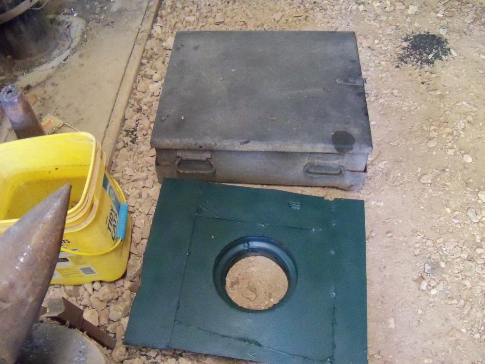

Irondragon Forge ClayWorks Posted April 19, 2018 Author Share Posted April 19, 2018 3 hours ago, Adair said: In the attached image you can see what is left of the forge I've been asked to reconstruct. Looks like you can use the hardware & legs. I just measured the thickness of the box and lid. It is 10 gauge sheet metal welded at the seams. Quote Link to comment Share on other sites More sharing options...
Adair Posted April 19, 2018 Share Posted April 19, 2018 Iron Dragon, Thanks a million. This forge belonged to my friends grandfather and he would like to be able to use it again. Very interesting to know that it was welded. I was hoping to rivet the corners! -Adair Quote Link to comment Share on other sites More sharing options...

Irondragon Forge ClayWorks Posted May 24, 2021 Author Share Posted May 24, 2021 I just realized Photobucket (tinypic) has deleted all the early pictures, so I'm adding them here. Thought other members who just joined might enjoy them. Quote Link to comment Share on other sites More sharing options...
