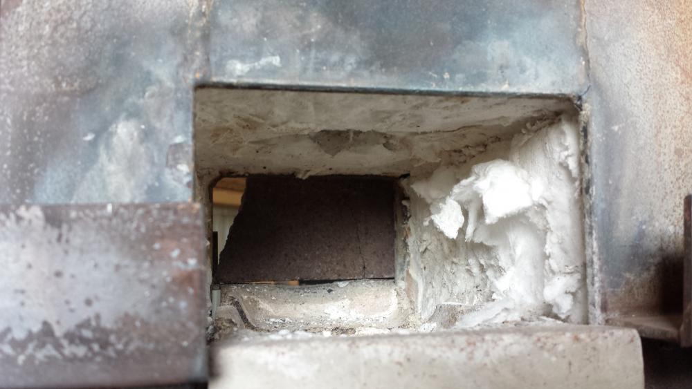

Used the forge today to heat some thin steel to form into a handle for an art box for my dear wife :)
It worked nice but I noticed during use that the ceiling inside has sagged alarmingly.
The overall construction is a firebrick shell lined with Kaowool which is then covered in a layer of furnace cement and then painted with Metrikote.
By the look of it the Kaowool has separated from the brick and caused the whole thing to sag. It still works but I feel I am now wasting a lot of heat inside the cavity which has formed between the brick and the wool, not to mention probably melting and vaporizing the wool (which I know is a bad thing)
So I am considering rebuild options. I have read the stickies and considered the various combinations of materials and wonder if rigid Kaowool sheeting lining the brick which is then coated with Metrikote would work? Do I really need a castable refractory if the brick shell and wool sheeting are rigid already?
So many variables and options involved here and I have tried to do due diligence by reading many many posts but still not clear on the exact role of the castable refractory. I do not plan forge welding in this one so protecting the wool from dissolving in flux is not required. I would use a thin piece of firebrick as floor so damage to the Kaowool also not really an issue.

Can you deign to tell us if this forge has a flat ceiling or is the firebrick mitered into an arch?
If it's flat you can hold the kaowool up using oxidation resistant wire ties.
If it's arched you may need to use a slightly bigger piece of kaowool to put it more in compression.
Flat, it is basically a cubic box made of firebricks stacked two high for sidewalls and the one thick bridged across them as a roof
So are you saying it is OK to have Kaowool immediately in contact with the hot forge interior gases?
I don't see where I said that at all could you point it out to me?
I did say you can pull the kaowool back up against the roof bricks using oxidation resistant wire ties to hold it in place.  A  method used in industrial settings.

Hi EnglishDave, I have included a picture of my 1.5 year old store bought forge.  It came with just an uncoated ceramic blanket which I used for about 9 months.  At that time I coated with Metrikote which only helped for a short while.  My answer to your question .....  " is OK to have Kaowool immediately in contact with the hot forge interior gases?" is two fold.  First it is ok to do it that way, it will not kill you (from what I have read) and the forge should work to at least orange heat.  Second, it is safer to coat it, as ceramic blanket does give off microscopic fibers that can linger in the air of your shop for a long long time,  My forge is in a simi outdoor area so I put up with the uncoated situation for a time, but as you can see from my forge the blanket takes a beating during use.  I felt my forge was already too small and coating with refractory would have made that problem worse, now after building a new forge I think I should have tried a 1/4" layer.  I am not sure if your forge is made to be adjustable?  If so Kaowool blocks may be the answer, but they are fragile, they give off a power when broken, I have a case so I know from personal experience.  Hope this helps.
Yes very helpful thanks. I think I am going to strip out the cement and fiber blanket from inside mine and start over, the blanket will probably be junked because it has the cement stuck to it (and was free anyway as I recycled it out of our old electric stove) and then replace the fiber with some new stuff and probably rigidize it as I have read about in here then cover it in Metrikote ( I have enough of that left from the first build to cover it I think)
I do not plan forge welding at this time so flux damage is not an issue but I did wonder what you have as a forge floor? I do wonder about both direct flame impinging on the blanket burning it up and also just the physical strength required to lay the work piece on. I currently use a thin slice of firebrick placed loose in the bottom of my forge as a disposable flame guard for this purpose and that seems to work well.

Well, there is no hard and fast answer to that question. For one thing, what kind of a hot-face layer is laid over the insulation mainly depends on how someone plans to run the forge; beyond that there are a lot of druthers involved. Generally, people like doing things their own way. So any issue that doesn't present a choice of right versus wrong way generates a lot of conflicting opinions; this here is a classic case of druthers being the main factor.
So, how does it look to you? You're absolutely positively right on the money! Well, kinda sorta...so far as it goes;)
