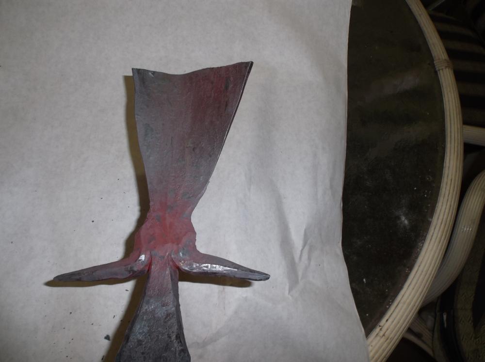

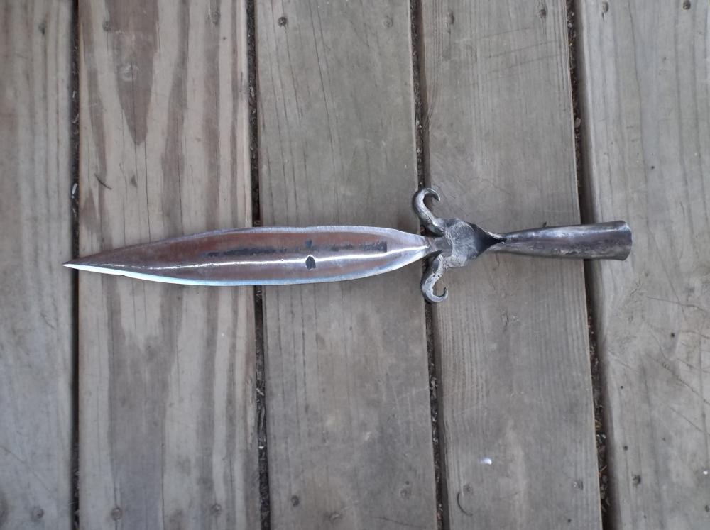

Hi, my son and I are new to blacksmithing and knife making, and its absolutely grabbed us. We're lucky to be able to use a 200 year old original double bellow pig skin forge made of convict blocks on Norfolk Island, we make our own charcoal in drum and everything - very cool. Like others we've tinkered with knives, pokers, bottle openers but would like to make a replica whaling temple iron and even though we don't agree with whaling, whaling is a major part of Norfolk Island history from the 1950s, but even after lots of attempts and frustration (we don't have a teacher) can't make the cone which connects the iron lance to the wooden handle. Can anybody give us some guidance? It would be very much appreciated.... thanks in advance.
For cones in general, measure the circumference of the smaller end of the cone, the circumference of the larger end of the cone, and the length of the cone. Transfer these measurements to paper using an imaginary center line at the midpoints of the circumference. Circumference lines should be perpendicular to the center line. This will give you a visual on paper of what material is needed to make the cone.
Decide now smooth you want the cone. More is smother, less is not as smooth. To pick a random number (say 10) divide the smaller circumference line into 10 equal segments. Do the same for the larger circumference. Now draw a line from the small number 1 mark, to the large number 1 mark, and repeat for the remaining 9 points. Bend on the lines to make the cone.
This will butt the two edges together when finished. You may want to leave additional material for overlapping if that is needed.

Cool projects;  you can forge the lance as if it was a candle holder, or something with a leaf on the end, et cetera ,  drawing out the "cone" material on the end of your material opposite the finial/poker end. If it is to be one piece.
You'll need the bossman's geometry above in any case , but if the cone is independent of the staff and the spear  (3 pcs total) there are multiple options. Paper/flexible templates are a huge help. If the spear pictured is available,  you can make a pattern from its cone: wrap it with saran wrap/cling wrap,  tape over the cling wrap with fiber backed shipping tape  (all the way around, criss-crossing the tape), then carefully cut the pattern off exactly the size of the cone.

I'll add this, I personally believe it would be easier to forge weld the material for the cone to the spear point than forging the cone out of a single piece. trying to forge a cone out of 1" material is not fun.
I would make the spear and the cone separate, and the cone I would forge out of a pipe and then forge weld it onto the spear
Hi Wayne, thanks for that. We're new to this so say no more, but we tried a dummy run a few days ago and while didn't struggle to forma shape to cone, had issues getting enough 'cone' out of the steel shaft we were using. From a traditional harp we got our measurements from, the wooden harpoon handle is 30mm wide and the harpoon shaft is 10mm steel. Works well as both are size of steel and broom handle we were able to get our hands on.

Too bad that you are so far from east Tennessee.  You could come by for a visit and some forging.  That was done from 6" of 1" square.

one trick for cones is to upset the starting stock a bit by heating the end and pounding it vertically on the anvil face giving a sort of anti taper and so putting the most metal where you need to draw it out sideways the most.
