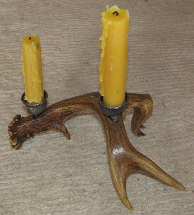

rwolfe Posted October 27, 2016 Share Posted October 27, 2016 Cups for candles are a pretty obvious use. Here are some interesting (aberrant) antlers that I used to make candlestick holders using pipe for the cups. Quote Link to comment Share on other sites More sharing options...
nkearns Posted October 28, 2016 Share Posted October 28, 2016 Thanks olfart and rwolf those look like fun projects and I actually have a bunch of antlers laying around Quote Link to comment Share on other sites More sharing options...
