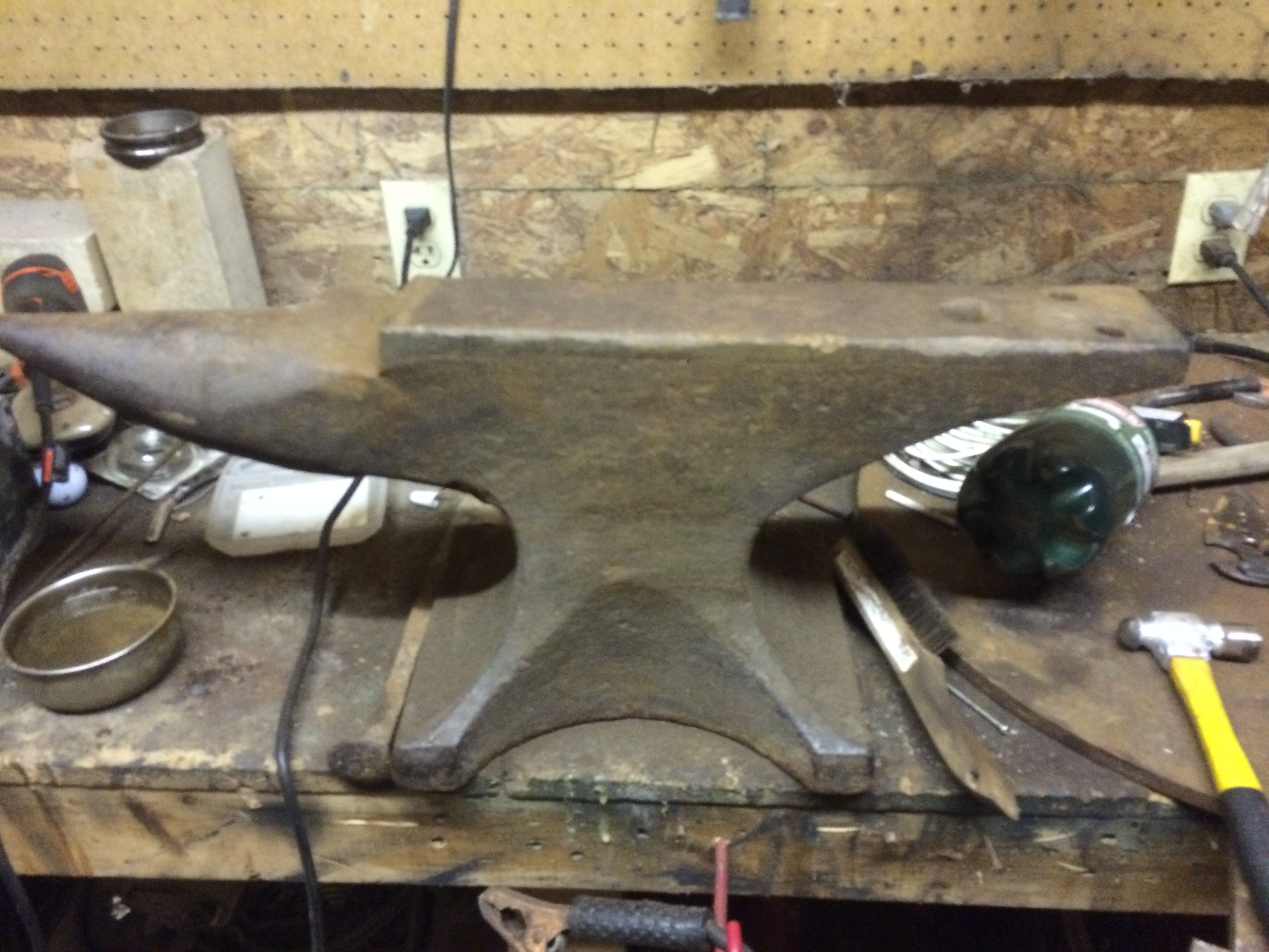

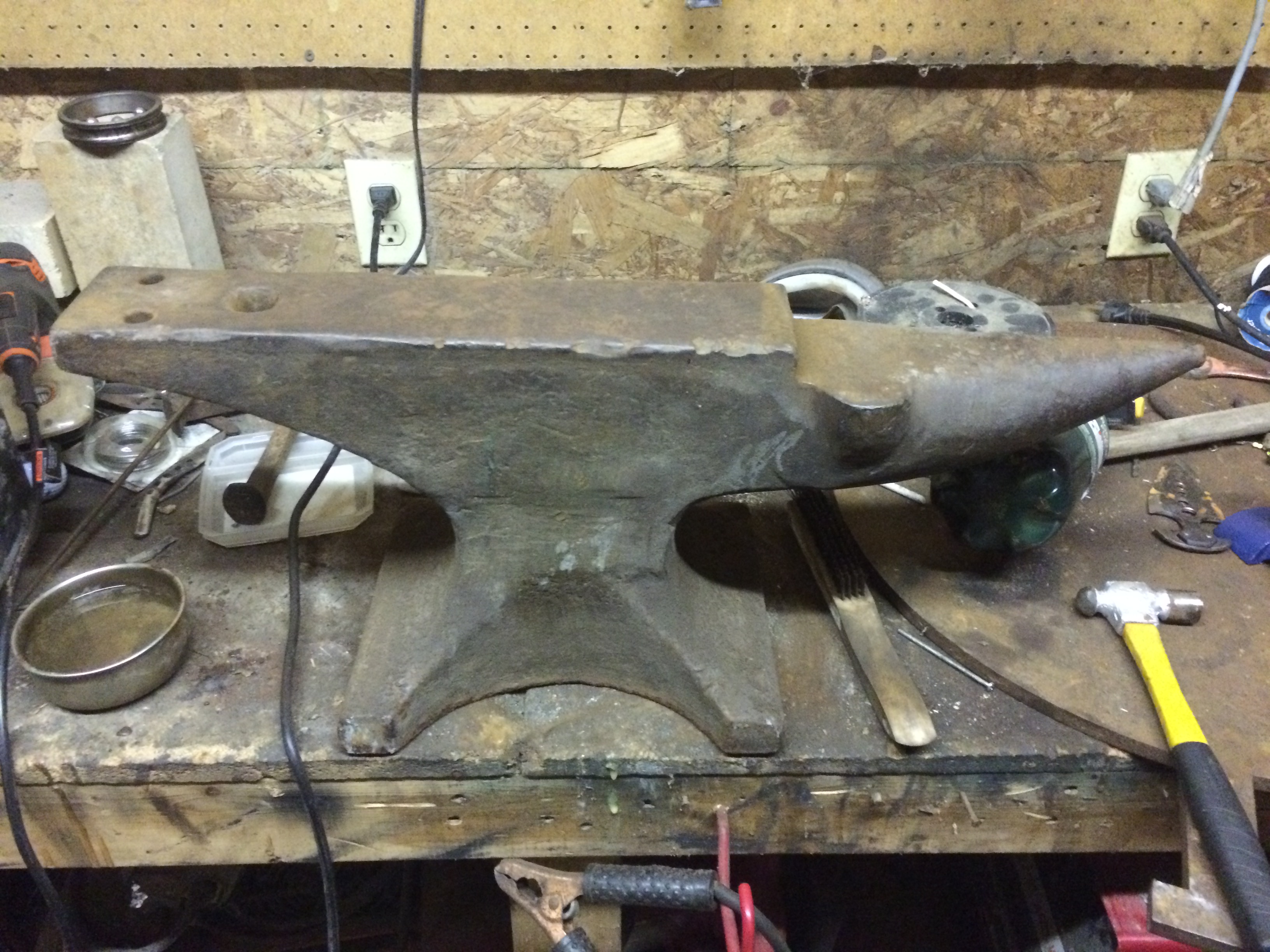

paradox1559 Posted October 20, 2016 Share Posted October 20, 2016 This is my first real anvil, and I'm so excited. Could someone help me identify the maker of this anvil? It came from Indiana and it is at least 60 years old according to the man I bought it from, he says it's been around since he was a kid. I cannot seem to find any makers Mark's or any numbers At all. Quote Link to comment Share on other sites More sharing options...
Fatfudd Posted October 20, 2016 Share Posted October 20, 2016 Nice looking farrier anvil. If you could post some pics of the underside of the base and under the horn we might be able to help. Quote Link to comment Share on other sites More sharing options...

JHCC Posted October 20, 2016 Share Posted October 20, 2016 Also, don't be so quick to assume no maker's mark, especially with an older anvil that shows its mileage. I'd owned my anvil for thirty years before I realized that there was a maker's mark on the side. Try looking at the side from a very low angle, with a single light source at an equally low angle. Who knows what you might find. Quote Link to comment Share on other sites More sharing options...
paradox1559 Posted October 20, 2016 Author Share Posted October 20, 2016 Would it be out of line to hit it with a wire wheel? Quote Link to comment Share on other sites More sharing options...
JHCC Posted October 20, 2016 Share Posted October 20, 2016 15 minutes ago, paradox1559 said: Would it be out of line to hit it with a wire wheel? Not at all. Resist the temptation to take a grinder to the face, though. Quote Link to comment Share on other sites More sharing options...
Black Frog Posted October 20, 2016 Share Posted October 20, 2016 Most likely a Trenton, could possibly be A&H. Take a closeup pic of the side of the anvil, horn facing right, I think I can see some faint marks in your pic above. Also look on the front foot under the horn for serial number. Quote Link to comment Share on other sites More sharing options...
ThomasPowers Posted October 20, 2016 Share Posted October 20, 2016 Also look under the heel; Arm and Hammer anvils are distinctive in that the underside of the heel often shows the steam hammer hammer marks rather than being dressed flat. Quote Link to comment Share on other sites More sharing options...

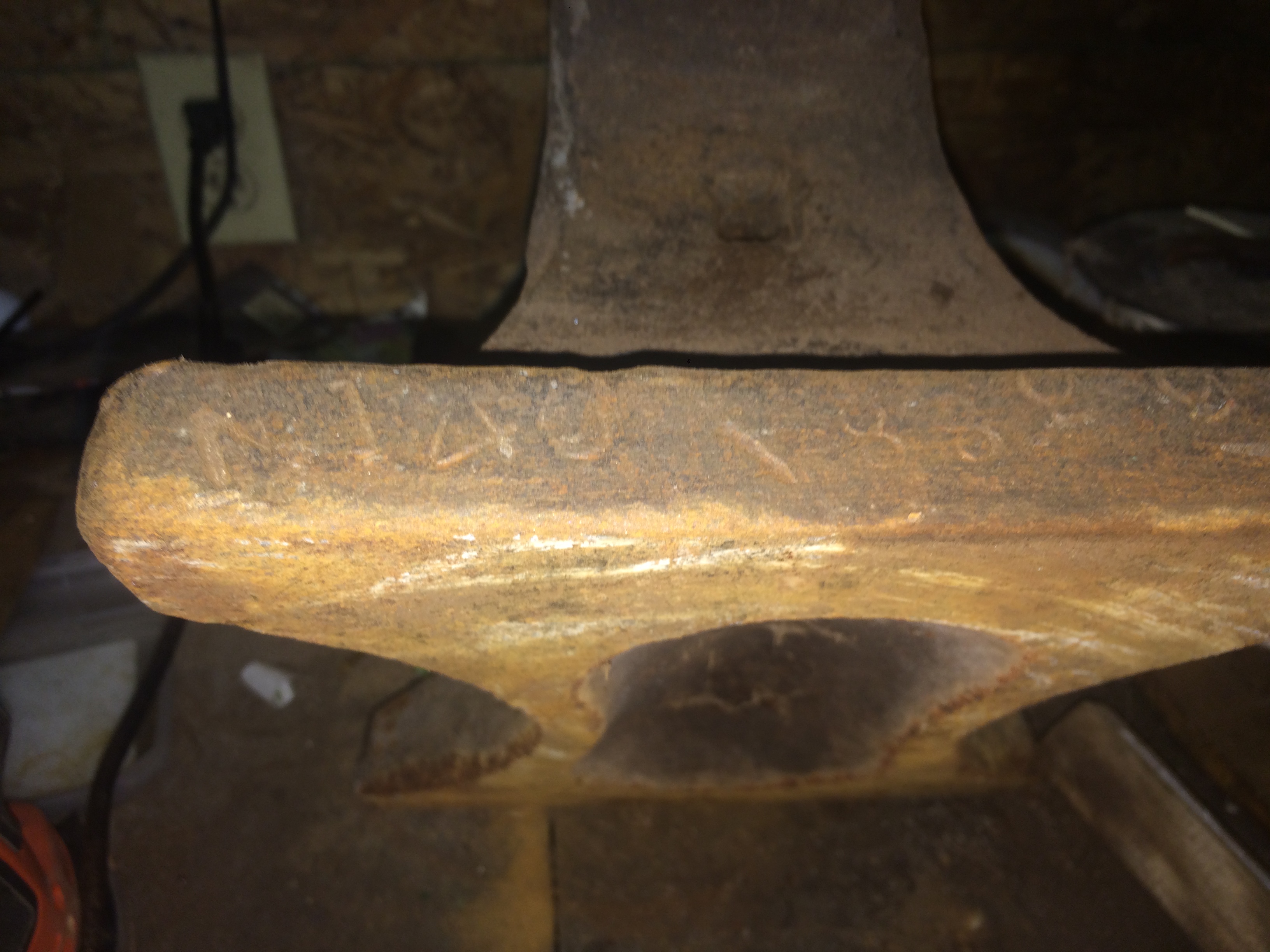

paradox1559 Posted October 20, 2016 Author Share Posted October 20, 2016 Not sure if it's comming through, but it looks like a little arrow, followed by 140 1880 96 Found under the horn Quote Link to comment Share on other sites More sharing options...
ThomasPowers Posted October 20, 2016 Share Posted October 20, 2016 Left hand number is the weight, right hand number is the serial number NOT the date. Caplet depression is generally a Trenton but can be Arm and Hammer as they sometimes shared basses---both manufacturers were in Columbus OH, USA Someone collocated with their copy of Anvils in America can give you a date associated with that serial number. Quote Link to comment Share on other sites More sharing options...

paradox1559 Posted October 20, 2016 Author Share Posted October 20, 2016 Thanks for the help everyone, it's always good to know what you have. Is there a way to find its age in the serial number? Quote Link to comment Share on other sites More sharing options...
ThomasPowers Posted October 20, 2016 Share Posted October 20, 2016 Always read to the end of a post: "Someone collocated with their copy of Anvils in America can give you a date associated with that serial number." Quote Link to comment Share on other sites More sharing options...

Black Frog Posted October 20, 2016 Share Posted October 20, 2016 Some Arm & Hammers are quite smooth on the underside of the heel. And some marked Trentons look very choppy under the heel like A&H's. That is a Trenton anvil. Anvils In American lists it as 1924 date. Can you post a closeup picture of the side of the anvil (horn facing right)? there may be some faint stamping, that serial number and logo are important to me for the Trenton logo database. Thanks! Quote Link to comment Share on other sites More sharing options...

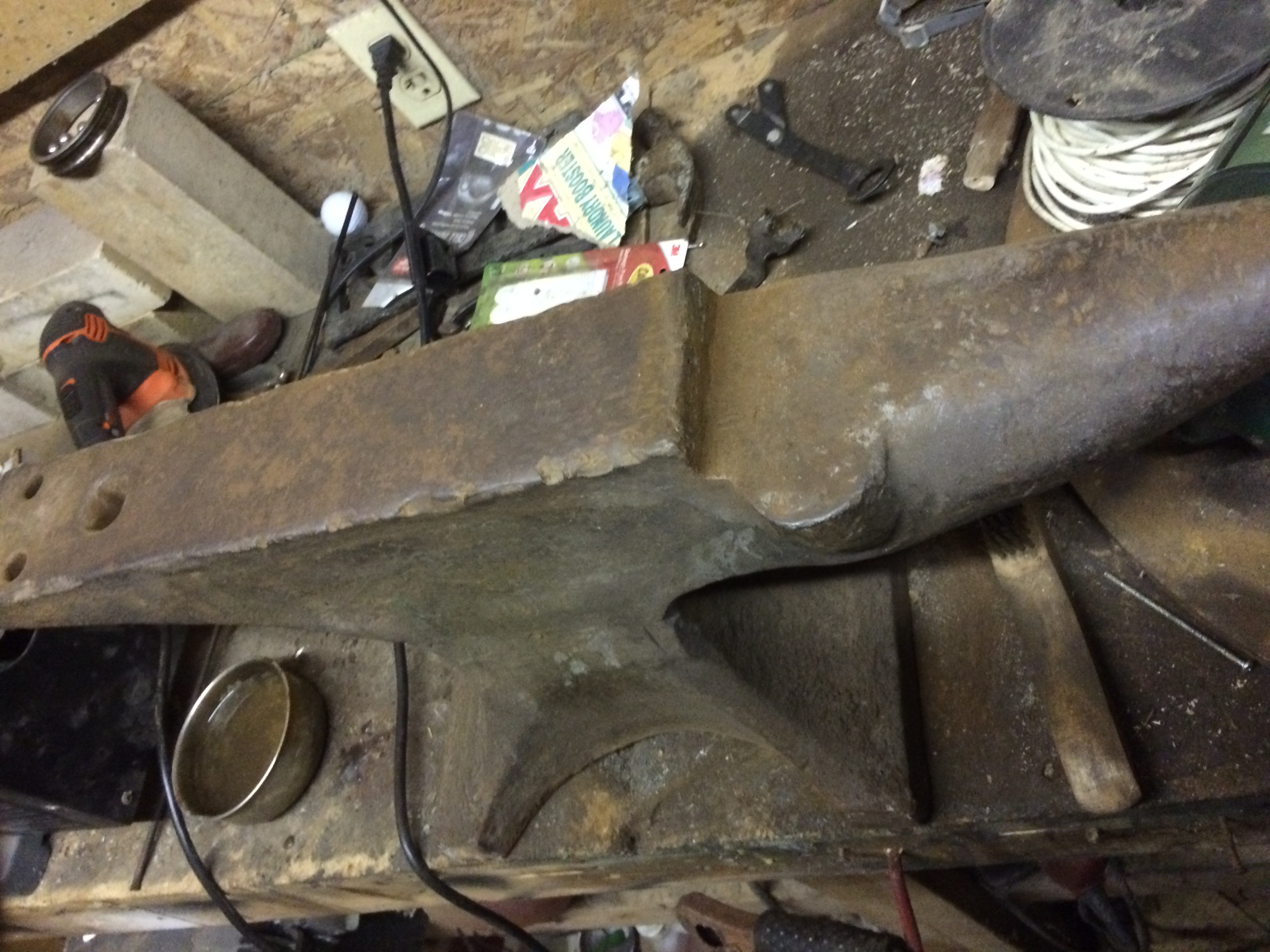

Daswulf Posted October 20, 2016 Share Posted October 20, 2016 I faintly see the lower half of the diamond that the Trenton name is stamped inside of in the 3rd picture. My Trenton was like that with only the upper portion of that diamond showing. Quote Link to comment Share on other sites More sharing options...
