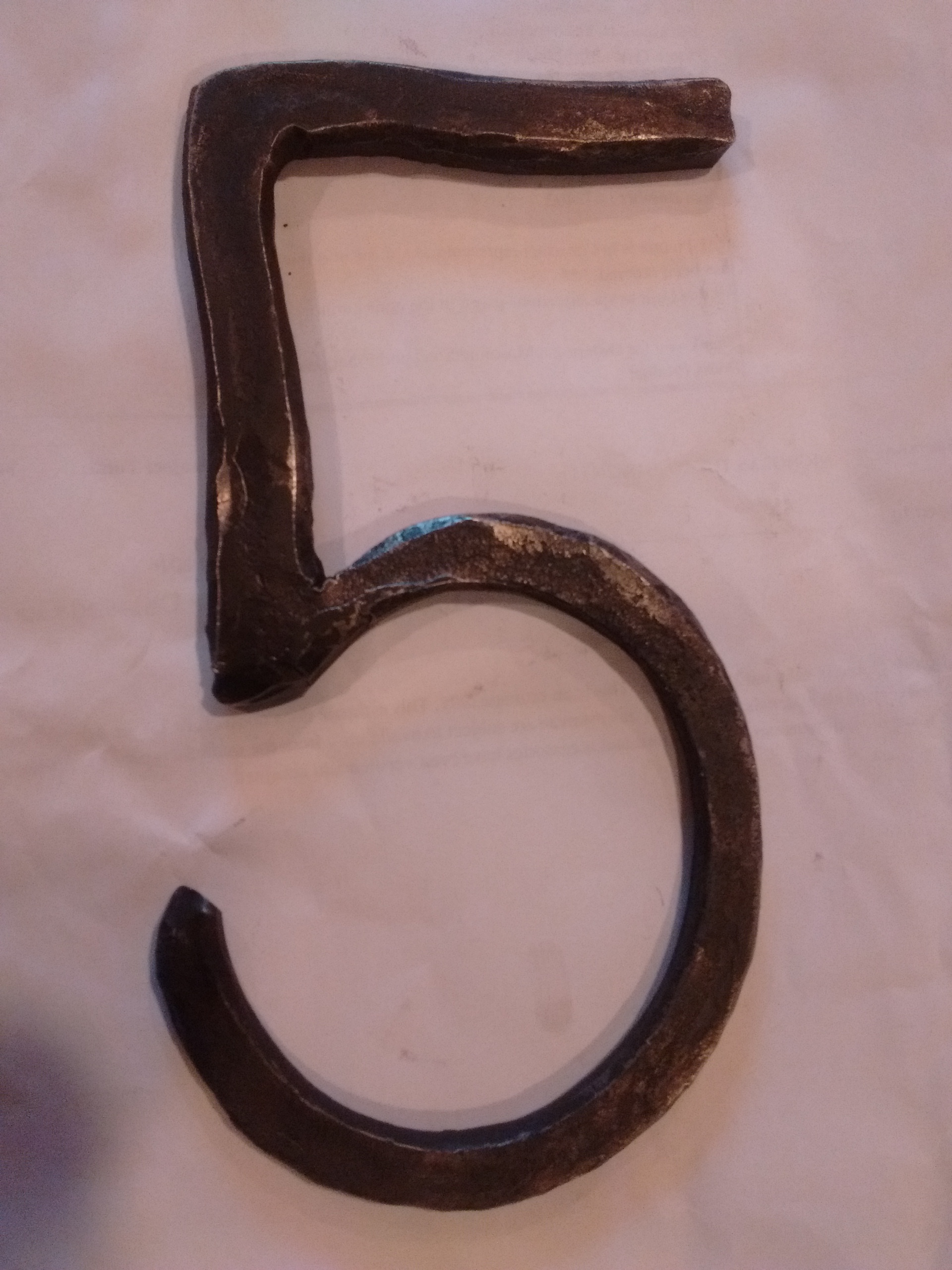

Thank you for the pointers. One thing though, I like algebra.  Will that effect the my welding abilities? Seriously, thank you.  I forged a 5 today.  I did the layout a bit off so the 5 is bigger than the 6.  I added an inch of stock for the space in the 5.....duuuuuh. I should have subtracted an inch.  It came out ok.  same basic layout and process.  I made a set of offset jaw tongs to hold the ring stock.  Meh...The best thing is the process.  Four hours went by in a flash.
This time I didn't leave enough stock at the joint. THIN... The right angle was easier than I thought it was going to be.  I left extra stock in the area of the angle when I fullered the top section.

Nice 5, just enough irregularity to give it the right look. Well done in spite of your aberration. Algebra GACK!!

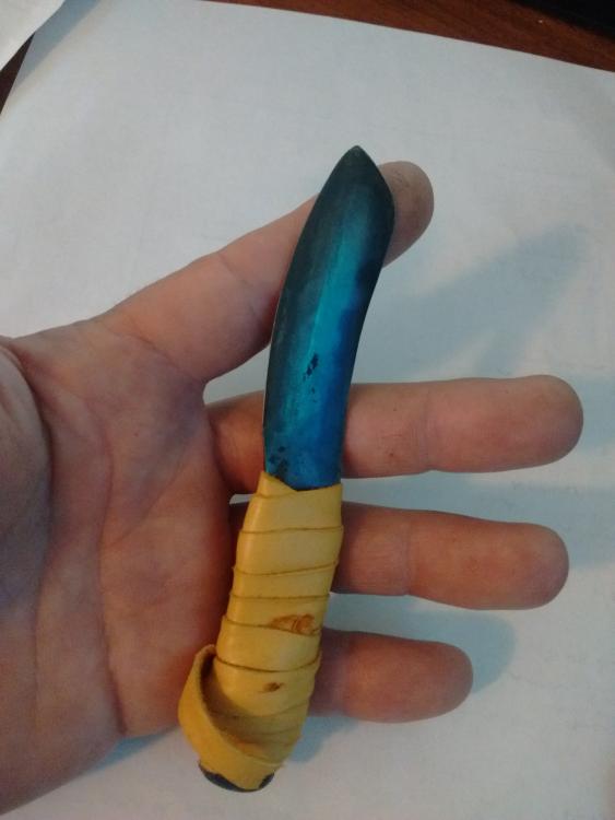

Again, thanks so much.  I tried forging in the gas forge.  I had an old bandsaw blade and snapped it into 3" pieces.  Welded them together on one end.  Put it in the fire and it actually stuck together when I struck it! WOW! I said well heck, I'll make something out of it. So I made a little pocket knife.  Thanks guys.  I appreciate all the help.

Pictures of the knife? HUH? Where are the pictures of the KNIFE? No pictures no knife!
Congrats now go weld something even more cool.

I used sulfuric acid to etch it.  I could see the layers.  Then I put blueing compound on it and it turned all black and you can''t see the layers. When I put a final edge on it the layers will show through there.
