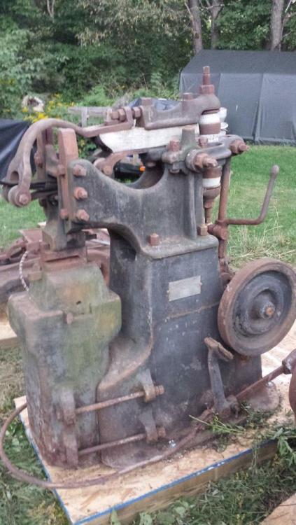

blacksmith steve Posted September 13, 2016 Share Posted September 13, 2016 I purchased a Bradley strap hammer from someone who had no history on it, other than "it was on the property when we bought it". The hammer has no tag on it indicating the hammer size. I am hopeful that someone may be able to shed light on the possible size and possibly an opportunity to obtain a manual for it. The particulars about it are; a Bradley tag with patent dates and a serial # 478, the footprint is approximately 22 X 43, height is approximately 55, the drive pulley is 12 (excluding the lipped flange), and the brake flywheel is 16 1/2. I've contacted Cortland Machine and I'm awaiting response. Any info would be appreciated. Thanks Quote Link to comment Share on other sites More sharing options...

forgedinfire123 Posted September 14, 2016 Share Posted September 14, 2016 looks like a 50 or 75 pounder Quote Link to comment Share on other sites More sharing options...
blacksmith steve Posted September 14, 2016 Author Share Posted September 14, 2016 A few members sent me Bradley manuals, thank you to all for the info. Comparing the spec sheet in the manuals, to the Bradley, indicate a 50# hammer. Quote Link to comment Share on other sites More sharing options...

blacksmith steve Posted September 22, 2016 Author Share Posted September 22, 2016 Anyone have a spec/dimension sheet for the cushions for the hammer? Thanks Quote Link to comment Share on other sites More sharing options...
clinton Posted November 24, 2016 Share Posted November 24, 2016 Hey there blacksmith Steve I do have the spec sheet for the cushions. I will get it to you no problem. And to answer your question about finding a source for the cushion no I did not find any. I did however talk to a gentleman named Phil That is very knowledgeable about power hammers and his advice was to make them using Polyurethane either casting them using a mold or using rod and freezing it then machine on a lathe. Good luck with your hammer looks to be in good condition, myself I would just try to get it going without a total teardown if it turns free it should work just fine. Quote Link to comment Share on other sites More sharing options...

CMS3900 Posted November 26, 2016 Share Posted November 26, 2016 Steve, take a pair of calipers to your cushions and post some basic sizes of them. I wonder if their close to a 100# hammers. Quote Link to comment Share on other sites More sharing options...

blacksmith steve Posted November 29, 2016 Author Share Posted November 29, 2016 On Thursday, November 24, 2016 at 10:05 AM, clinton said: Hey there blacksmith Steve I do have the spec sheet for the cushions. I will get it to you no problem. And to answer your question about finding a source for the cushion no I did not find any. I did however talk to a gentleman named Phil That is very knowledgeable about power hammers and his advice was to make them using Polyurethane either casting them using a mold or using rod and freezing it then machine on a lathe. Good luck with your hammer looks to be in good condition, myself I would just try to get it going without a total teardown if it turns free it should work just Thank you for the "cushion specs" offer, I sent you a PM. I agree with the run "as is" suggestion. I bought the hammer knowing it was frozen and anticipated a rebuild. This fall I planned to tear it down, starting at the tup. With PB Blaster, wrenches, and breaker bar in hand I started. After 2 cans of PBB and a TON of patience and time I was able to loosen the hammer from treadle to tup. The toughest and most time consuming was the treadle/break weight/tensioner. When I pulled the hammer out of the woods it was sunken nearly a foot. I am now able to turn the drive pulley by hand. I do not believe the hammer has seen heavy use as the tup guide adjustments are at the minimal setting. Currently in a holding pattern, as the hammer is stored tarped outside. Next steps are tup/helve attachment strapping, hard maple for the helve arm, cushions, and motor. I realize it will be looking for the proverbial "needle in the haystack", however I'm going to search for a single phase 900 rpm 3hp motor. P.S. A HUGE thank you for all the responses to date. Quote Link to comment Share on other sites More sharing options...

CMS3900 Posted December 1, 2016 Share Posted December 1, 2016 +1 for Kroil, and yea.. a 900 RPM motor will be more difficult than it is worth source. Most folks find a 1850 or so RPM motor and pulley it down to speed. For the maple contact local lumber mills, or even better lumber mills that sell specialty lumber to furniture and cabinet makers. They can probably get the timber you need, cut the way it needs to be. If you were in the PA/NJ/MD/DE area I would suggest someone like Hearne Hardwoods. As for cushions I am currently on a crusade to make some, progress of that should follow in another thread once I am confident on the size for each size hammer. This thread needs more pictures! Quote Link to comment Share on other sites More sharing options...
Kozzy Posted December 1, 2016 Share Posted December 1, 2016 One option for those cushions might be standard urethane die springs. They come in lots of standard sizes which by eye might foot the bill and also in several durometer ratings. I'm ignorant of the details of both price and actual cushion sizes so just tossing out an idea in case it's worth pursuing. Quote Link to comment Share on other sites More sharing options...
