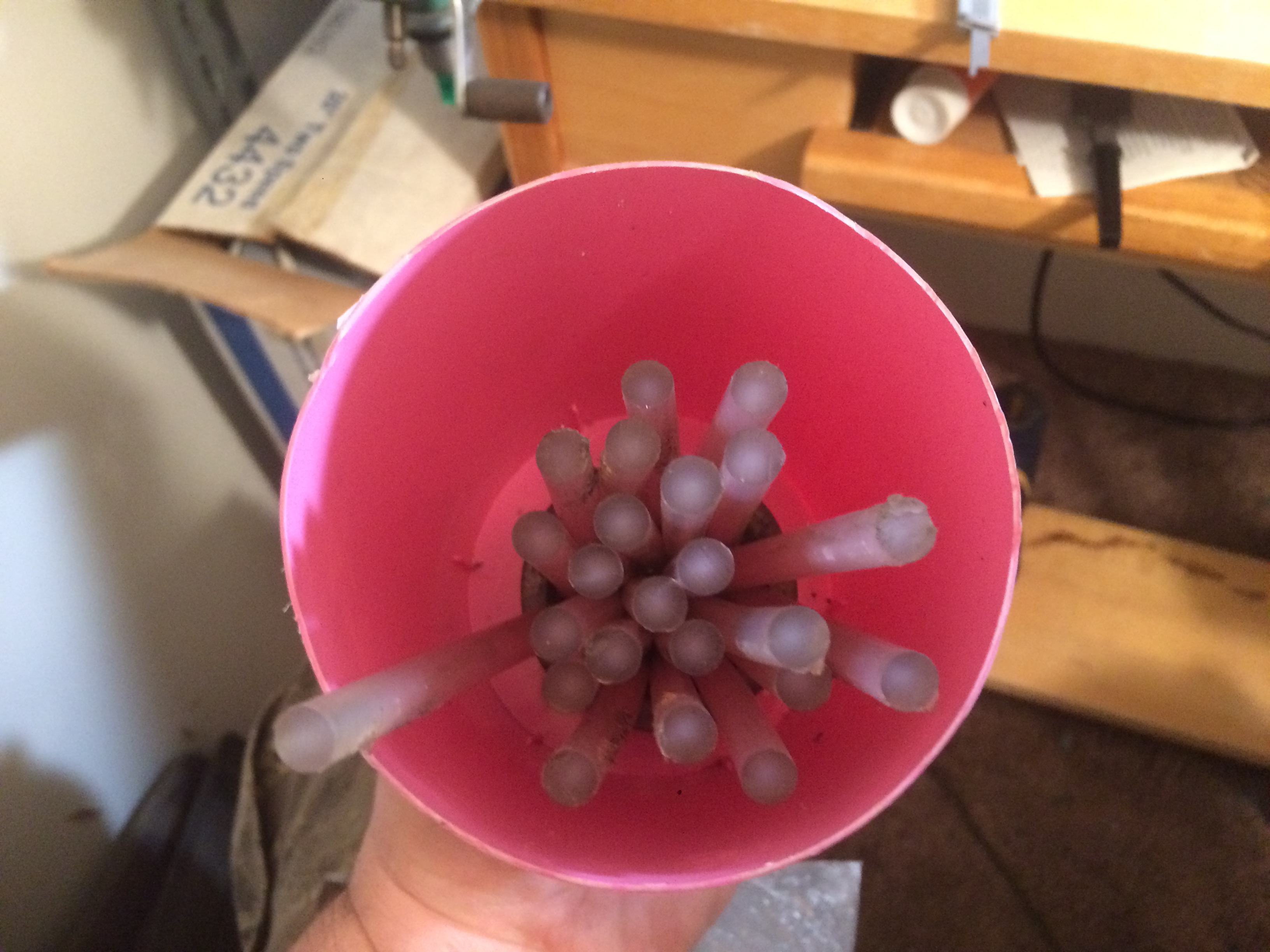

JoeThePro Posted October 22, 2017 Share Posted October 22, 2017 That kastolite is some interesting stuff to mix. I just finished casting the first one and it turned out ok, I wanted to record the measurements for next time. To cast one of the quart mixing jars I needed about 36 oz of kastolite powder and about 12 oz of water. Both are by volume. I attached photos to this post, I hope they get reduced by the forum software or I’ll have to try to get that done in at the computer. Quote Link to comment Share on other sites More sharing options...
Jasent Posted October 22, 2017 Share Posted October 22, 2017 I like it. The 2 in the center look a little close together. Looking forward to seeing the results Quote Link to comment Share on other sites More sharing options...
Frosty Posted October 22, 2017 Author Share Posted October 22, 2017 Kast-o-lite can be a PITA to mix, the aggregate is crushed so it keys and doesn't want to flow easily. I made up a vibrator to get it to flow between crayons. How'd you get yours to flow? Of course now we get to wait till you get the glue sticks cleaned out to see how it works. Thanks for the photo spread. Frosty The Lucky. Quote Link to comment Share on other sites More sharing options...
JoeThePro Posted October 22, 2017 Share Posted October 22, 2017 Ok here’s take 2. This time I used the 1” run x 3/4” tee that is used for the frosty t burner, taping off one of the 1” sides and placing that on the bottom. The thought is that I’ll open that up to have a look at the interior after burn out and then plug it when used. This one also only has 19 glue sticks, which makes for a nicer bundle closer to the 1” size. When casting its important to stuff some in between each glue stick with your finger before filling the sides or else it’s very difficult to get them to maintain any space. 4 hours ago, Frosty said: Kast-o-lite can be a PITA to mix, the aggregate is crushed so it keys and doesn't want to flow easily. I made up a vibrator to get it to flow between crayons. How'd you get yours to flow? Of course now we get to wait till you get the glue sticks cleaned out to see how it works. Thanks for the photo spread. Frosty The Lucky. I’m using the side of the blade on an oscillating tool to get it to flow some, but the main part is fingers to stuff it in he right spots. Quote Link to comment Share on other sites More sharing options...

Frosty Posted October 28, 2017 Author Share Posted October 28, 2017 Looks good, probably need more orifices with such a small plenum, maybe 21 or 22 in the next one, they're easy to block off if you make too many. So, what's your impression of using glue sticks? I didn't have nearly so much trouble getting crayons burnt out and heck with a healthy coat of Crisco for a release agent most pulled out cold. You still want to burn out the Lard-like veggy grease and what crayons don't come out I use half a dozen or so charcoal briquettes and just let it cook till it's cool, next day usually. I burn out in my old rivet forge with my brick "fire pot" customizers (fire bricks) arranged to keep the block on the fire. I used the shop toaster oven to melt out the wax in the first block but it took a long time and I still had to do a charcoal burn out so I just skipped the oven step. Crisco works a treat to release the mold and crayons from the Kast-O-Lite. The stuff is made to STICK, if you don't get it off your mixing tools and putty knife before it sets you almost have to sand it off. Frosty The Lucky. Quote Link to comment Share on other sites More sharing options...
