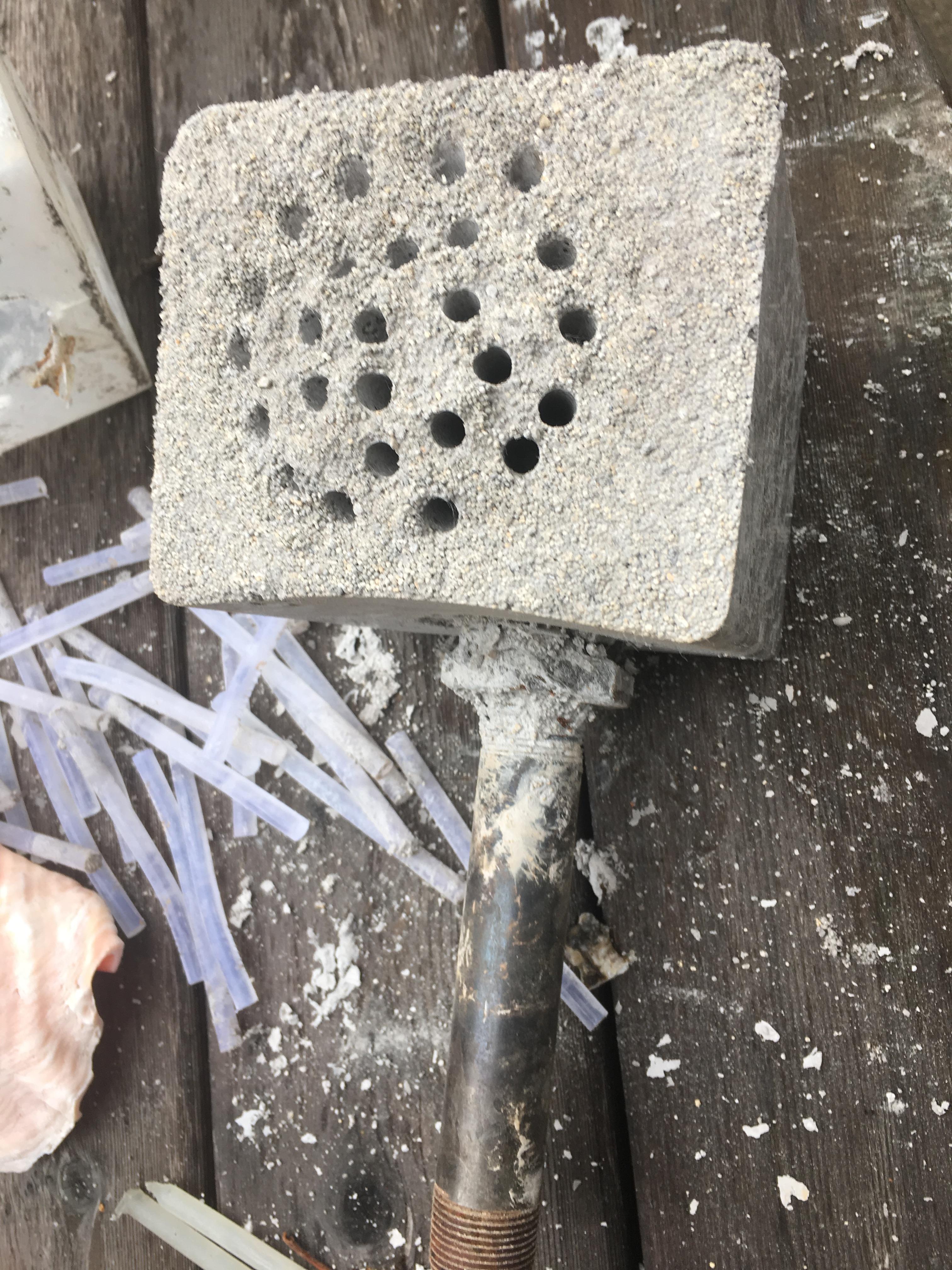

  7. Here’s 25. I had to pack in 23, then push 24 & 25 in with a nail set / punch. I like this configuration as they aren’t spilling over the edge, and I didn’t have to melt the sticks at all. These are new sticks too, all the other ones I had were old ones that I had inherited from my mother in law so they seemed stickier and may have been harder to pull out. No melting should mean that there’s nothing to burn out too. Another thought I had when making this - I could wrap some reenforcement around the outside of the tee and clamp with a hose clamp for added structure, although these things seem tough. I actually dropped one from about 4’, with the frosty t burner attached and it survived.

  9. Well burnout didn't go quite as planned - I only had another NARB to use to try to melt the adhesive out of there, so I put one in the middle of a makeshift forge, and fired one up and placed in one end, expecting cracks from the one in the middle. Some small ones did develop, and the insides didn't get as hot as I hoped (xxxx insulating refractory!), so the glue didn't burn as well as I wanted. After messing with that for awhile, I grabbed them both and put them on a baking sheet, with crumped foil "rings" to raise the flame face off of the baking sheet, and gave them 450° for about an hour, using a skewer to poke through all the holes to help it flow / drain after that hour. If you have a hood fan running and wipe off excess glue it doesn't stink too bad. Ideally I think 350° for a few hours to melt out the adhesive (and help cure), followed by a coal or charcoal fire would be ideal. I'll be using something like that on my next experiments. Next I went and placed them with flame faces touching at bottom, and 1/2" opening on top, and fired one up. Flame chases all the way through to the inlet of the other burner, and this helped clear out any remaining glue. After that I placed it back in my forge, and it runs well from 1 PSI to 20+, very stable even though it's pretty windy today. Attached are some pictures - it's difficult to see the blue flames from the nozzlets on the pictures, but it shows in person. 15psi without much time heating up, can see some of the blue jets: 15psi after heating for awhile (there's flame, but you can't really tell!): 1psi: Immediately after testing, face still over 850 degrees (top of my thermal range):

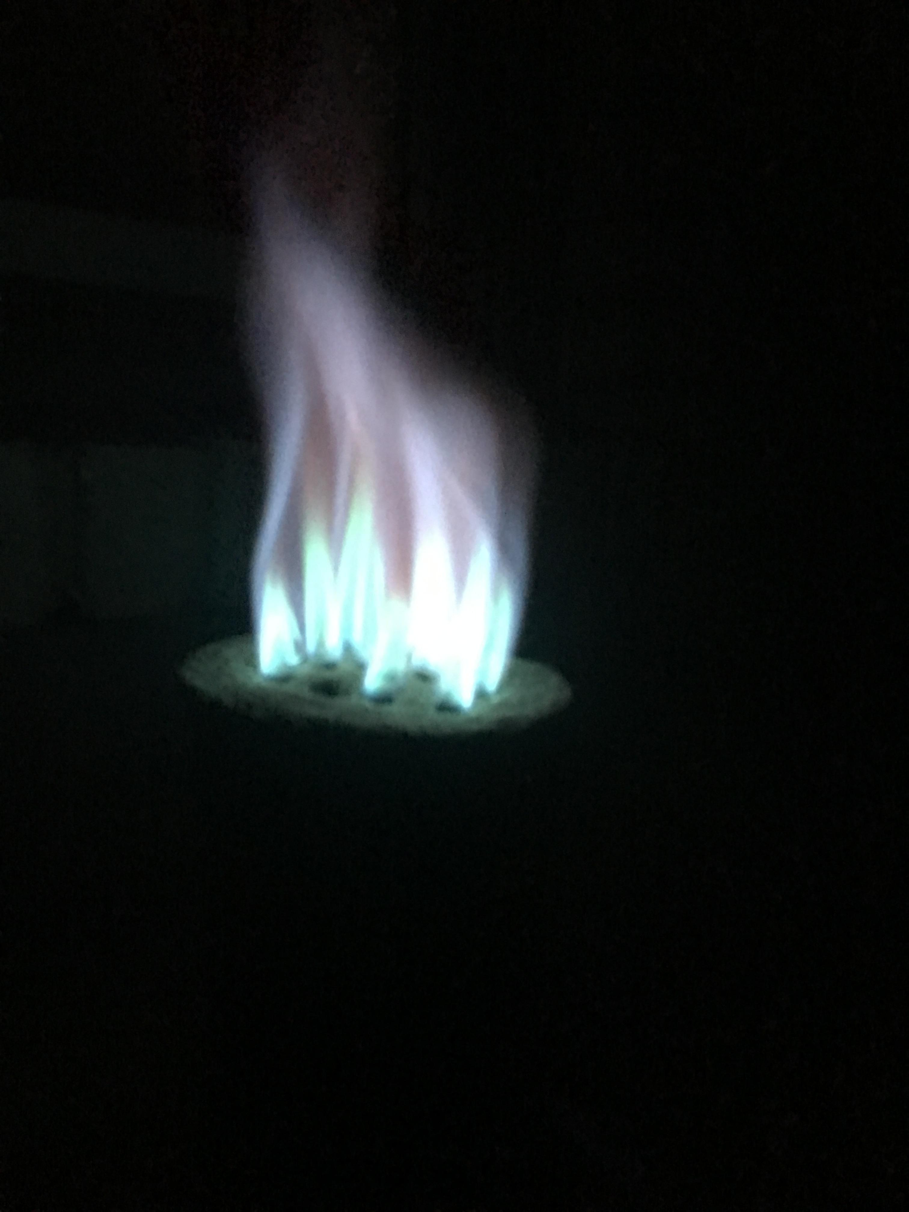

  12. You made me curious. This is without burning it out, and without a forge, and on very low psi - like 1-2. And it’s a bit windy. And I need to tune this burner as it’s the first I’ve built If I go higher I start smelling gas around the intake, so the NARB is restrictive right now.

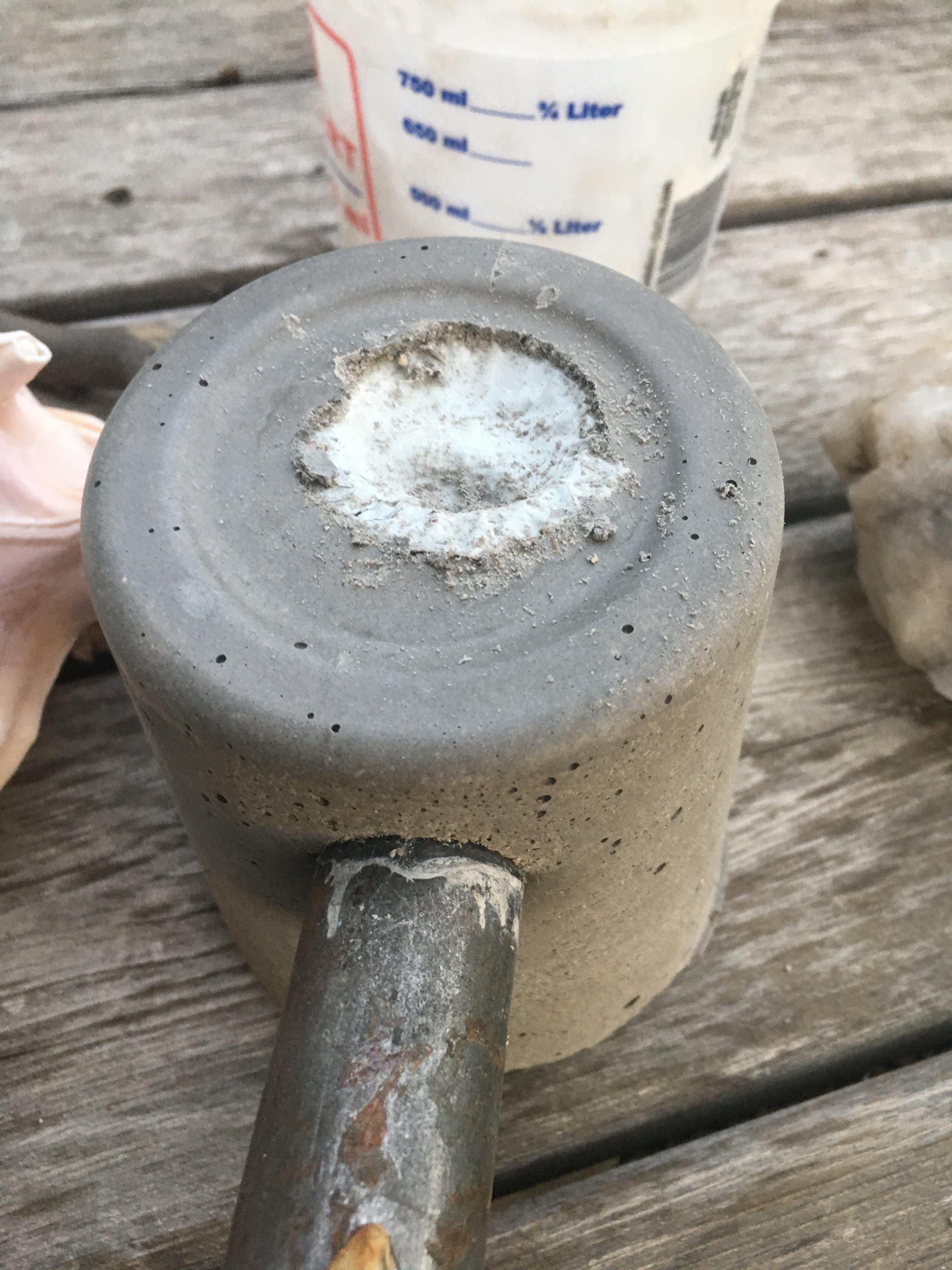

  20. That kastolite is some interesting stuff to mix. I just finished casting the first one and it turned out ok, I wanted to record the measurements for next time. To cast one of the quart mixing jars I needed about 36 oz of kastolite powder and about 12 oz of water. Both are by volume. I attached photos to this post, I hope they get reduced by the forum software or I’ll have to try to get that done in at the computer.
