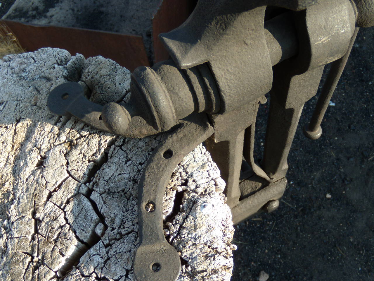

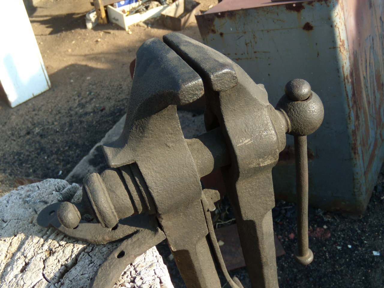

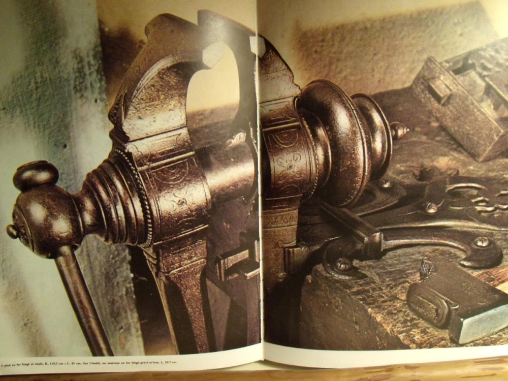

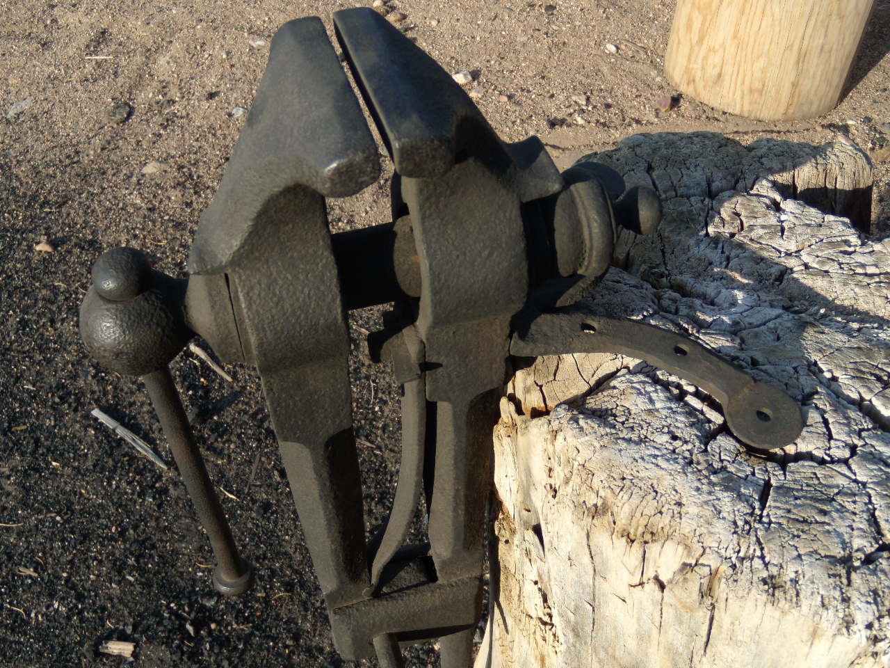

Is there such a thing as a leg vise aficionado? I am he. I have a vise similar to the one in the Zoffany painting, which I show in the three submitted images. I hope it can go to a museum or collector some day. I've also shown an elaborate French vise that I copied from a book. The same vise is pictured in d'Allemagne's "Decorative Antique Ironwork." Regarding a visible mounting, it sometimes doesn't show because it is under the bench top. This was seen at the Dominy clockmaking workshop in Hummel's excellent book/catalog, "With Hammer in Hand."

Frank, is the mounting tang mortised through both the fixed jaw and the spring?  If so, I am going to rethink my DIY plan.  Drifting through liuft forks would be tough on my smaller anvils, but I have access to a mill & carbide mills.  This may qualify me for some overdue vacation.
Yes, the tenon goes through an upper portion of the fixed leg and the spring. The tenon slot for the wedge must be placed accurately so when the wedge is driven, it draws the mount and the spring tightly. The spring doesn't need the little right angle bend at the top; that was only needed when the surrounding U-shackle came into use at a later date.
