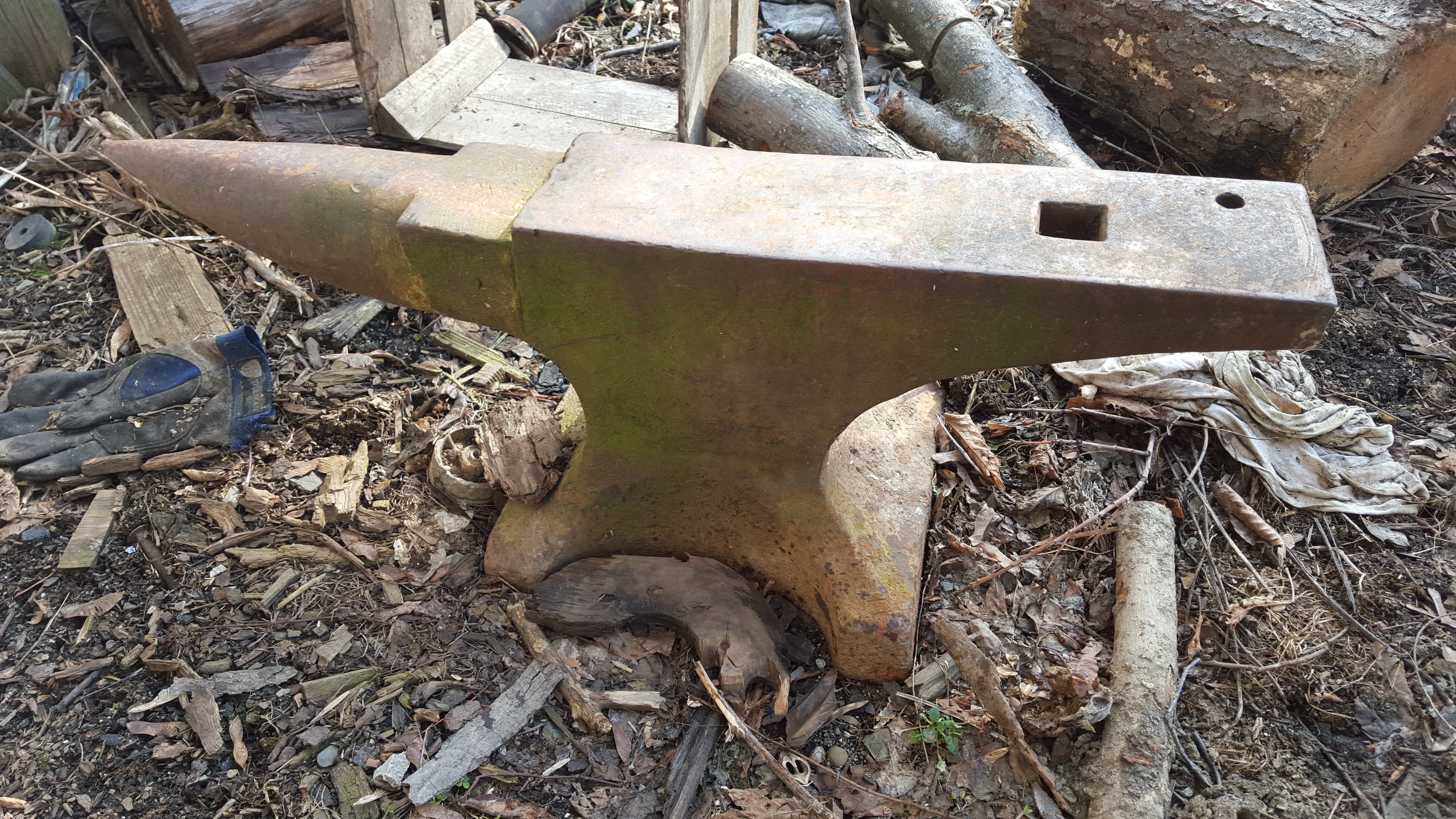

Hi,
This is my first post in these forums and I hope that I don't unknowingly break any rules. I'll be signing up for some blacksmithing lessons soon, and decided that I need to buy an anvil. I recently picked up the anvil in the photos. I know that these photos aren't the best, but they are the only ones I have at the moment. The anvil measures 35" in length, stands 13" tall, and has a face width of 5 3/4". There are no markings anywhere on the surface that I can find, and I've looked at both sides carefully. I simply can't see any markings on it at all. I used a hammer to check the rebound before I purchased it, and was amazed. The hammer xxxx near wanted to jump right out of my hand. It rings like a bell. It came out of a railroad repair shop that had closed back in 1976. My guess is that it weighs well over 300 lbs. I got a boatload of tongs and tooling with it too.
Can anyone here possibly help determine who might have manufactured this anvil? I'll take better photos and post them when I can. Thanks.

first, welcome to the site, and sorry I don't know much about anvils, though others will be along and ask you to take pictures of the underside of the anvil base, and pictures of the feet (for a serial number).

You are going to make a lot of smiths here pretty jealous.  Just starting out and you look like you have scored at least a 300 lb. anvil in great condition with additional hand tools.  If you decide smithing isn't for you, you should have no problem selling this stuff off.
Look on the front foot for signs of a serial number, might require a wire brushing...
Tip the anvil on its heel and take a picture of the underside of the base.
Guessing around 350# ballpark range for those measurements.  Nice!

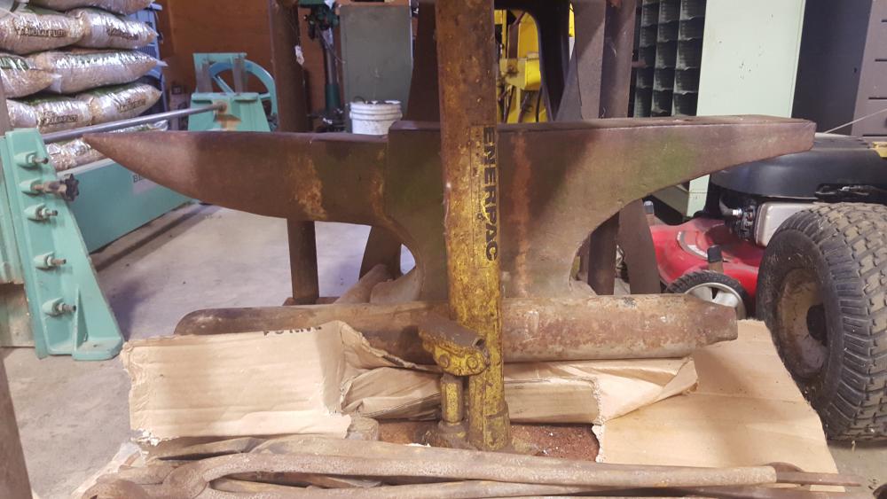

Here's a little better view of the anvil.

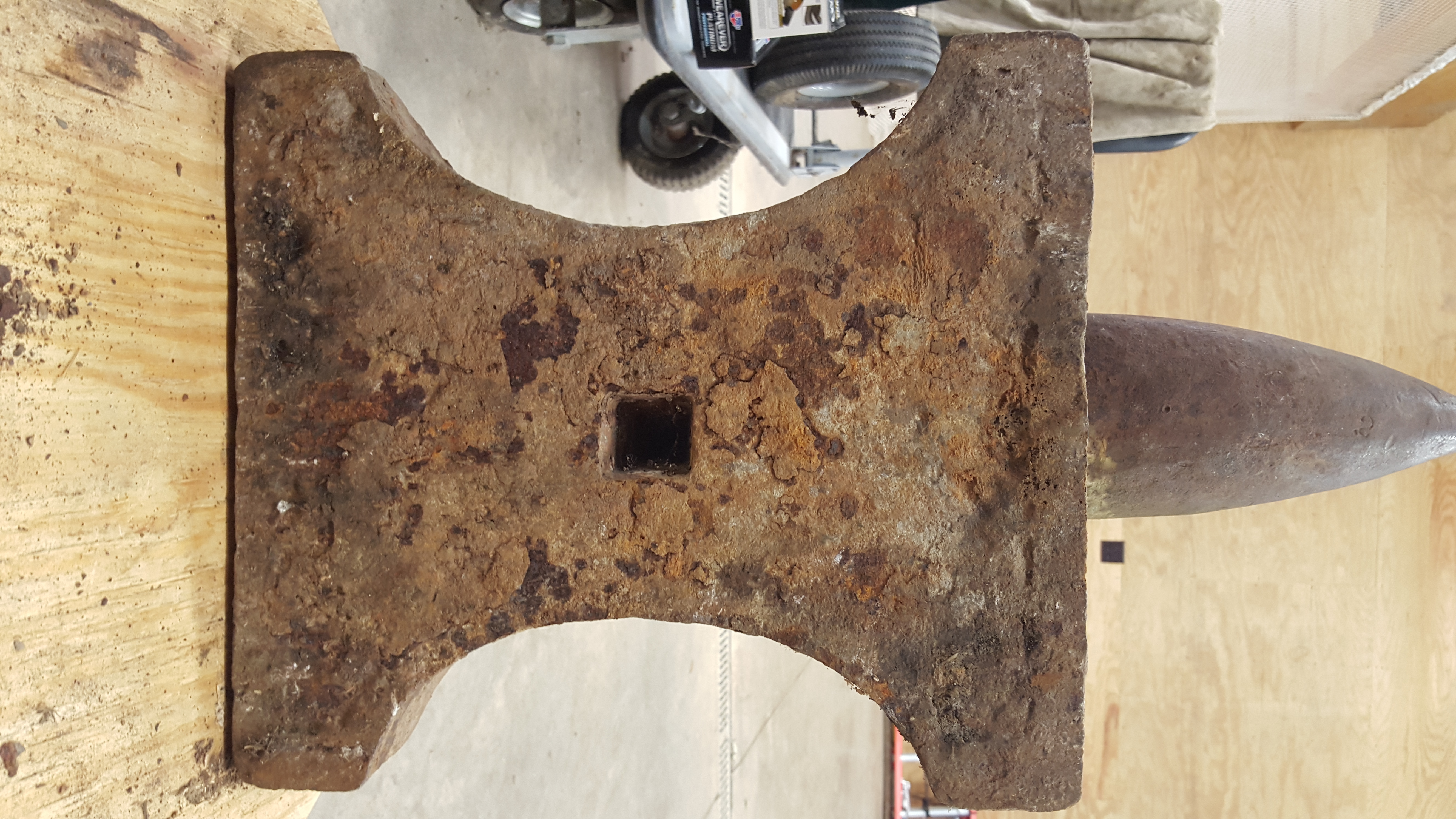

A picture of the underside of the base might help as well as several brands had differing shaped depressions in their bases.  Any stamping on the front of the front foot is also useful and what sides each part is on if it has any (like serial number on right or left of the front foot, weight on the left, etc)

I'll take photos of the base and underside this weekend and post them here. Thanks for the replies so far.

Maybe I can help...
 First, where are you located? Where was the railroad shop?
I have a very similar anvil, it's even green like yours. Has no makings, like yours. Mines 400 pounds.
Mine came from the town of Truckee, California. Truckee is around 6400 feet in elevation, in the California Sierra. What does this have to do with anything? I started wondering how and why someone would have such a big chunk of metal, and how difficult it would be to get said chunk of metal up to that altitude. Truckee lies on what was the Southern Pacific Railroad mainline. Southern Pacific paints their "maintenance of way" railroad cars and tools green. Large railroads had, at the time, the means to forge massive metal pieces, like the side rods of a steam locomotive. Whipping out a run of anvils would be no big thing for a steam shop...they were forging parts on a daily basis. No need to put identifying marks on their anvils, they were kept captive in their shops.
Mine looks like a Hay-Budden knock off...it is shaped very similar to one. My anvil was painted a bit more mint green...found the color once I had removed the white paint that it wore when it resided in its owners yard...also came with a cast stand.

Is there a numeral stamped next to the handling hole, upper waist, under the horn? If so, it might be a Hay Budden.

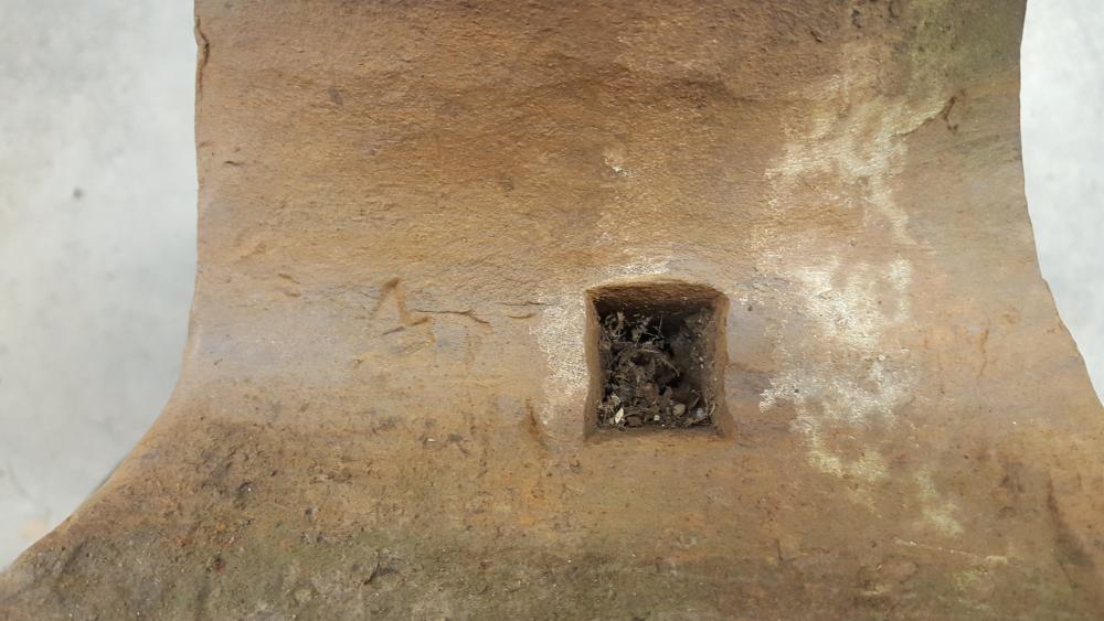

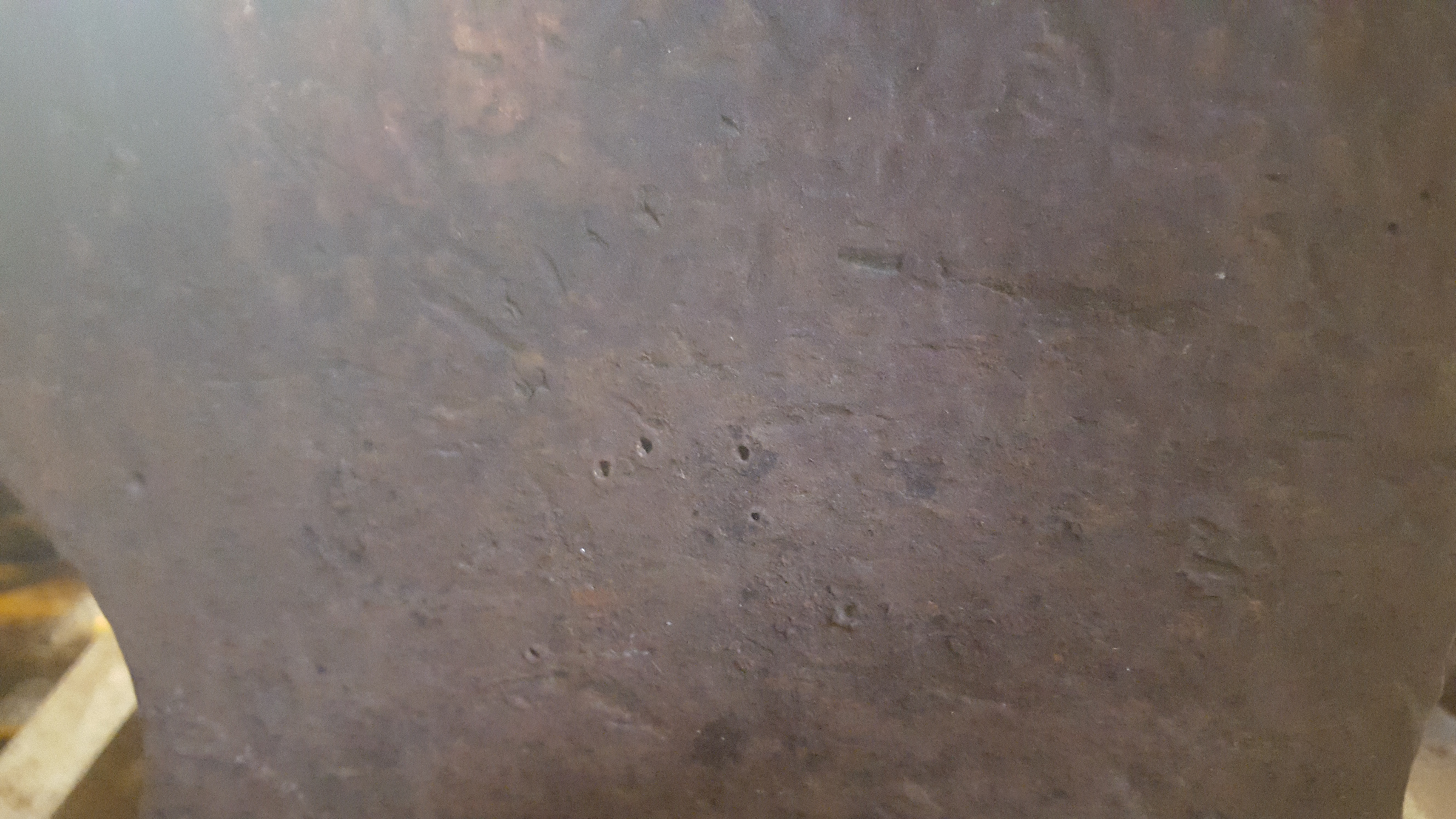

As promised, here are some of the requested photos. The only marking that I was able to find was the number 4 stamped into the anvil below the horn, as you can see in one of the photos. No other markings were found.
That was quick! How can you tell?
By the way, here's a shot of one of the forging tools that came with it. There are several others too.
That tool is a sheet metal working stake, and should never be put in an anvil and used. Good way to break an anvil.

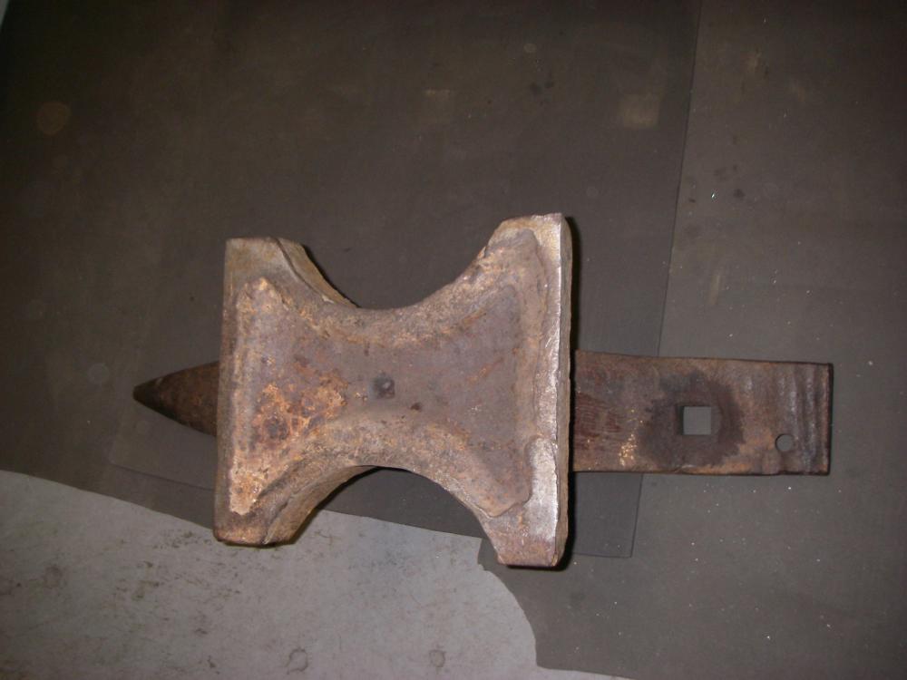

Here is the bottom of my 211 pound Hay-Budden. The 'frame' around the edge is typical.

Frank, yes there is a number 4 stamped there. Your observation together with Black Frog's and John's replies has me convinced that it is very likely a Hay Budden. Where did Hay Budden normally stamp their name on the anvil? Was it stamped on the side or the bottom? Or would they have produced some anvils for certain customers that were not stamped with their logo at all?

Why I wanted a picture of the bottom---a feature unlikely to be copied when "forging" one and closely associated with HB's (and a few trentons...)
