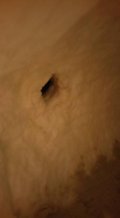

Mberghorn Posted March 2, 2017 Share Posted March 2, 2017 Sadly I built my forge before discovering IFI but I got a good bit of info from Ron Reil's pages and other various research that I'd done. I ended up using a ceramic fiber blanket called Cerachem blanket made by a UK based company with a manufacturing plant in Pennsylvania. It comes in various weights each having a different temperature rating. Mine is rated for a working temperature of 1425C (2600F). Here's the product data sheet http://www.morganthermalceramics.com/media/3993/cerablanket_cerachem_cerachromeblanket_english.pdf I didn't know anything about rigidizing at the time so I went with the 2" thick blanket. It tends to hold it's form pretty well even for not being rigidized. I have some 1" firebricks, which I bought on line that are pretty heavy so I hope they're not the crap ones that I keep hearing about on here, as my floor and they seem to do alright so far. I'll post some pictures when I get home of my build so you guys can chop it up and tell me what all I did wrong that I might not have figured out by reading all this already. I'm all up for constructive criticism!! Quote Link to comment Share on other sites More sharing options...
Frosty Posted March 3, 2017 Share Posted March 3, 2017 Cerablanket is a good product. A single layer of 2" isn't ideal but it'll work just fine and yes, it holds itself in place better than 2 layers of 1". Have you coated it? If not you can still rigidize it. What it really needs is a hard refractory flame face if it doesn't have one. Pics please, we LOVE pics. Frosty The Lucky. Quote Link to comment Share on other sites More sharing options...
Mberghorn Posted March 3, 2017 Share Posted March 3, 2017 7 hours ago, Frosty said: Cerablanket is a good product. A single layer of 2" isn't ideal but it'll work just fine and yes, it holds itself in place better than 2 layers of 1". Have you coated it? If not you can still rigidize it. What it really needs is a hard refractory flame face if it doesn't have one. Pics please, we LOVE pics. Frosty The Lucky. The only part that I coated was the seam because I didn't want to inadvertently melt through the forge body. I plan on ordering some colloidal silica and rigidizing once it comes in. In the mean time I'm rebuilding my burners based on the info I got from the burners 101 page (thanks in HUGE part to you and Mike). These are the firebricks I'm using as my floor. Currently just laid in there with one on the bottom and one on each side creating a sort of U shape. https://www.amazon.com/gp/product/B000UEYZ4S/ref=oh_aui_detailpage_o03_s01?ie=UTF8&psc=1 And this is the refractory that I have. https://www.amazon.com/MEECOS-RED-DEVIL-610-Refractory/dp/B00ACIWN9Q/ref=pd_bxgy_201_2?_encoding=UTF8&psc=1&refRID=8KBNVHBDX3R958P8F2G4 Here are the pictures I have from the initial build. I'll take some pictures of the rebuild once I get a chance. LET THE CRITIQUEING BEGIN!!!! Quote Link to comment Share on other sites More sharing options...
ThomasPowers Posted March 3, 2017 Share Posted March 3, 2017 I put the seam on the bottom and cover the seam with the hard firebrick splits I use to armour the bottom. What do you plan to use that for? It looks quite large for many tasks and of course that means more fuel used. Quote Link to comment Share on other sites More sharing options...
Mberghorn Posted March 6, 2017 Share Posted March 6, 2017 On 3/3/2017 at 0:00 PM, ThomasPowers said: I put the seam on the bottom and cover the seam with the hard firebrick splits I use to armour the bottom. What do you plan to use that for? It looks quite large for many tasks and of course that means more fuel used. The inside diameter is only about 10" but I agree that it's much too big for what I really need. I share this one with another guy that's trying to get into smithing too and he wants to make things like battle axes and short swords. I plan on building another one out of another 30 gallon barrel but I'm going to cut out the center section of it and weld it back together then most likely use 3" of fiber blanket, one layer of 2" (I have about 10 feet of 2" blanket left) rigidized, and then one layer of 1" rigidized, with a half inch of refractory and then a quarter inch of ITC-100 or similar. (Not quite sure on that last part yet) That should give me a more efficient forge and significantly cut down on fuel use. Mostly what I want to be making is tongs and practice pieces for now but eventually pieces to sell at shows and the occasional commission. It's a good release for me (and believe me I need that) and it would be nice to make enough selling things to cover fuel costs and such. Quote Link to comment Share on other sites More sharing options...
ThomasPowers Posted March 6, 2017 Share Posted March 6, 2017 Unfortunately when forging a sword you ONLY want to heat the amount of blade you can work before it cools---usually under 6" and often just a couple. All the extra length you heat suffers degradation through decarburization, grain growth and scaling + you are throwing away money heating all that extra space! Pretty much the only time you need a long forge for swords is for heat treating (or if you have a powerhammer and are good with it) It's sort of like buying a dump truck as your daily driver because a couple of times a year you need a load of gravel. Battle axes would probably require something like a brick pile forge as they have a difficult shape to get into a standard propane forge. This is one of the most common errors folks wanting to forge swords make---not finding out what they need vs what they think they need. Quote Link to comment Share on other sites More sharing options...
