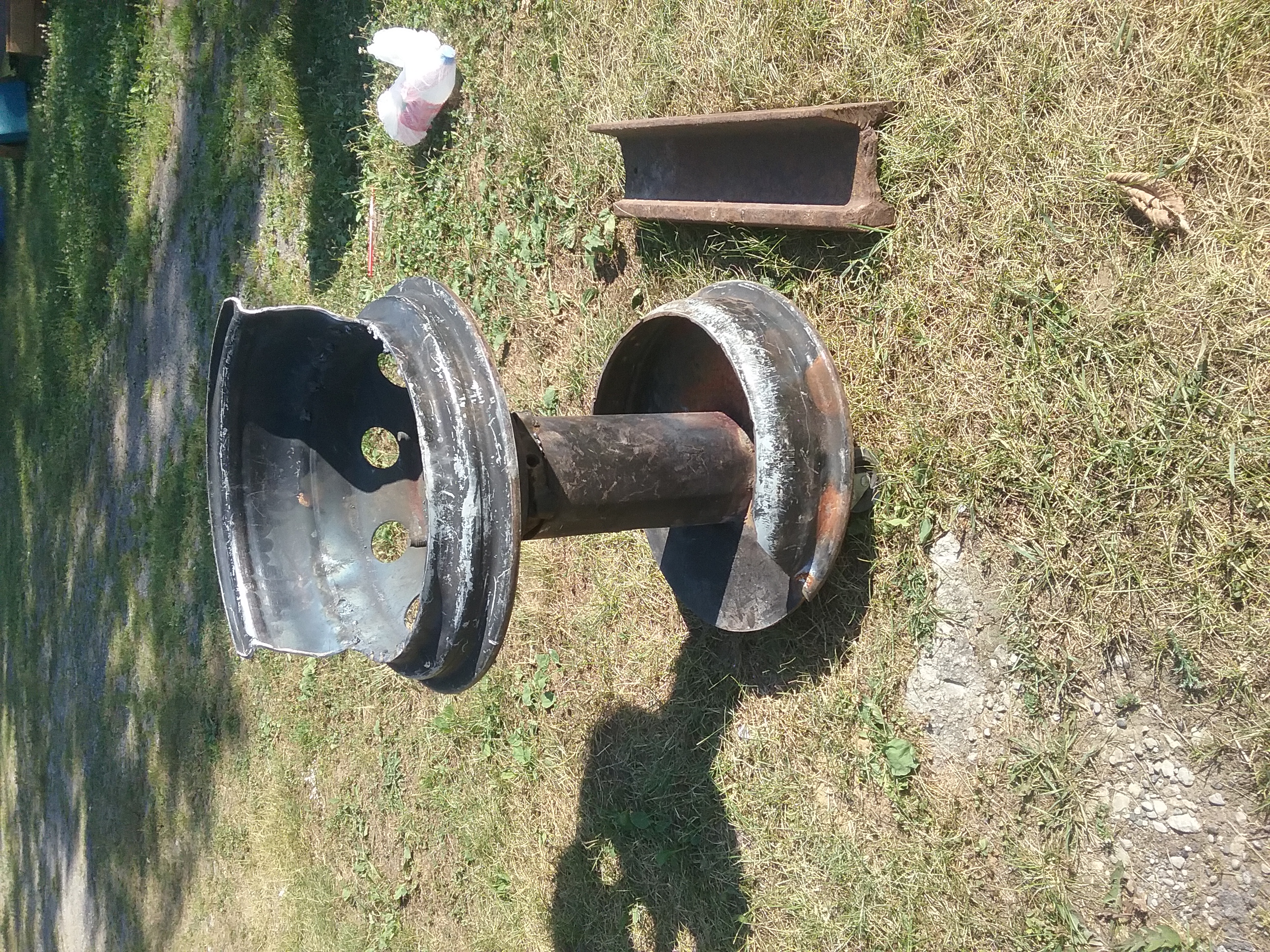

Beatsy' s Forge Posted July 12, 2016 Author Share Posted July 12, 2016 Here's what we came up with what do you all think? It is about 14 in . diameter and I miss thinking of cutting it down. Or should I bring the size down with the refractory I have? Couple other things that need to be done and it can get its first heat. Quote Link to comment Share on other sites More sharing options...
Charles R. Stevens Posted July 12, 2016 Share Posted July 12, 2016 It's difficult to manage the fuel pile with our dropping hot embers off the side. Quote Link to comment Share on other sites More sharing options...
Beatsy' s Forge Posted July 12, 2016 Author Share Posted July 12, 2016 Yeah I will probably use a castable table cause that's what I have available or try and find a piece of .5 in plate for it but if I want to get started castable will be faster than the search for a plate and besides the castable is free. So I have to make a decision. Quote Link to comment Share on other sites More sharing options...

Frosty Posted July 14, 2016 Share Posted July 14, 2016 Martin: I acquired the brick after making the fabbed forge and it wasn't long after I discovered I didn't know which seam to dig for the good coal and I'm not going to go to the trouble of mapping, sampling, logging and testing to find the good stuff. Even if I had good coal in easy reach I'd stick with the fabbed forge, masonry is too hard to move if I want to rearrange the shop. A stove pipe stack isn't near the anchor a masonry anything is. I can always pull a stove pipe and patch the roof if I need to move it. Oh NOOOOO NOT the wheel or semi brake drum forge! Unless you're in love with the idea of casting or troweling mud to make something workable throw it back. A sheet metal table, even an old top load washing machine with the lid flipped upside down works fine. Make a hole JUST large enough the center of a brake rotor to slips through and pack the rest of the table with damp sandy clay even with the disk and you're ready to go. A floor flange that covers the lug pattern and some threaded pipe makes your tuyere, a bolt or two attaches it to the fire pot. The fire grate can be as simple as some 1/2" Rd bar with say around 3/8" - 1/2" space between and you have an excellent air grate. Rows of slots are very easy to keep clean compared to holes. Heck I recall seeing someone laying 1/2" bolts with the heads facing alternating directions till they pack the hub for an air grate. Remember it's EASY to make the fire "pot" deeper by stacking brick around the existing one but it's a serious PITA trying to make one shallower or smaller. Frosty The Lucky. Quote Link to comment Share on other sites More sharing options...
