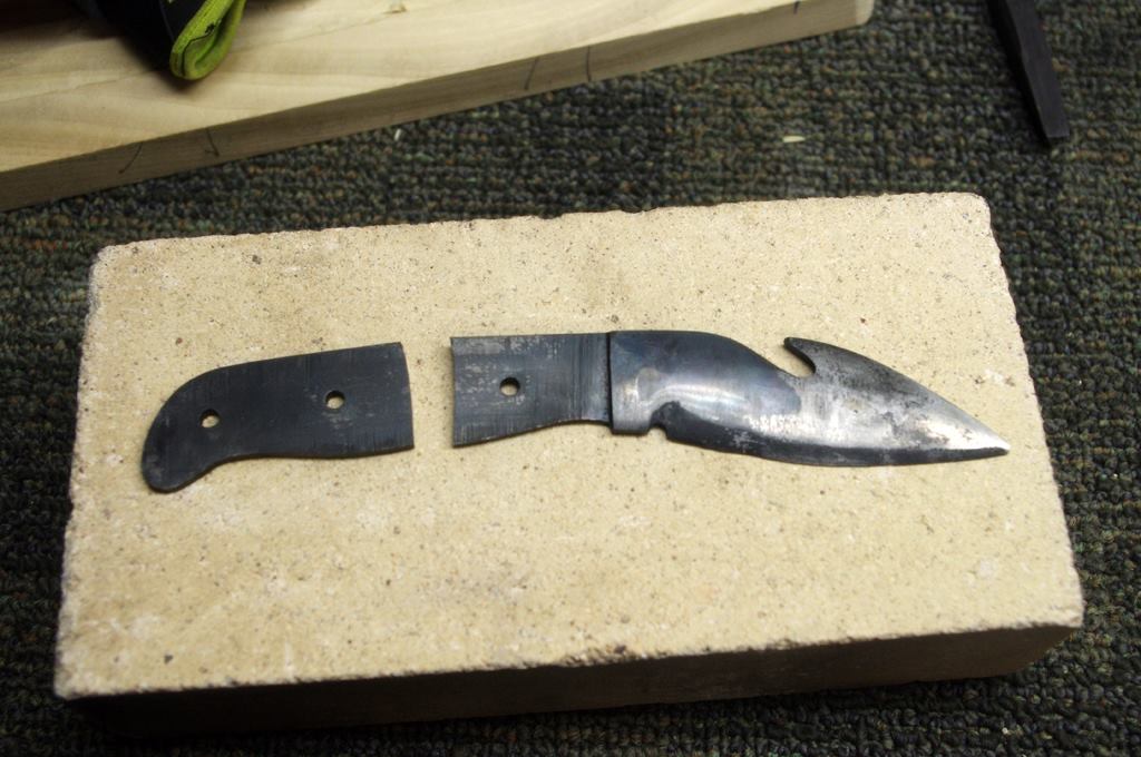

This is/was my 2nd knife. I used O-1 tool steel. The design didn't seem very complicated on paper, but it sure was a P.I.T.A. trying to cut and file. It's going to have a brass bolster and handle made from snakewood.
Hardened in oil and then tempered at 400 degrees F for 4 hours.
My first test of the knife was dropping it onto the concrete floor and - voilà. I guess it was just knife-shaped object.
Next time I will temper longer, and I've come up with a simpler way to make the blade - I'm going to give it a whittle tang instead of the scale tang.
why do people ruin perfectly good knifes by dropping or throwing them at concrete? what evil person is telling the noobs to do this?
I already wrote a long detail post about heat treating, I refuse to type all that again. .  One trip to temper for 4 hours is not correct, the steel needed a rest and a second trip to convert the retained Austenite that converted during the first temper. which I also explained.. not a surprise you ruined it. Sorry.
Steve, I do the drop test all the time.  Never had one do that.  The problem is doing it without understanding heat treating and what is going on.  First, don't harden much into the handle area.  If you do use a torch to do some differential tempering.  It's not really complex but doing it right can be.
Keep your next blades simple.  Get some steel like 1084 that's better suited for a newb.  If you intend on making an unbreakable blade learn the "soft back draw".
Good luck.

Good idea. I'm glad this knife broke, I was very unhappy with the way it turned out, and it was going to be a gift. Now I can start again with a better (simple) design which I know that I can do nicely. I got a lot of experience filing and grinding and fiddling.
I'm going to keep playing with O-1 until I learn it well.
I've tried the soft back draw, but no matter how slow I try it, the blade goes from shiny polished steel to black and then orange if I hold it on the heat too long (waiting for "straw" to appear). I never see any other colors, let alone "straw."
Use indirect heat to do it then. Put a semicircular roof tile over the fire, or half pipe. Then set the back of the blade on it. That way the fire doesn't contact it directly. I have drawn back items with a propane torch with no issues. What are you using?
I tried using a propane torch, the outside of my forge, and I even heated a long strip of spring steel for the heat source.

Harry, another thing to keep in mind with O1 is that thin sections can air harden.  I had one quickly dull a drill bit after forging and rough grind with no heat treat at all.  I had to heat it back up to a dull glow and move it back through the dragon's breath and then just outside the flames a little bit at a time over 20 minutes or so to get it soft enough to drill. Also, if hardened correctly it will not drop below 60 hardness until about 500F or more when tempering.

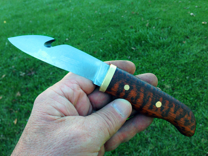

  • 5 months later...
Here is "Take 2" on this blade. I changed the blade style slightly, and used a whittle tang instead of a scale tang.
While I did not repeat the drop test, I did beat the xxxx out of it otherwise. It's a tough blade.
