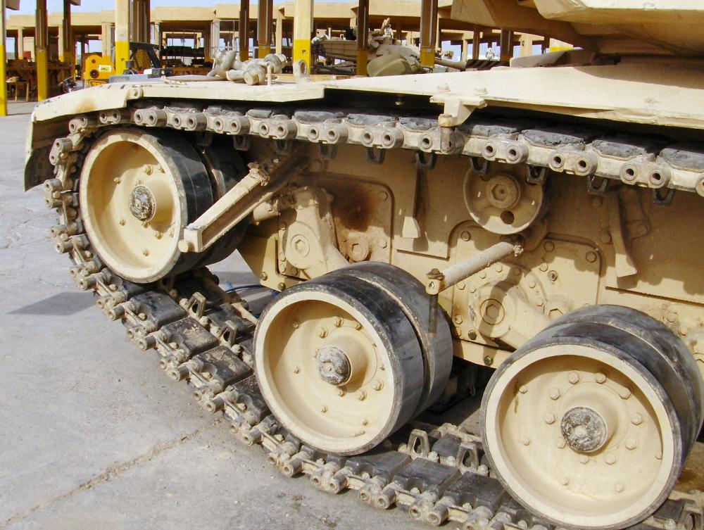

Avadon Posted June 11, 2016 Share Posted June 11, 2016 Hello fellow metal workers, I have some questions regarding making aluminum tank tracks for a robotics project. The tank tracks are 4.25" wide x 5/8" tall (length TBD) they are made up similar to the way an Abrams tank track is put together. I found a metal works company who specializes in turning small 6061 aluminum - rubber coated wheels and though expensive they can produce what I'm looking for. So now I'm back to the tank tread portion which I'll probably make myself. My experience: 10+years experience with TIG welding/fabrication and can weld most things. Many years ago I read a book on backyard metal casting because I wanted to cast aluminum tank treads. Back then the guy was using a Pyramid furnace (the company is no longer in business) to cast aluminum tracks. So here I am wanting to pioneer this venture again with many questions. After reading the beginner pinned thread and all the safety precautions, Aluminum casting seems a little scary/intimidating as well as an enormous investment of time to learn a whole new universe of skills and the safety surrounding them. Therefore I've come to these questions which I hope others can help me answer. A:) Would a furnace produce acceptable enough results in fit and finish for this type of application? (or am I better off in fabrication?) B:) How much cost investment is there in buying a high quality furnace, crucible and safety gear? C:) Roughly how much time investment is there in learning to cast small aluminum parts? D:) What is the mold material needed? E:) Are there any up to date extensive youtube videos or good book recommends specifically for casting aluminum. I have concerns with doing it safely as well making sure the mold is built correctly. Additional massive concerns about what the results will be after I Invest huge amounts of time and money in it. Will the results be good enough for this use? And more importantly will they be better than a machined/welded/fabricated alternative. In other words: Which route is shorter and produces the best results? I'll attach some drawing and pics of what I'm trying to manufacture. Thank you, Av Quote Link to comment Share on other sites More sharing options...

Avadon Posted June 11, 2016 Author Share Posted June 11, 2016 I think if the castings needs machining then I should just have them all machined. In the last picture: I can make the pins, I already have the outer links, and I can even make the inner horns. What I can't easily make is the track pads. They are ~2.5" x 1.25" and they have holes in their lengths to accept the pins and obviously I need a ton of them which is why I was wondering what the best way to do this would be. Quote Link to comment Share on other sites More sharing options...

Avadon Posted June 14, 2016 Author Share Posted June 14, 2016 I found this recently which gives a better show of how M60 tracks are made. http://www.safestchina.com/products_image/m60-battle-tank-shoe-9322f.jpg I think the easiest thing is instead of machining aluminum tracks and pouring rubber into them, make the whole track pad of rubber with either tubes or pins poured into them. I've seen this done with good results. It cuts down a very big step of having to either machine or cast metal and then pour rubber into it. If we are dealing with 20 tons then you definitely have to have the metal in there, but seeing as our robbie is under 200LB I think we'll be fine with just very strong truck tread shore 70-80 hardness treads. Quote Link to comment Share on other sites More sharing options...
