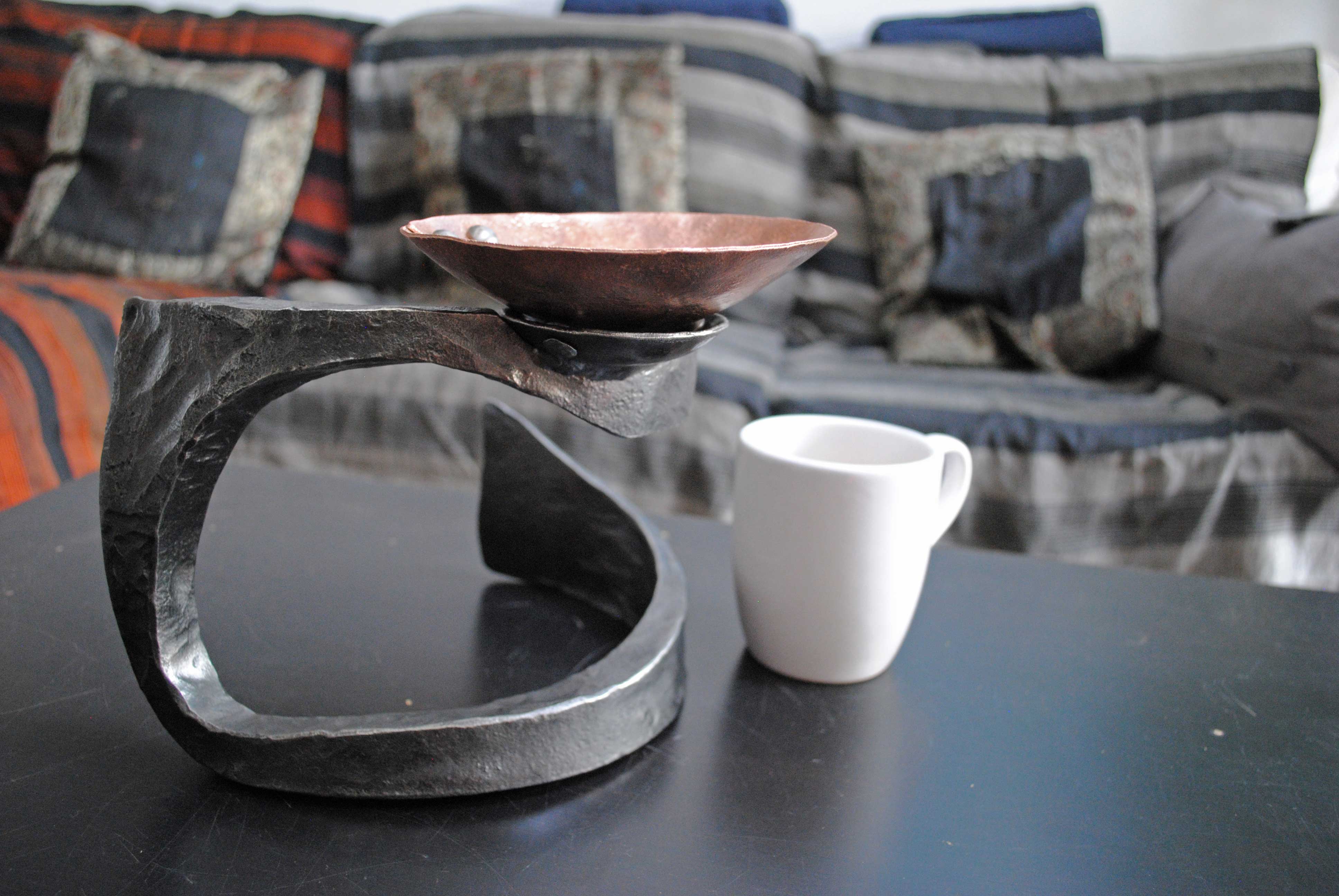

I very recently got a 25kg Anyang power hammer and plan to pursure my sculptural interests more now that my ideas are actually feasible. This is the first proper thing I've made under it using solely V tapered cross pein dies which were most effective at spreading. Forged from 1 piece of 30mm x 20mm flat bar, I deliberately didn't planish the hammer marks. The pictures don't really give a good sense of proportions but hey ho. Finished in a graphite based polish then burnished to highlight.
Completely new to power hammers so looking forward to getting better at using it & making some tooling/dies to go with it.
Oh you ARE having a GOOD time with it aren't you Joel? That came out very nice, proportions are good, graceful except a couple sharp square features for contrast. I like it a lot, I don't know if planishing would've improved it that much. Knock off a couple of the kind of buggery spits with a file or a touch with a hand hammer and it's good to go.

The pics seem to make the edges look more aggressive/sharper than they are in real life. I did my typical thing of softening the corners with a twisted wire wheel on my 4 1/2" grinder so there's no nasties.

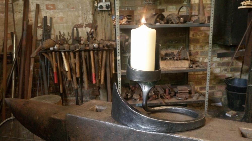

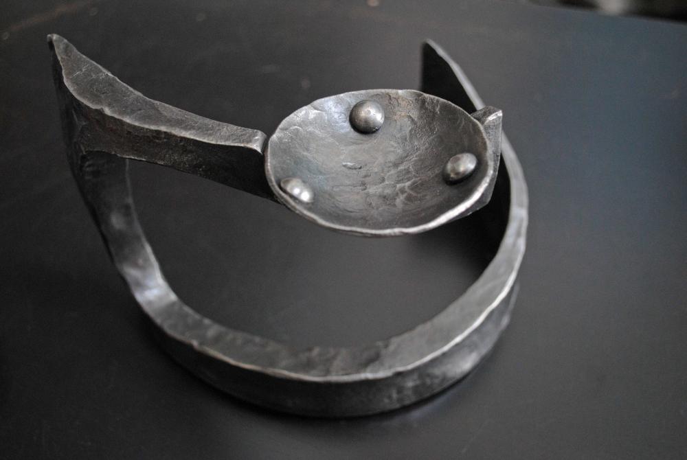

Cheers. Pics of power hammer forging No.2 attached, both of them I just made up as I went along really. Both forged from 20 x 30mm flat, just wanted to test the cross pein dies it came with really.

Finished these with thinned down graphite paste, burnished them up then 2 coats of Renaissance wax but found some small rust spots after a few days?!?!?!?! Haven't been handled with wet hands. Completely baffled. Any ideas?

Good fun Joel you are up and running with the hammer...well done, good work. I can see the fun you had. I recognise the enthusiasm from my first forays!
Re the rust spots. What was the humidity?
Two possible points on timing. How long after burnishing before the graphite paste and Renaissance wax? Damp atmosphere it needs to be instant.
I have never put two coats of Renaissance wax on. The white spirit in the second will dissolve the first so it won't actually add anything. More importantly if you burnish it up immediately after application you are may be likely to wipe  it off perhaps...I put it on thin, leave it to evaporate off the white spirit and then burnish it up.
When I say thin, I mean very thin. I make it up with a lot of white spirit so I can put it on with a paint brush. I would cut Picreator's Renaissance wax with maybe twice the volume of white spirit, maybe more...it will almost pour, sometimes does.
Struggling a bit with the rust spots I have to say...another couple of thoughts how thoroughly did you burnish it? Had you quenched it after forging?

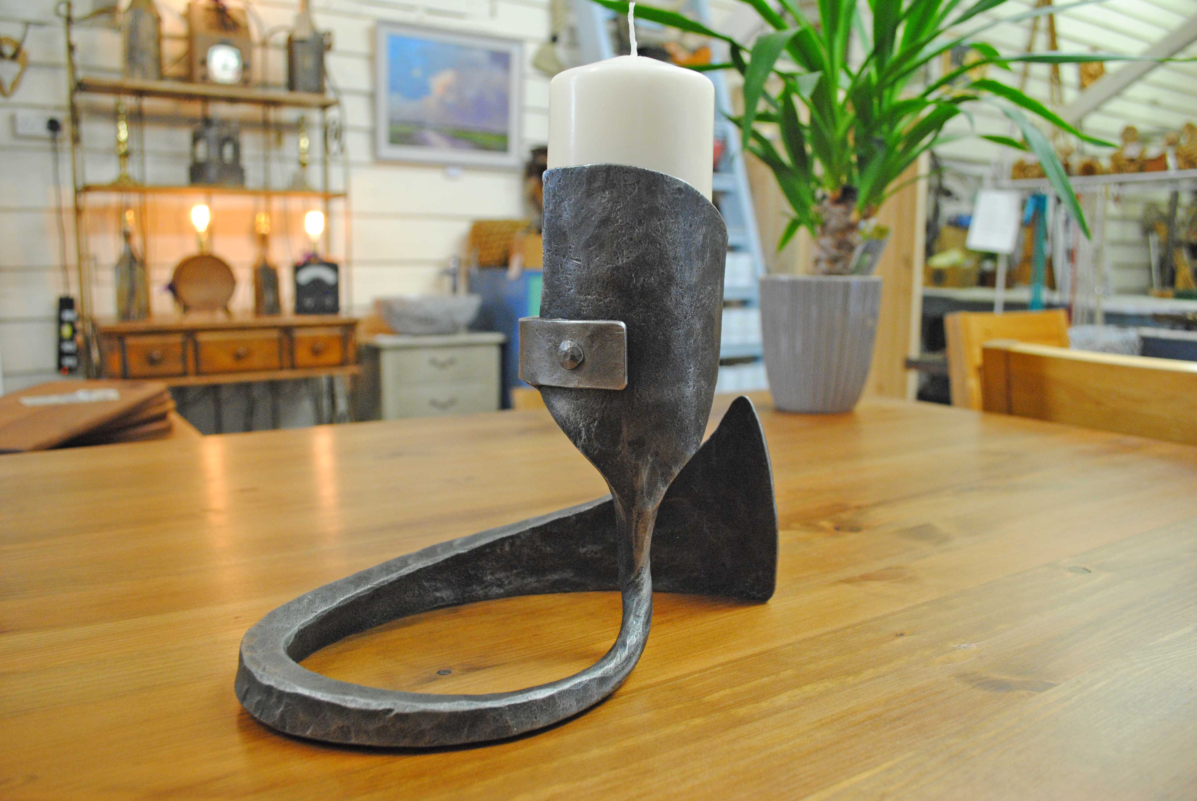

Awesome job Joel.  Do you have any pictures of the candle cup?  Specifically the bottom and back side.   I'm interested in how its wrapped and or put together.
Thanks. No I don't I'm afriad. the back of that tail thing on the candle cup was a flat straight end that didn't taper down any further than what you can see. It finished a small distance further on that the rivet. The bottom of the cup is a disc placed carefully in to line up with the bottom edge of the wrap around bit, then I welded it in position all around the circumferance.

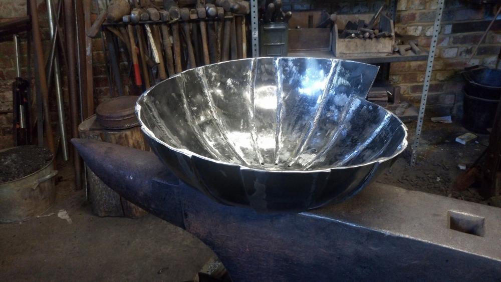

Nope no lubricants. Well I took 3 items to a gallery (including the bowl below) and left them there for a long weekend for them to have a think if they were right for the gallery, things didn't work out so I collected them after about 4 or 5 days, and that's when I noticed some small rust spots developing. All the rust spots were on the bare steel surfaces where there was absolutely no mill or forge scale, (e.g on the lip of the bowl) so I just came away thinking that the wax can't "key" onto the bare steel surfaces so well. I just don't understand it T.B.H and have tried to put it down to freak bad luck because folks like you and Peter have been using it without incident.Fabricated bowl FB.jpg
I went and took some pics today of these items on display in the shop I've taken them to...
Awesome thanks.  It helped me get my head around it.
Looks great from that side too.
