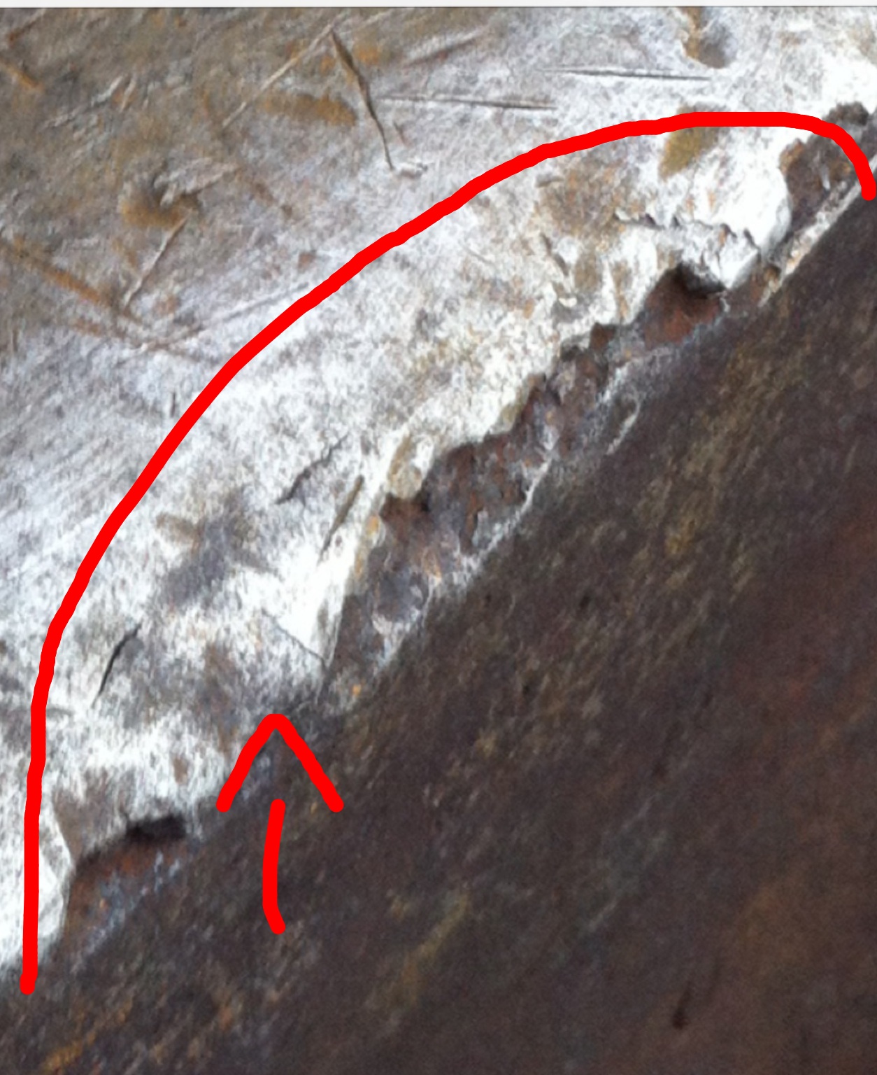

IRTim Posted May 21, 2016 Share Posted May 21, 2016 I'm looking for tips or any type of do's & don't's advice I can get on restoring a Peter Wright anvil. The other day I was playing with my brake drum forge. I live on the corner so people are always driving by. I had a man offer to sell me a anvil. He was a older guy real nice. Told me he bought it at a estate sale 5 years ago but can no longer be around coal so had no use for it. Right now I'm in the middle of replacing my vans head gaskets so I couldn't go see it and knew he likely couldn't text me or email pictures. I asked him everything I could about it and he felt it was in good shape and flat. He then told me all he wanted was to see it be used and only wanted me to pay him what he had in it. Said he knows they're going for a good bit now but he said he paid $85 and only wants the $85 he put in it. So I was all over it like xxxx even though I only had $90 to my name and bought it sight unseen! After 15 hours of electrolysis removing tons of paint grease and rust I can see it's been road hard. It's got marks all over the face and someone has welded it before on the edges poorly. Marks from a stick welder tapping on it. Clearly was used to cut on.. What's the best way I can rebuild it? It's a 137lb (1-0-25) Peter Wright. Has (2) 4's on the front feet. I'm not sure what they mean. I'm not sure how the Peter Wright anvil was faced and don't want to hurt it more than it is. The guy who sold it to me never got to use it. I don't think he knew it was poorly welded. It had to much paint and rust to see it. I also feel he was honest because he showed of with the paper from when he bought it and tried to lower the price to $75. I gave him the $85 and he said he was going to give the other $10 to feed homeless kids. I must of had some good karma coming. Even had a nice big hot cut hardie! How can I bring this back to life? Quote Link to comment Share on other sites More sharing options...

IRTim Posted May 21, 2016 Author Share Posted May 21, 2016 Thanks Glenn, i hope to finish cleaning up the body of it from rust today. I wire wheeled the paint and rust off the hardie and gave it a coat of beeswax mixed with turpentine and linseed oil. Not sure if I'm going to coat the anvil that way or not. If it were in better shape that would be my first choice but since it's a little rough I also thought about using some tractor paint with a hardener I bought to use on my van. If I do paint it I'm guessing I shouldn't coat the horn with it. There are cracks in the weld on the corner and it's fish lipped over the edge with a hollow space that looks like goes back under the face a good ways. I'm not sure it'll stay on long if it starts getting a beating as I use it. Thin and cracked is what worries me. Not supported and just a poor weld adds to it but might beat flat over time removing the hollow space.. If I'm lucky. Here's the part I'm worried about most. I outlined where it's cracking off from not being supported. I think it's all weld steel there and not the real face metal. Quote Link to comment Share on other sites More sharing options...
Glenn Posted May 21, 2016 Share Posted May 21, 2016 DO NOT beat on the cracks in the weld on the corner. There is plenty of other anvil surface that can be used. 12 minutes ago, IRTim said: I wire wheeled the paint and rust off the hardie and gave it a coat of beeswax mixed with turpentine and linseed oil. Not sure if I'm going to coat the anvil that way or not. Sounds like you already did coat the anvil (grin). Like I said use the anvil for a year and then decide what the anvil could not do that you wanted done. There are folks in 3 rd world countries that only have a sledge hammer head for an anvil and get alone quite well. YOU have a wonderful anvil to start with, so learn what you can do with it. Quote Link to comment Share on other sites More sharing options...

Ridgewayforge Posted May 21, 2016 Share Posted May 21, 2016 Nothing wrong with the anvil. Its a tool, and it can hold more tools (hardy hole). Make a block with clean, rounded corners and use that in place of the jagged bit you highlighted. That PW is in fine condition. I work regularly on a 75lb anvil with edges like your PW; don't think that by mashing hot steel against the face you will somehow damagae it- that PW probably saw much heavier stock than you will be working for a while, so treat her nice and she'll treat you nice. And, with nearly all anvils, NO grinding or welding! Just pure and simple forging! Quote Link to comment Share on other sites More sharing options...
