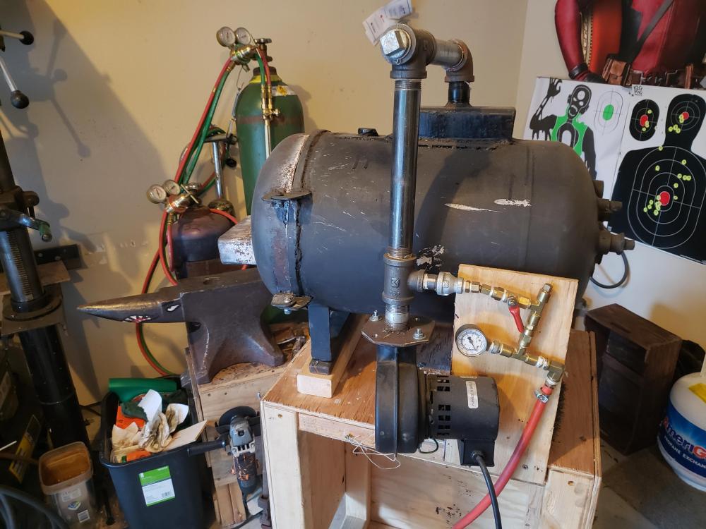

I'm not following how your fuel air supply system works. Would you mind clarifying please?

... and for Frosty,  the fuel / air mixture works by a careful measure.  I have the same high flow gas valve I used with the standard burners.  I keep a pressure  of about 6 psi.  I use a valve to mix the air, which is supplied by an old truck heater fan.  The thing is a little finiky and took a while to get the mixture just right to heat super hot and still supply a steady, even flame.
   It may be later Sat or even Sun to get a pic of it working.  I just noticed that I have a bent tubing right at my connector.  It will have to be replaced before heat... safety first.
Well, yes, that gas/air system is going to be somewhat cranky, because the last gas valve in line is a ball valve; this valve belongs just down stream of the gas cylinder for quick shutdown, in case of fire. Just before the burner's air entrance is a convenient place to put a needle valve for fine tuning, or else no valve at all.
Since your photo shows a pressure gauge on the gas line, I will assume that you have a variable pressure regulator installed somewhere between the gas cylinder and the gauge.
On the air entrance side, the heater fan seams good enough, if you have a speed control for the motor installed too? Otherwise, you will need a valve to help dump excess air from the fan.
You also need to move that acetylene torch set as far away from your forge as possible. Somewhere outside the building in a shady spot is where most fire codes call for the cylinders to be stored.

On a happyer note, I see that you chose to hinge one end of the forge. With the improvementa in insulating brick, ceramic board, and other stiff materials, this build choice is only going to become more important. Would you like to talk about the steps you took, for all of us inquisitive listeners?
All those fittings is what had me wondering about you having something special going on.
Your propane regulator should have a plug on the outlet side for a gage which lets you lose all those fittings near your forge. A needle valve in the gas circuit at the point it injects into the air flow is a nice addition though not necessary. I have a 1/4 turn ball valve right after the gage as the working gas valve, it's a handy place in case something goes wrong and you want to shut it off quickly from a distance.
Putting the gage at the regulator lets you adjust pressure and watch it at the same time plus it allows the system to depressurize when you shut it off. Your gas injector is so far from the heat there's no reason to use anything but rubber propane hose, unlike mine.
Your system will clean up beautifully and not lose one bit of performance. It's common for folks figuring this stuff out for themselves to have lots and lots of fittings where one will do, I never took pic of my early forges but I still have a cigar box half full of fittings from those days.
