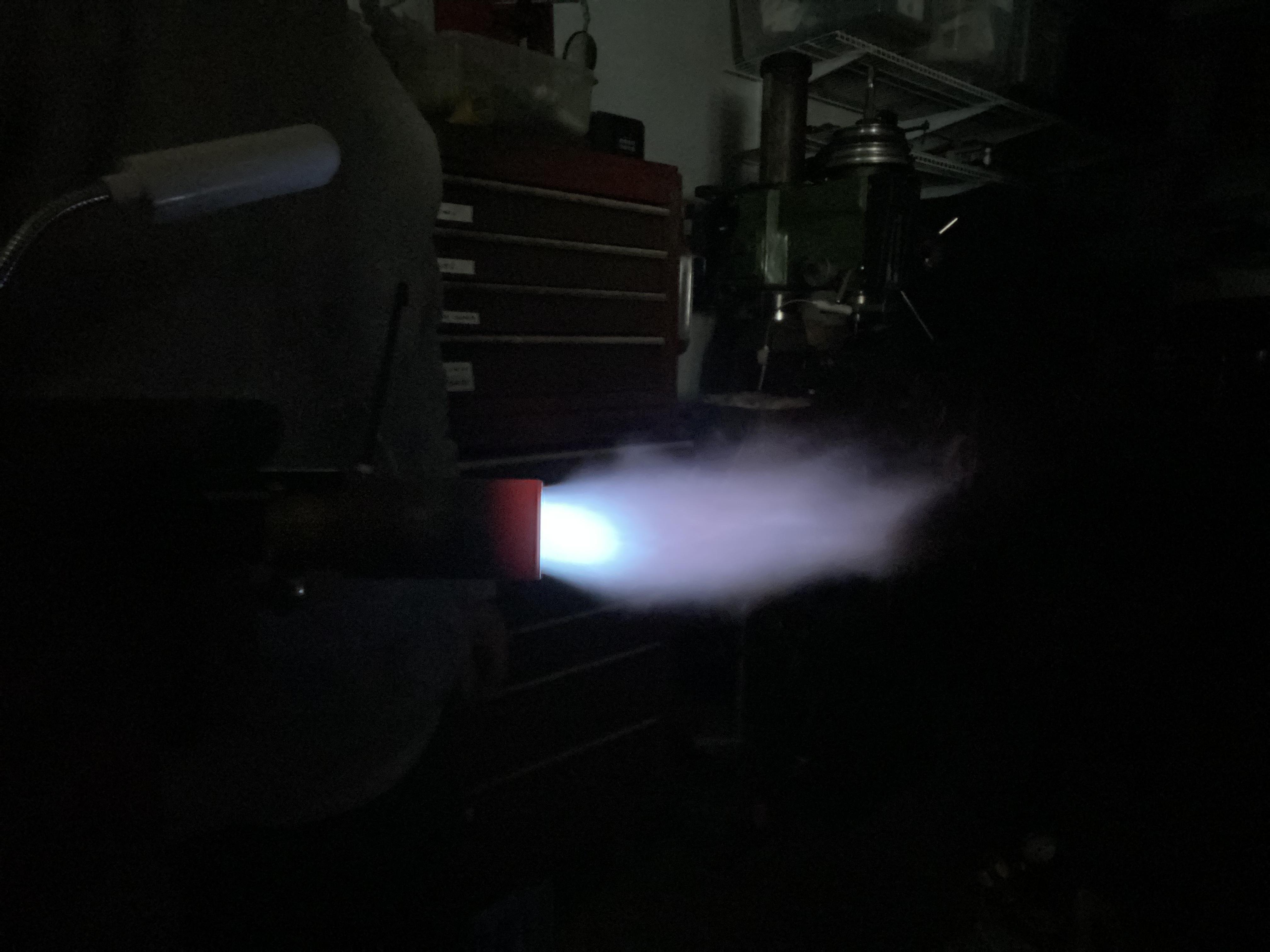

By the way, Greg; you do have a regulator and needle valve on that burner's gas line, right?
There is an appropriate regulator and ball valve.  No needle valve.
Sequence:  1.5 inch overhang with .060 movements to lengthen the overhang.
FD031FD6-327D-440E-9969-3BD3B1892BCB.thumb.jpeg.a59fe0459ca9910e96b76019b7a97105.jpeg0EBCAC31-3770-4250-90CA-C87C7823D053.thumb.jpeg.d49d7c5a06eee4bb7331be4bfeb7f1c6.jpegCA4EBD03-6BCB-420A-9B3B-40F72069FD18.thumb.jpeg.a009807679573108a97066515bad0750.jpegEED6E4A8-D917-443F-AC36-AFD9D4ECF60F.thumb.jpeg.d4394e29ddae1ce68ba5e24e83cbab9f.jpegB56DC4C7-136E-4F42-8176-AA53CA9FED8C.thumb.jpeg.b694309bad9e9dde549dd4659d79dc53.jpeg7BFD087C-3A54-4300-92E0-3FF663B16A03.thumb.jpeg.c1f8970f1fdda983c1135541d98336a6.jpegC6E87879-A6B6-4A65-A25D-5CDE1060B5B8.thumb.jpeg.6924a1a85d59ba975d282026f0444198.jpegB2123A72-67BC-4AF2-95AF-645F82C90A2F.thumb.jpeg.c90d3c7b454210e2779f9f79a19ecad8.jpeg
Uh-oh; If you have a ball valve near the burner end of your gas line, please take it off! Ball valves make excellent shutoff valves, but they can create havoc when placed next to a burner. you are much better off with only the regulator, than with a ball valve and regulator :P
On the other hand, that ball valve is an excellent quick shutoff device, when placed next to the gas cylinder; which place is it?
The flame is best at 1.5 inches of overhang, which is reassuring :rolleyes:

On 3/17/2023 at 6:46 PM, Greg in Maryland said:
The ball valve is at the burner end of the line.  I will take it out to see what happens.
What happened? Inquiring minds are dying to know ;)
As to needle valves; they are just a luxury item, since the same job can be handled with the regulator. I like to use a needle valve at the burner, so that I can fine tune without turning away from the action :rolleyes:
So, since they came up as a potential problem, why did I point out that ball valves placed between the end of the gas hose, and the burner's gas tube can create trouble? Only because they have come up as creating problems a couple of times in the past, when placed that way.
However, it should be noted that their burner hoses didn't have a variable pressure regulator between the gas cylinder and the burner. But your gas hose does. The difference is that cylinder pressure can hit 150 PSI, so the ball valve can be trying to control a flow from 0-150. With the regulator mounted, that flow drops down to 0-30 PSI. So, the problems should greatly decrease.
But, your problems are minor; not major, so the ball valve still looks likely to be the culprit.

On 3/16/2023 at 1:07 PM, Mikey98118 said:
I would be having fun, if this were my own burner, but more care must be taken with other people's toys :rolleyes:
I got curious and put the burner in the forge (.023 tip).  It seemed to be burn well with very little flame leaving the forge.   All your help paid off.  You could really see the adjustability of the choke to flame performance.
Observation:  it took an hour to get to 2000 degrees F @ 30psi.  The forge would get to 2200 in 30 minutes with the .035 tip but would be spitting flame out of the door.
Question:  Would the burner increase heat output if the air openings were widened and a larger tip (.025 or 030) installed?
A 0.035 orifice delivers more than 2x what a 0.023 does per given pressure. So, sure if it's tuned to a neutral burn the 0.035 will be making more than 2x the heat.
30 psi through a 0.023 jet? Sounds to me like it's blowing heat right through the forge whether there is dragon's breath or not.
I never run higher than 12psi except through the NARB but it'll weld at 12-15psi easily and I only turn it up that high to keep the burner block cool so it doesn't burn back.
I agree With Frosty, that 30 PSI to reach full temperature in a forge is just too much pressure. When designing burners, I wasn't satisfied with anything less than proper performance at 50 PSI; this was a safety issue, only. If your forge and burner won't reach welding heat with a 0-20 PSI regulator, it is time to rethink, the forge, its burner(s) or both.
I am willing to go right on to rethinking your forge, if that is what you desire. First, I would like you to ask yourself if you are actually satisfied with your burner's performance, or if you're just tired of the hassle, and feeling impatient "to get on with the job." Either way is fine with me, because either way can be revisited later...should you have regrets. This is the beauty of building your own tools; control :)

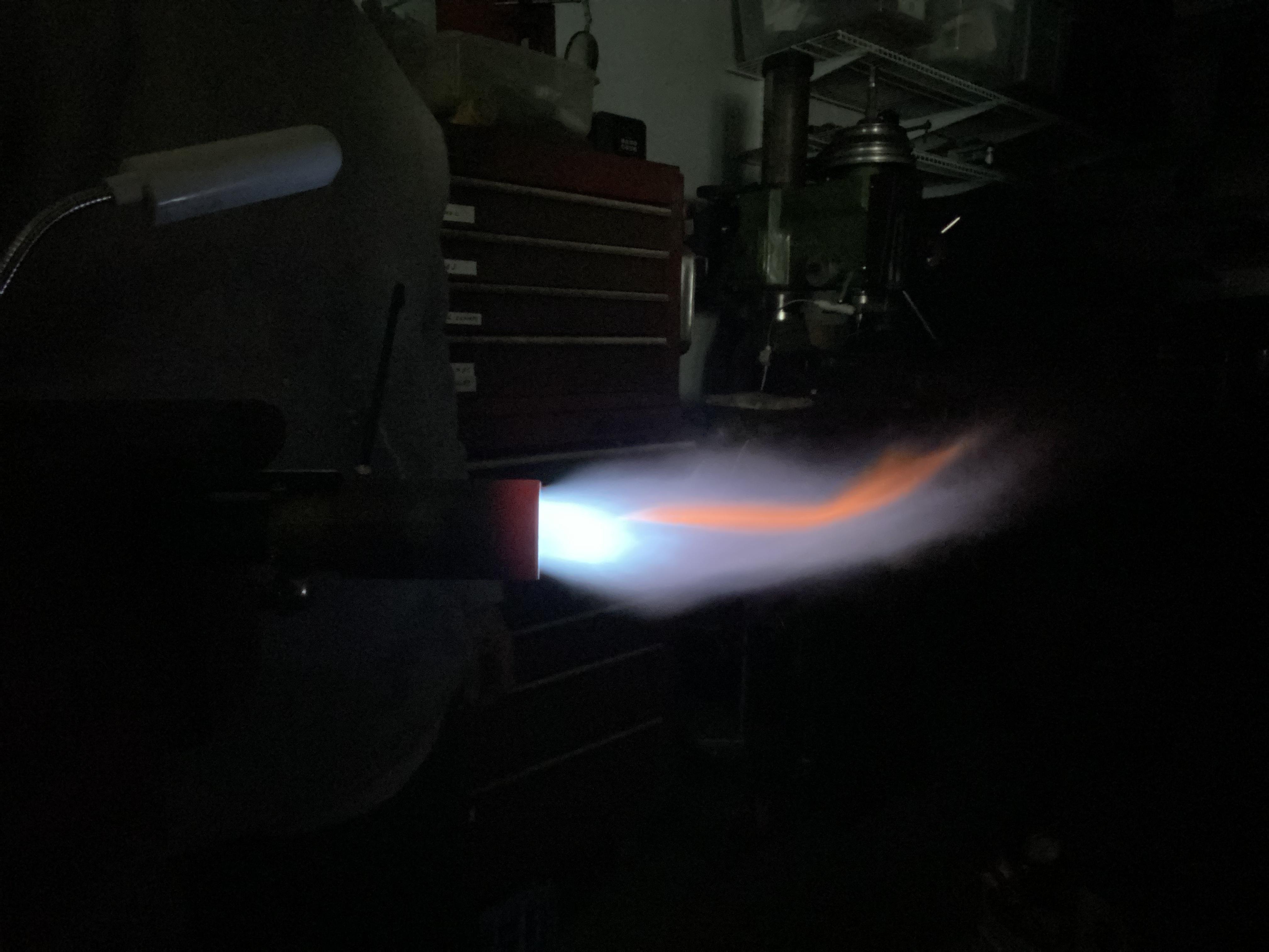

I always found 0.023" MIG tips to be a little too small in a 3/4" burner and, (at least in Mikey burners) 0.030" tips a little too large. Thus, when  0.023" MIG tips became available it was a joy.
That should have read "Thus, when  0.025" MIG tips became available it was a joy."
However, you have a modified Hybrid burner; it might handle an  0.030" MIG tip, okay.

21 hours ago, Frosty said:
Thank you for the feedback.  I put the .030 tip in and got to welding heat with 12-15 psi.  I lost track of time but guess it took about 45 minutes.  I think the burner will do better with more air (widening the air slots).
Mike - appreciate the continued help.  I know the final solution is a newly designed forge and burners.  However I am going to play with the hybrid burner for a little while longer.  I am going to widen the air slots to accommodate the .030 tip.  What’s the worst that can happen :wacko:
So long as you leave enough width in the ribs between the burner's air lots, nothing major will go wrong. One thing that happens as burner slots widen is that the burner may not run as smoothly as before; its similar to mounting an over size engine in a small car; hot-rods are not family sedans. However, once mounted in your forge, even a hot-rod will smooth out. Back-pressure isn't always a bad thing.
So, why bring this up at all? When used as burners, there is no good reason to. However, when used as hand torches, for brazing work, a smooth flame becomes important. As we write back and forth, I try to remember all those other readers, who may have different agendas :rolleyes:
The burner has 4 air slots that are 5/8 wide.  The ribs are approximately 9/16 wide.
I induced a light steam of air into the air slot while running the burner and it clearly reduced the unburnt fuel leaving the forge.  The temperature was holding steady before inducing the air.  The additional air started raising the temperature.
How wide would you make the air slots for a first pass.  Also - would it be ok to widen only one instead of all 4? It would be more convenient to machine only 1.
If the ribs are 9/16" wide, they can be thinned down to 3/8" without becoming weak; this will give you a collective air intake increase of 1/2" total. This would be the safe and sane move. I would recommend that you start with this, to see if the results are satisfactory.
If, they are not...or if you just get greedy, a further (mad scientist) move, would be to supplement this increase, by grinding the openings  longitudinal edges int bevels, and grinding the outside of each opening's other side, for for say 1-1/4" of their forward areas. So incoming air slides past a knife edge at its outer face, and its inner face slides past a knife edge too. Why only 1-1/4" their forward areas? Inducted air amounts will reduce on a gradient, from the most near the air opening's forward ends, down to the least at their rearward ends. So, past the forward most parts, you lose more rib strength than the increased air intake justifies.
