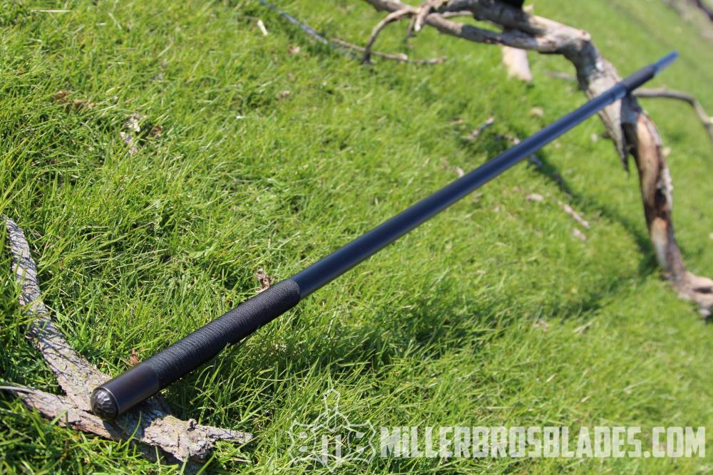

Hi there! This is my first post and I'm Looking to make a custom Yari spear.
Although it's a pretty simple concept, I do not like the looks of mass produced spears online. And FULL custom spears from oustanding guys like Miller Bros Blades is really (really- really) expensive ...Therefore why not make a custom one. Goal: A really durable tactical fighting spear.
my concept:
***5ft ' 3in carbon fiber pole
Diameter: 1 1/2" -filled with a wood pole thats 1.25'' in diameter
I like carbon fiber and think it's a good material for practicing your forms while still being light and strong enough to hold its own against wood. Ofcourse not many recommend it since wood is proven true to be the best material (and theres a reason we still use wood bo staffs today folks). Good wood gives you Weight, sturdiness, flexibility in a staff.
However, recently I got inspired by a thread i read at a different site about filling a carbon fiber pole (air tight) with a wood of some kind (like ash, wax, hickory,..etc.).
Blade : Custom 9" z wear pm steel / double edge blade. Pretty tough steel.
Overall Length: 6ft (I'm 5'11)
Other custom ideas like a "Reinforced Steel end cap" and "steel braces" on each end will be worked on as the setup gos.
What are y'all thoughts on this? Might turn out just as cool as it will be fun. Also could use some tips on how the blade can be secured in the tubing without looking Tarzan made lol.
P.s. I'll attach images of what i want the spear to look very similar too. Its a full custom spear made by Miller Bros Blades.
(The spear tubing from the photos attached are also carbon fiber but hollow.)

So no problems with repeated impacts causing fibers to protrude and getting jammed in your hands as you run them up and down the shaft?  Good!
Though none of what you posted addressed that...Most baseball bats seem to have something else covering the grip area; use of a spear will involving running your hands over most of the shaft.  A key point of quality is: "do your metrics address what's actually important?"
Thanks again. You're very right. I was so focused on making sure the staff doesn't break I didn't consider the idea of the outer-splinting.. This all new to me and my very first project. (:
I wonder if a different piping should be considered.. Or obviously a better understanding of carbon fiber lol
I am not aware of the characteristics of the stuff you are looking at---I just know from experience some issues seen with other types of spear shafts.  For all I know you could use shrinkwrap tubing over the outside and avoid the issue; but I don't know the uselife in that use or weight issues (or cost issues), etc

Carbon fiber composites tend to have poor damage tolerance, particularly due to impact.
The below article discusses the findings from a workshop with respect to the damage tolerance of carbon fiber reinforced composites in 1986 (i.e.,after the carbon fiber reinforced composite components in 4th gen. tactical aircraft were designed). I have included a relevant quote.
http://www.sciencedirect.com/science/article/pii/0263822386900255
" The main conclusions to be drawn from the workshop are: (1) damage from impact is the worst type of damage for these materials—significant reductions in the compressive strength will occur following impact; "
Please also consider the application of carbon fiber in road bicycles. If they didn't tend to fail so catastrophically (and somewhat unpredictably) after relatively minor wrecks, many more cyclists would use them (My cycling nut best friend included).

While this is an interesting discussion I don't think the OP stuck around after finding out we don't think it's a very workable idea. If carbon fiber were good for taking point impacts they'd be making body armor from it and not just using it as the frame and backer to carry loads and disperse energy.
It flexes wonderfully well, see an arrow video or a bow or such but don't bend it over a sharp edge or subject it to high localized forces. All the materials in the composite are very strong but they all react differently to stresses. In some cases this makes the whole stronger like pre-stressing rebar in concrete structures. The problem is carbon fiber is a whole different kind of strong than epoxy. A steep differential in movement causes shearing and one breaks the other in failure.
