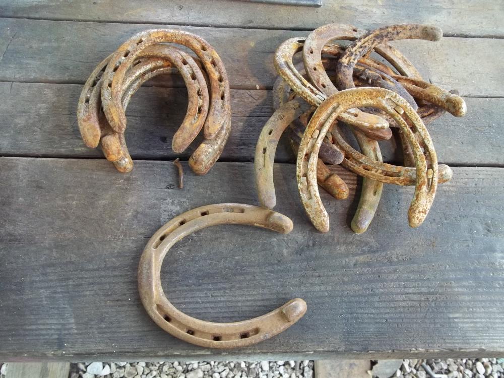

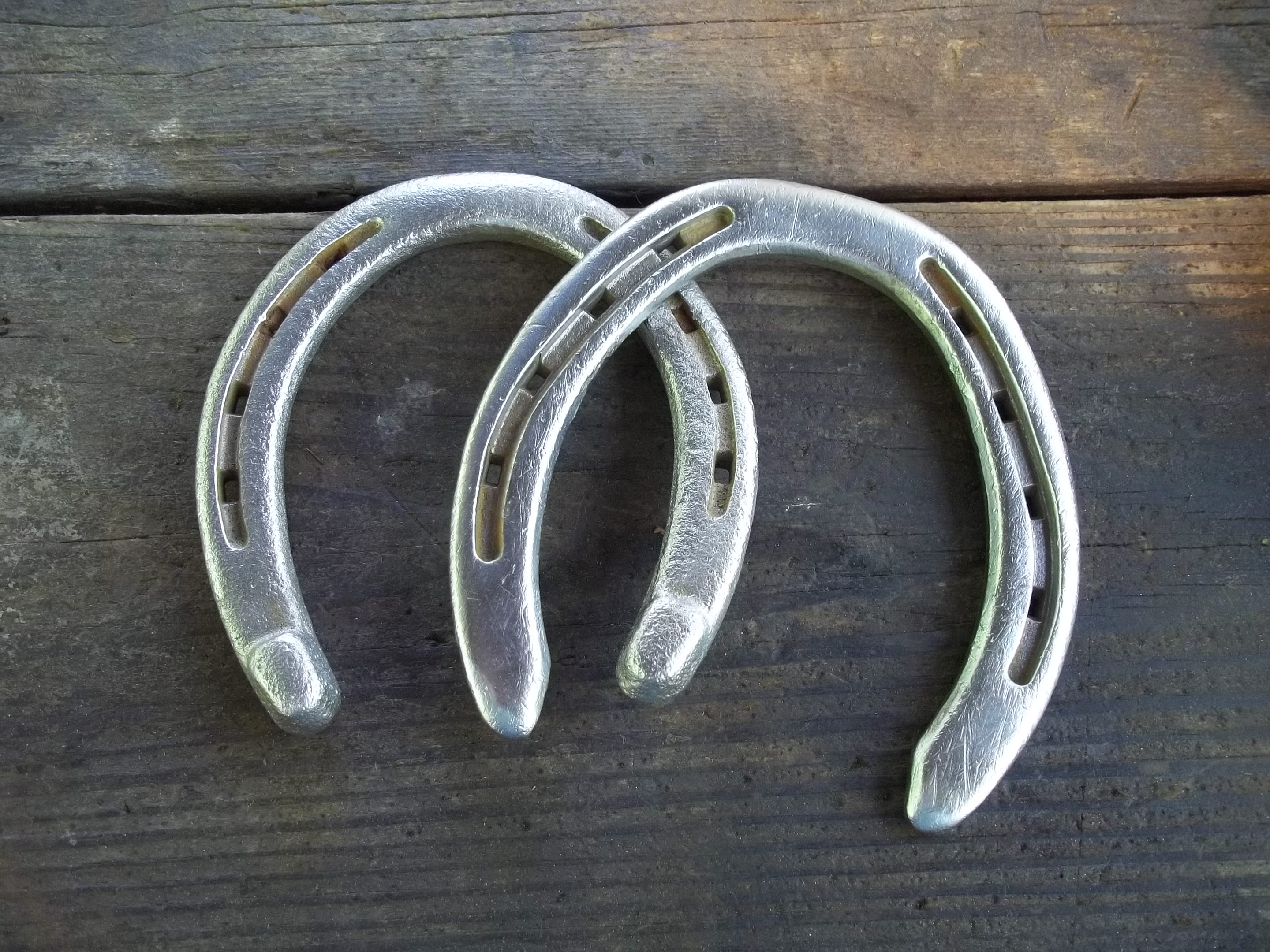

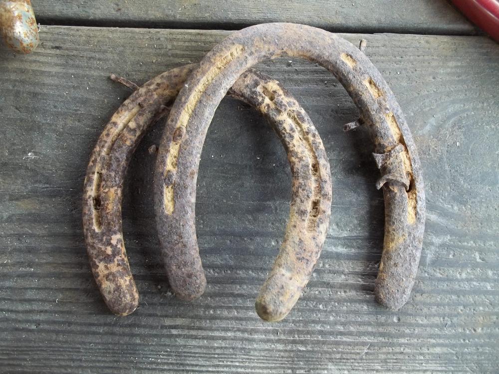

arkie Posted April 23, 2016 Share Posted April 23, 2016 There have been several discussions on the merits (or demerits) of simply using vinegar to remove rust from steel. I finally got around to shooting some before and after photos of VERY rusty horseshoes that I needed to de-rust to show how effective, simple and easy it is. I do this all the time; cleaned up 13 horseshoes this go-round. These had been laying around in the wet dirt for who-knows how long. I wire brushed the loose stuff off with my anvil wire brush, removed any nails then covered them with regular white vinegar in a plastic bucket. They soaked for a couple of days then I neutralized them with a weak baking soda solution, rinsed with water and dried. I buffed the shoes with the wire wheel on a bench grinder and they shine like a new silver dollar (wish those were still silver...). Quote Link to comment Share on other sites More sharing options...

SpankySmith Posted April 28, 2016 Share Posted April 28, 2016 Speaking of citrus....citric acid also works to remove scale. It's commonly sold here amongst the canning supplies, comes in powder form. I have mixed it with warm water and left items to soak overnight in it, did a great job. Pull from the bath, scrub off the scale lightly with a scouring pad, done. I've used it when I was out of my go-to vinegar. Quote Link to comment Share on other sites More sharing options...
