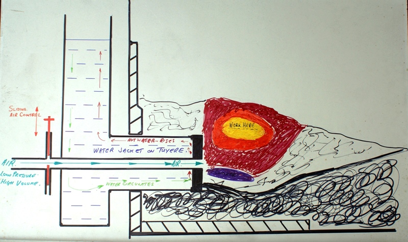

Charles R. Stevens Posted April 21, 2016 Share Posted April 21, 2016 I used clay because it was under my feet, clay and coal are not a good mix as the clay vitrifies and slag sticks to it. Traditinal side blast forges are filled with fly ash and cinders (clinker) clay coverd by a thin layer of ash works well, as dose sand and ash. This isn't rocket science, we are talking about a hole in the ground to contain a fire, everything else is an improvement on that. One of the other members put up this illustration, Glenn mistakenly posted the bottom blast. Don't worry about a water cooler tuyere at this stage of the game. Now, what Glenn said about fuel is true for coal, for charcoal excess fuel is just wasted, charcoal being less dense will happily burn with out air wile coal will slowly extinguish (most of the time) Quote Link to comment Share on other sites More sharing options...

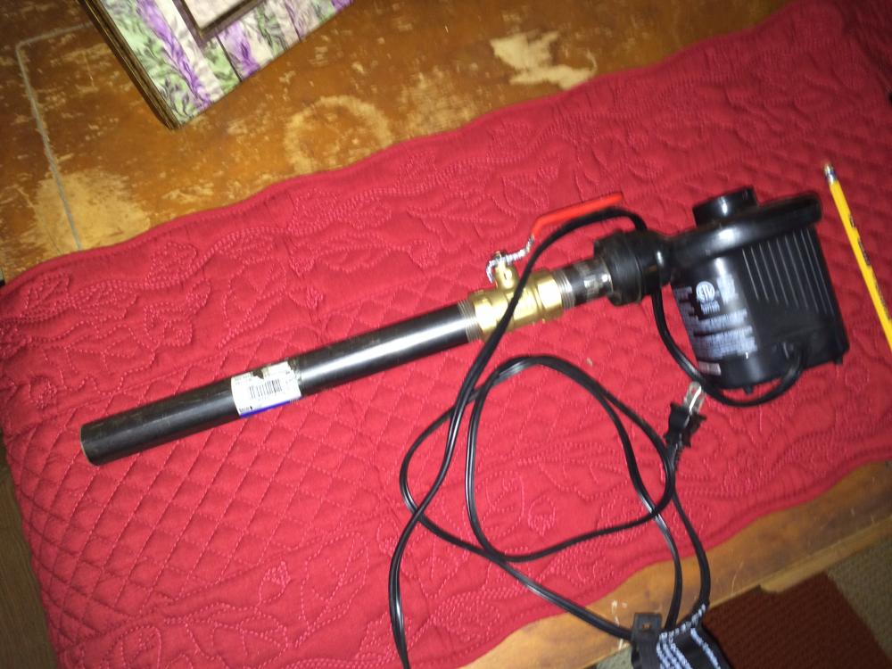

Charles R. Stevens Posted April 22, 2016 Share Posted April 22, 2016 Try your local tractor supply. Las to blower a cheep air matrice inflator will hook up to a peice of 3/4" with a bit of finagling Works ok as is but I now think a "T" to vent the exes is better as I don't like the noise, grates on my nerves Quote Link to comment Share on other sites More sharing options...
Steve Meyer Posted April 22, 2016 Author Share Posted April 22, 2016 That's a great idea, especially as I happen to have a cheap air mattress inflator. I was just thinking I'd hook a rheostat up to my blow dryer and turn down the power to control air flow. Yes I was going to call tractor supply today there is one 30 minutes away in Vernon. Quote Link to comment Share on other sites More sharing options...

Thats Hot... Posted April 22, 2016 Share Posted April 22, 2016 I can see in the pict. Glenn posted, that I have been using my fire wrong from day one, I will have to change the way I have been working the forge (fire) I have been keeping my coal even with the top of the rotor, and my metal going down to the bottom of the drum. Quote Link to comment Share on other sites More sharing options...
ThomasPowers Posted April 22, 2016 Share Posted April 22, 2016 I teach my students that generally you would like the metal to be close to horizontal in the fire to keep it in the same general part of the fire: oxidizing, neutral, reducing; and try to stay away from the oxidizing part down near the tuyere! Quote Link to comment Share on other sites More sharing options...
Thats Hot... Posted April 22, 2016 Share Posted April 22, 2016 I will start doing this with my next fire.. Quote Link to comment Share on other sites More sharing options...
